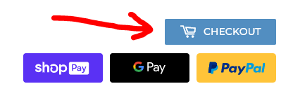

Not if paying with Paypal ![]()
There is - you have to go to CheckOut first, not the PayPal button, then use PayPal as the payment method later.
Never mind, it’s done now, this is why I would rather shop face to face and pay cash.
