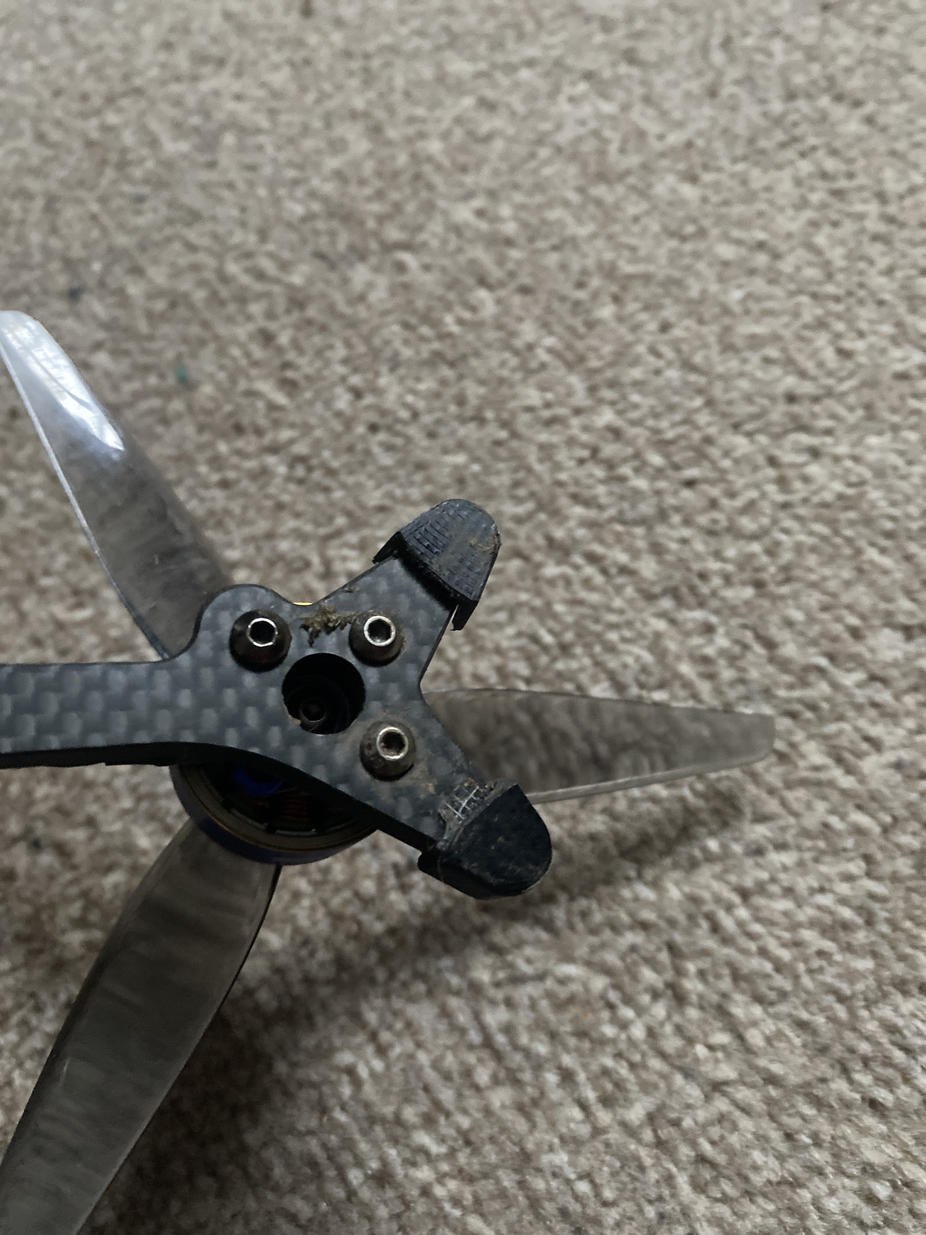

Can I ask you guys thoughts on something? Being quite new to fpv I spend half my ‘flights’ crashed into the ground so I want to 3d print some parts to minimise any damage. At first I made these to keep the drone away from the ground but at 9 grams each and on the corners it seemed a bit heavy.
So then I just made these small bits to cover the corners and stuck them with double sided tape, bit reluctant to glue them yet.
And I thought about printing some landing feet that sandwich between the two centre plate things using the holes for extra security but I haven’t seen that done and I thought there might be a reason behind that?
I also want to be careful of water damage because I have been flying in a field and the ground is quite damp. I put some tape between the standoffs to protect the stack from the bits of wet grass that like to be sprayed around. If I were to tape round the front and the back do you think it might overheat the electrics?
