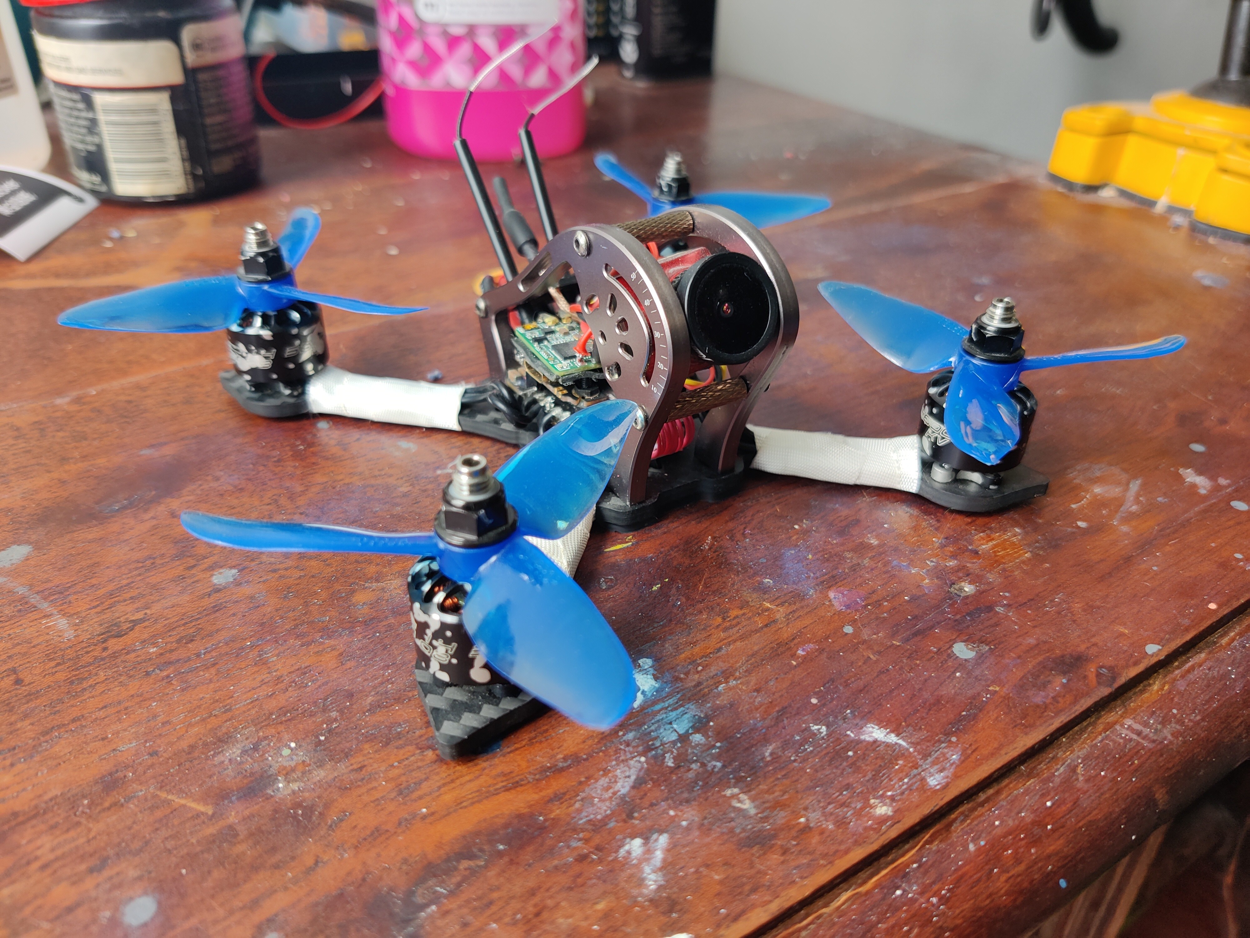

I’m considering selling my 3", built it and have only flown a couple of packs on it. Don’t have a regular spotter, and the thing is hard to fly VLOS given it’s size.
Thing is I got a fair few of the parts second hand, and I know it’s not the latest and greatest, so no clue how to price it. Since we’re all trustworthy on this forum (:wink:), I thought I’d ask here what I might expect to get before listing it in B/S/T. Specs are:
  • GEP-MX3 Sparrow (without LED’s)
  • Mamba F405 v2 (older version with micro USB) + F25 ESC flightstack.
  • FRSky XM+ (I think) receiver
  • TBS Unify Pro Nano VTX
  • iFlight xing 1408 3600 kv
  • Runcam Micro Eagle
All worked fine last I tested but can’t say I’ve ever really put it though it’s paces.
Fly it, shoot a video, add video to sale thread. if it flies, then you have one up on people who don’t bother.
As for how to price it to sell. Add the cost of the parts and divide by two is the quick and dirty approach. But I haven’t sold any of mine, nor ever would. Much too fun to fly.

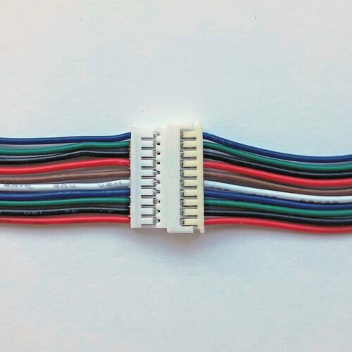

This is a good set for making cables to attach to flight controllers, ESCs, etc SH1.0 is a common standard on quads.
https://www.amazon.co.uk/dp/B07PDQKHJ2
For cabling needing inline plugs/sockets I usually use this sort of thing. I keep plugs and sockets with several different numbers of pins in stock at any one time. I shop around for the best deal. Some devices (eg GPS) have sockets of this size on them as well, so it’s a good choice.
I think UnmannedTech has a load as well.
Note that in each of the above to remove a wire, lift the tabs (carefully) with a craft knife and pull the cable out.
