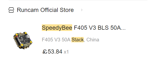

This stack looks very tempting. I know you get what you pay for, but it all comes from China? It has a 9v 3a bec too for digital
£48.40 for a 60A ESC…
I got the following for £5 more… OK only 50A ESC, but still. That is a 405 too, so better than the 411… Still I think I grabbed a bargain (and touch wood been fine)… Though I connect the vistas to VBAT personally

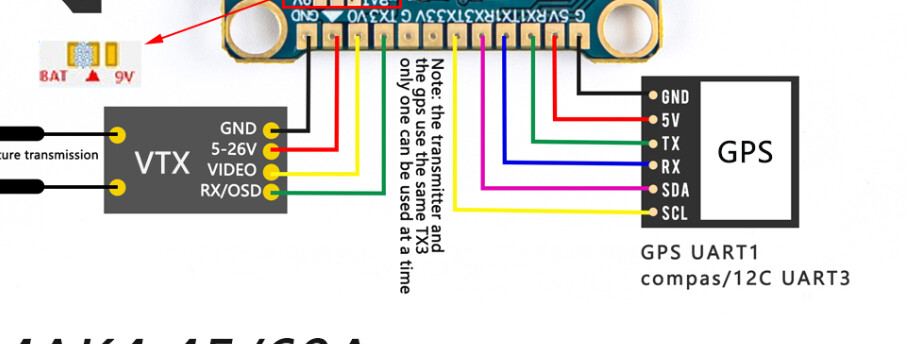

Duplex?
Well it’s an F405 has more UARTS than 3, so not available. I think it means RX and Compass (SDL/SCL on TX3 if you wanna use it). looks like GPS on UART1 there, the TX on 3.

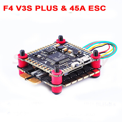

I’ll be honest. Looking for someone to buy it and try it out before I buy it
Haha not me. Is cheap, and for 3 RX’s… VTX (MSP), RX, and GPS, 3’s enough isn’t it… Not too shabby price… found any “real world” reviews?
Glad I got my speedybee for such a good price tbh!
I am after an fc. But i can wait. And two nice esc’s. Hence the searches i have been conducting. For my plane

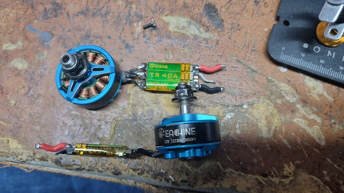

Can anyone tell me why I should not use one of these motors or ESCs on my new atomrc dolphin?
The spec of the parts in the pnp dolphin is 30A esc. 2306 2000KV motors…
These are just second hand from an old eachine wizard.
They do the start up tones and the motor bells look straight…
KV is a bit high, but if 4S and a 6" prop you should be good.
Or 3S could be good,
If you let me have the parts I’ll stick them on my thrust gauge and work out the best prop and battery for maximum thrust
That would be the plan…
Going to use 6" bi-blades or 5" tri-blades and the 21700 4S packs I have.
This one is all about reusing the mass of spare bits I have…
I’m more concerned about whether it would be bad to use these old parts.
I think it would be good to get some life out of them.
Old parts that work are good parts. At least you know they work.
