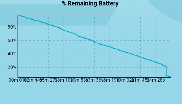

Quick and dirty test of the Coolshow extended flight battery for the mini 3 pro. Entirely in sport mode
For just over sixty quid I’m quite impressed by that 27 minute fight time.
I’m a little concerned about that sudden drop at 20%, I’m hoping that will settle after a couple of charge cycles.
Have any other members got this battery (or one of it’s clones) and does anyone know how it stacks up against the official DJI product?

Going to give it a few runs out consciously aware of that fall off and make sure I’ve got an escape plan should I need to bring it in short.
See what happens.

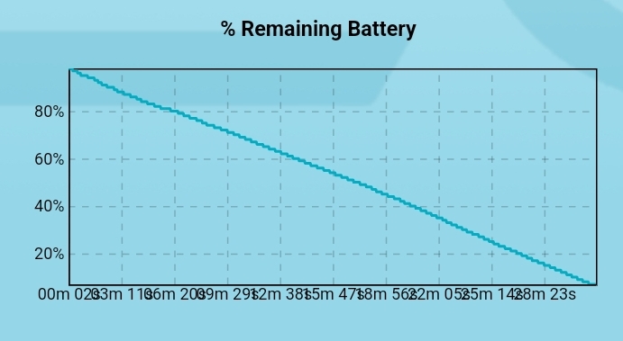

Test Hop two.
No voltage crash at 20% auto RTH engaged at 20% and overridden. Had about 60 seconds to 10% and aircraft on the ground at 7%
I think that charge cycle may have cured that issue
