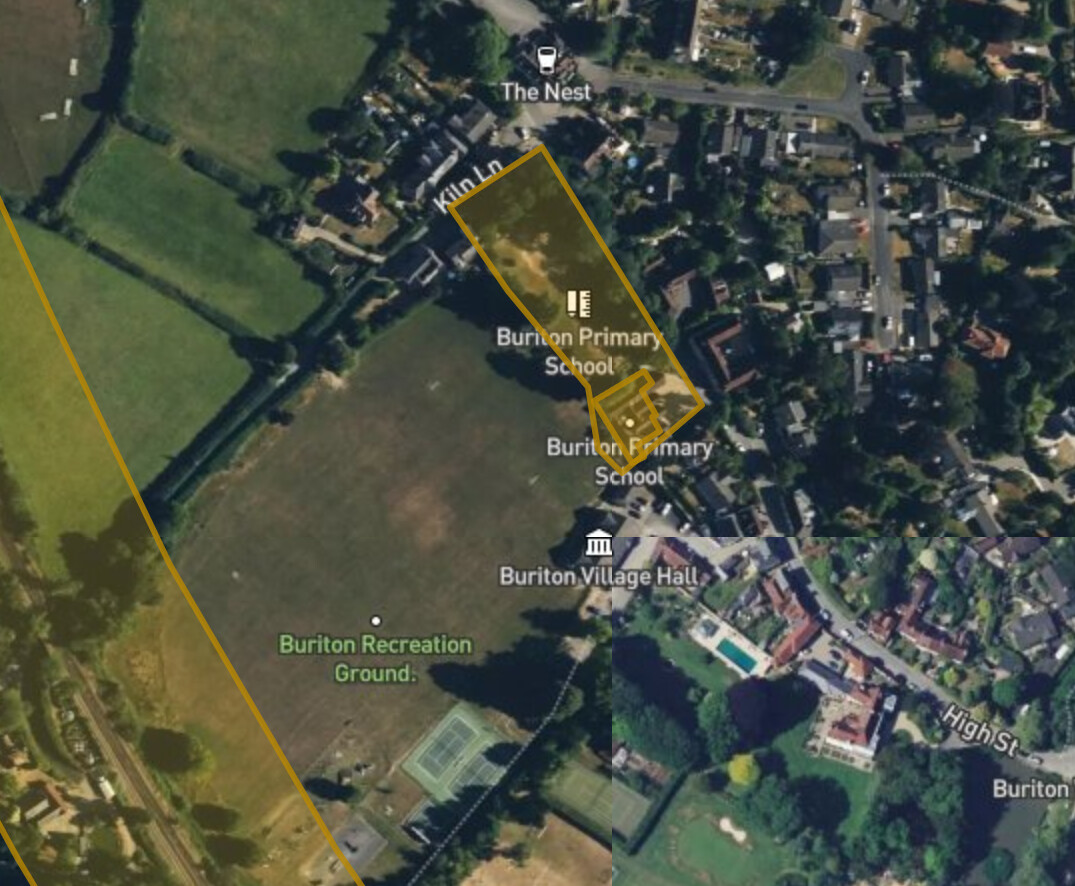

OK - Let me introduce you all to Buriton Rec - a seemingly perfectly charming wide open recreation field in a charming little picturesque village in the Hampshire hills that looks like it might be a lovely place to fly, nestling as it does, in the shadow of QECP and the Halls Hills site just up the road…
There is already a map pin at the other end of the village down by the church and lake, so in some ways Buriton is already covered, but I suspect the main rec ground deserves another one because it seems so obviously the place to fly in that village, and in theory it is ! In fact the local model RC club use it for flying their planes.
But I am very hesitant to just add it to the map without telling you all about what I can only describe as the ‘Curse of Buriton’ !!! :skull_and_crossbones: :broken_heart: :raised_hand:
I have flown from this site 3 times, with 3 different machines (2 of them Naza-M based) and on each of those occasions after a few flights of normal behaviour my DJI machines have all inexplicably ‘gone nuts’ in this field, and done all sort of crazy flyaway-type behaviour that has caused 2 big crashes, and that leads me to think there is something seriously environmentally wrong here, and if I am right about that, then we maybe should pin it as a DONT fly here warning !! My old Yuneec Typhoon H is the only UAV that has survived a flight session here, and having lost 2 whole craft to this field (apparently no pilot error involved both times) I wonder whether I should try one with the M4P and see if DJIs resistance to environmental factors can avoid the same fate ! I suspect not - the views here are at best ‘OK’ and a way short of spectacular !
I don’t know what the hazard could possibly be - there is a railway track running all the way along the back of it, but that has not been problematic in other places. There doesn’t seem to be any big metal structures around, and only a playground and some tennis courts in the field. My crashes here have been uniquely weird and inexplicable (and before the days of logs alas) so…
What do we think - add it, or not ?!

Kiln Lane? I wonder if it’s magnetic interference from something left behind from the lime works (or the several industrial purposes that came after)?
I might need to go and find out, some time this week.
Ooh - can I come and watch ?! (ghoulish smile). I am very local to there, so any time you like works for me ! :slight_smile:

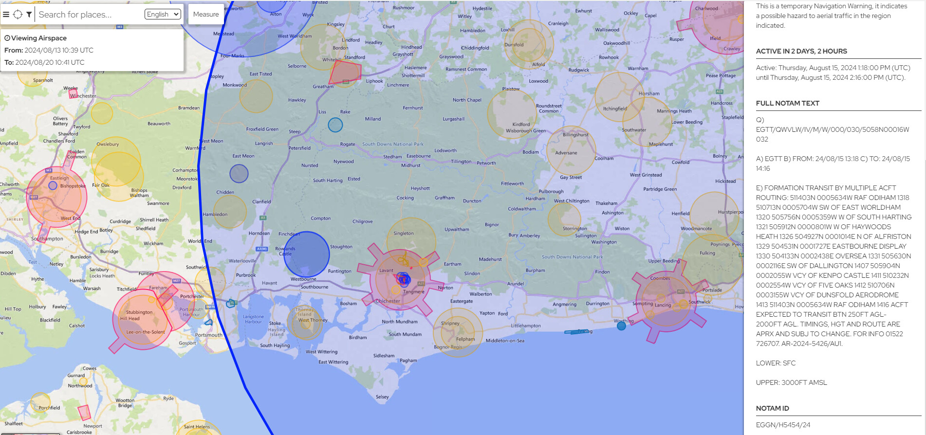

Good lord, that’s a massive NOTAM coverage area !! Virtually ALL of the South East from Hastings to Portsmouth !!
Forgive my ignorance, but is there any way to tell in advance whether this zone will become merely a yellow warning area or a proper red FRZ when it becomes active (without calling the NOTAM number) ?
It’s related to Eastbourne Air Show.
The NOTAM is a “Notice” to Airmen … not a “You just can’t fly here!” … otherwise Gatwick … AND Heathrow … would have problems. :laughing:
