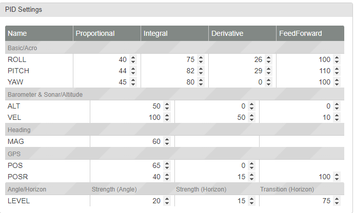

So i have got my 1st advisorys from Manus and Gemini. I think i will try Gemini tune 1st and see how it goes.
I
mage is of Inav default and text is from each AI.
Gemini
PID Tune Recommendations - 23/08/2025
— Pitch Axis Adjustments —
Lowered P and D to reduce oscillations
set p_pitch = 46
set d_pitch = 39
— Roll Axis Adjustments —
Increased P for a more ‘locked in’ feel
set p_roll = 52
— Save Settings —
Type ‘save’ and press Enter after pasting the commands above.
Manus
# Current PID Settings (from your screenshot):
# ROLL: P=40, I=75, D=26, F=100
# PITCH: P=44, I=82, D=29, F=110
# YAW: P=45, I=80, D=0, F=100
# --- PID Tuning Recommendations ---
# General Recommendations (CLI commands for these depend on your specific iNav version and setup):
# - Consider implementing or increasing the strength of gyro and D-term filters.
#   (e.g., set gyro_lpf_hz = X, set dterm_lpf_hz = Y, or explore dynamic notch filter settings)
# - Address mechanical vibrations (loose components, unbalanced props, motor issues).
# --- Axis-Specific Recommendations ---
# Pitch Axis:
# Recommendation: Consider a slight reduction in I-gain for Pitch.
# Current I-gain for Pitch: 82
# Suggested adjustment: Reduce I-gain by 5-10% (e.g., to 74-78).
# Example CLI command (adjust value as needed):
# set pid_i_pitch = 78
# Yaw Axis:
# Recommendation: Consider a reduction in P-gain for Yaw.
# Current P-gain for Yaw: 45
# Suggested adjustment: Reduce P-gain by 5-10% (e.g., to 40-43).
# set pid_p_yaw = 42
# Recommendation: If reducing P-gain introduces more drift, a slight increase in I-gain might be necessary.
# Current I-gain for Yaw: 80
# Example CLI command (adjust value as needed, e.g., increase by 5% to 84):
# set pid_i_yaw = 84
# Recommendation: If oscillations persist after P-gain reduction, consider a slight reduction in I-gain as well.
# Example CLI command (adjust value as needed, e.g., reduce by 5% to 76):
# set pid_i_yaw = 76
# Recommendation: D-term data was not available for Yaw. If possible, enable D-term logging for future analysis.
# If the Yaw feels loose or has slow oscillations, a small amount of D-gain might help, but introduce it cautiously with appropriate filtering.
# Example CLI command (start with a small value, e.g., 5-10, and increase incrementally):
# set pid_d_yaw = 5
This raised alarm bells but it seems to increase the values so maybe it just got confused (P dampens I oscillations and D dampens P oscillations so statement makes little sense :slight_smile: )
Some of the analysis is supposed to be done with specific settings - the p/d balance analysis will be messed up if you have some ff in there for example so I am not sure how it gets its numbers tbh.
