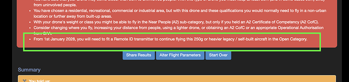

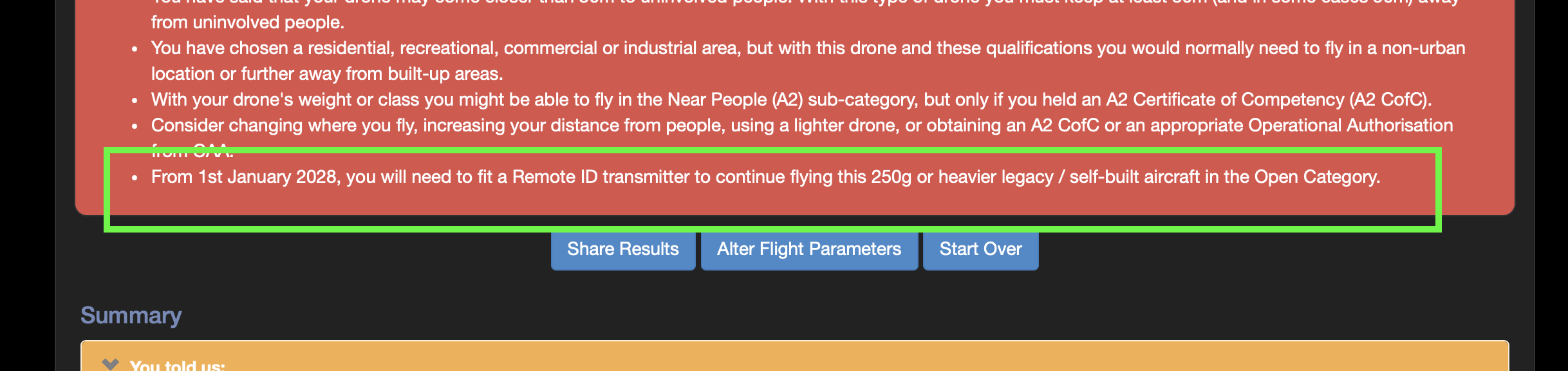

Hi can anyone definitely advise on if I need to buy an ID transmitter for my drones (Mavic platinum pro and Mavic Air 2) I have trawled the internet but the deeper I go the more confused I become!
I have obtained the ID from the CAA. but can find a way to enter into drones?
thx in advance Phil
as this is a legacy drone you wont need Remote ID till 1st Jan 2028
So don’t worry about it too much now as its likely that the switch on of RID on your Mavic Air 2 will be a firmware update and turned on when its needed.
From what I read the Air 2 will support it but not the platinum pro
Abig thanks to you, that makes it fair clearer.
