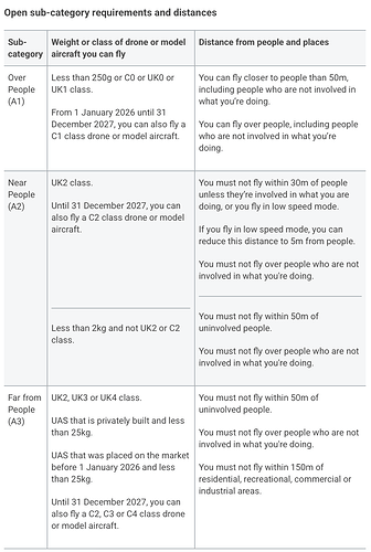

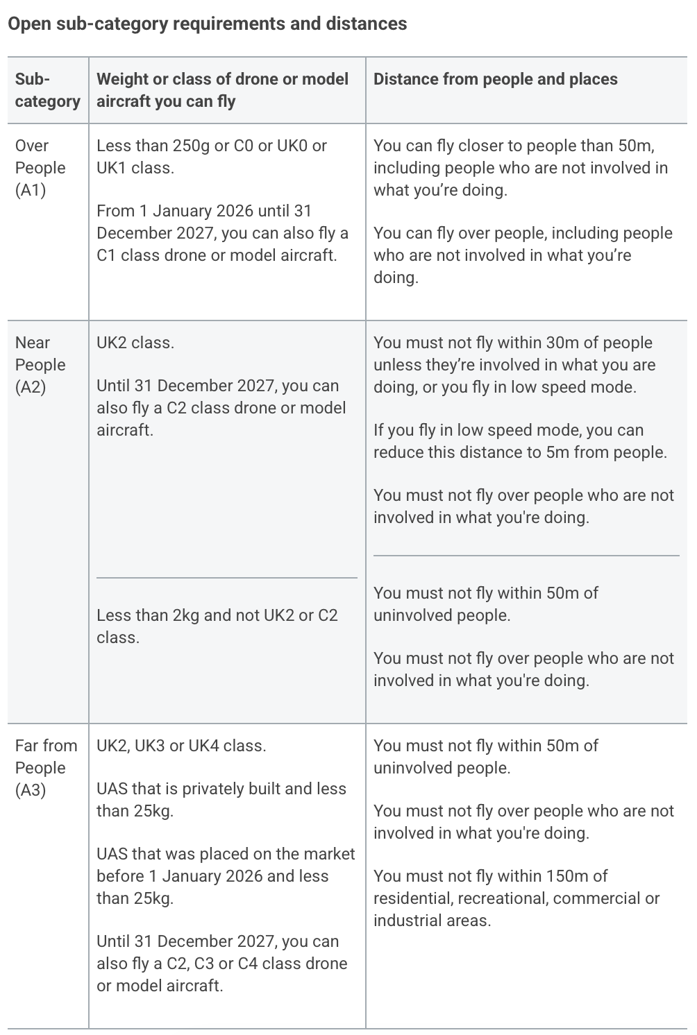

I think you’re over thinking it. In terms of which drones ‘qualify’ for which category, not a lot has changed.
Currently:
To fly in the A2 category you need to have either a drone with no class mark that’s under 2kg and an A2 CofC or a drone with a C2 class mark and an A2 CofC
Under the new rules from January 1st:
To fly in the “Near People (A2)” category you need to have either a drone with no class mark that’s under 2kg and an A2 CofC or a drone with a UK2 or C2 class mark and an A2 CofC.
The table on the “Getting what you need to fly legally” page is pretty clear.
And the same page states that:
If your drone or model aircraft has a C class mark on it, the manufacturer has declared that it meets the European class standards. You can fly a C class drone as if it is the corresponding UK class drone until 31 December 2027. For example, you can fly a C1 class drone as if it is a UK1 class drone.
I am not sure this is correct. My understanding is that European class markings will only have relevance in the UK between 1 January 2026 and 31 December 2027. Currently and for the next eleven days, the rules are essentially based on weight.

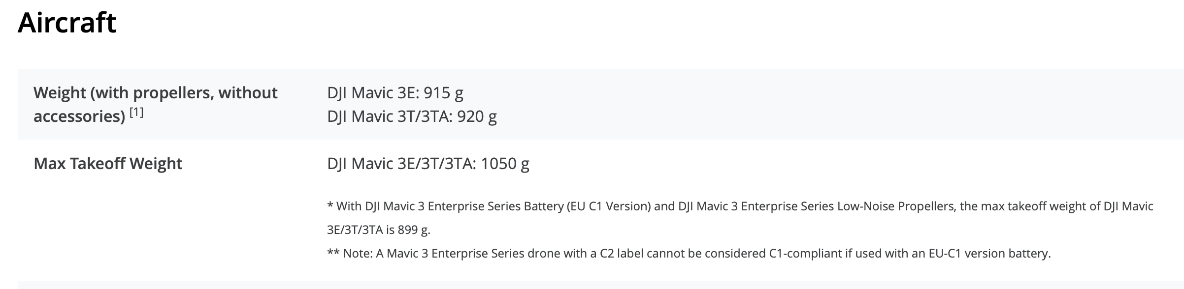

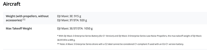

I’m wondering if DJI will create other class-changing options and accessories for other models in the future, like they did for the Mavic 3:

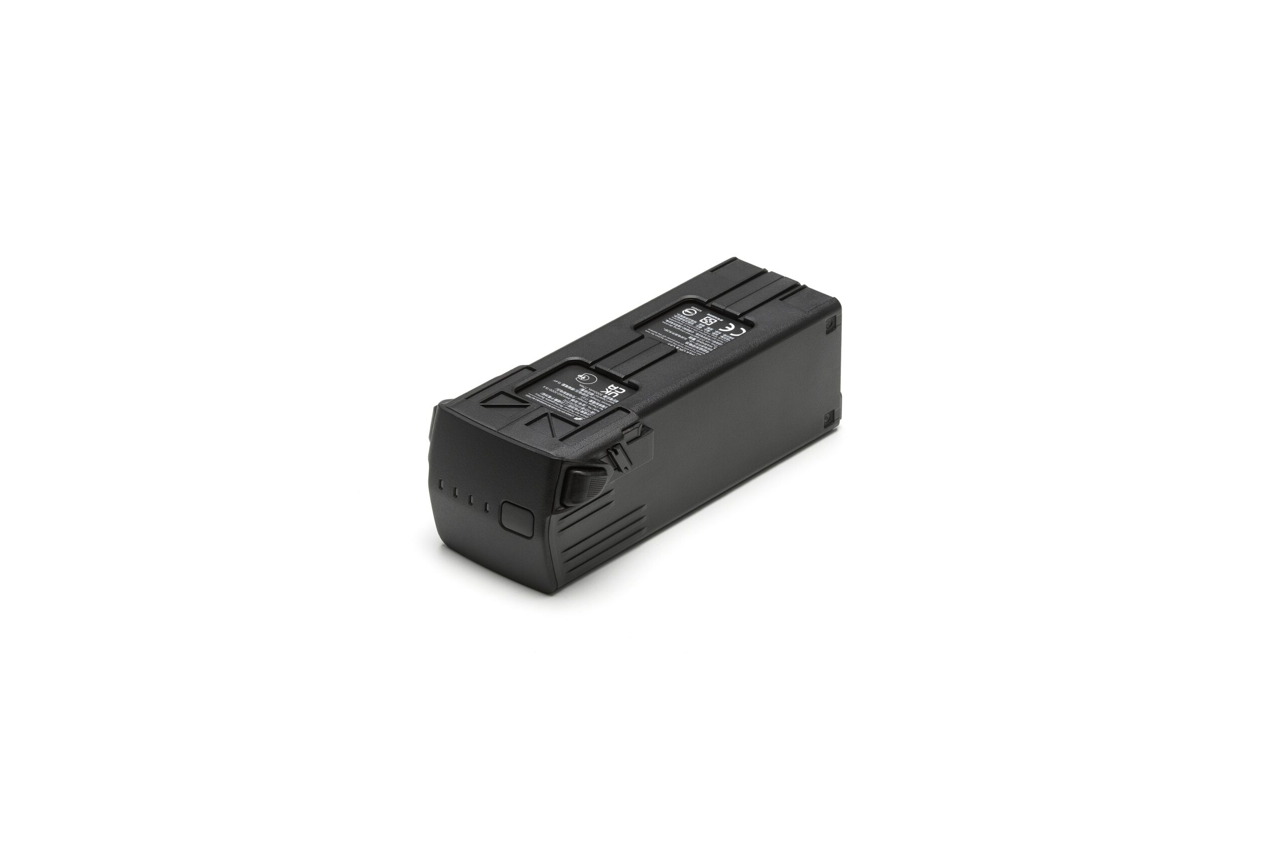

They took 21 grams out of the 3T with the battery and props to get it into C1.

If they offer retrospective conversion to C1 for the 3T - I may just hang on to mine :+1:
