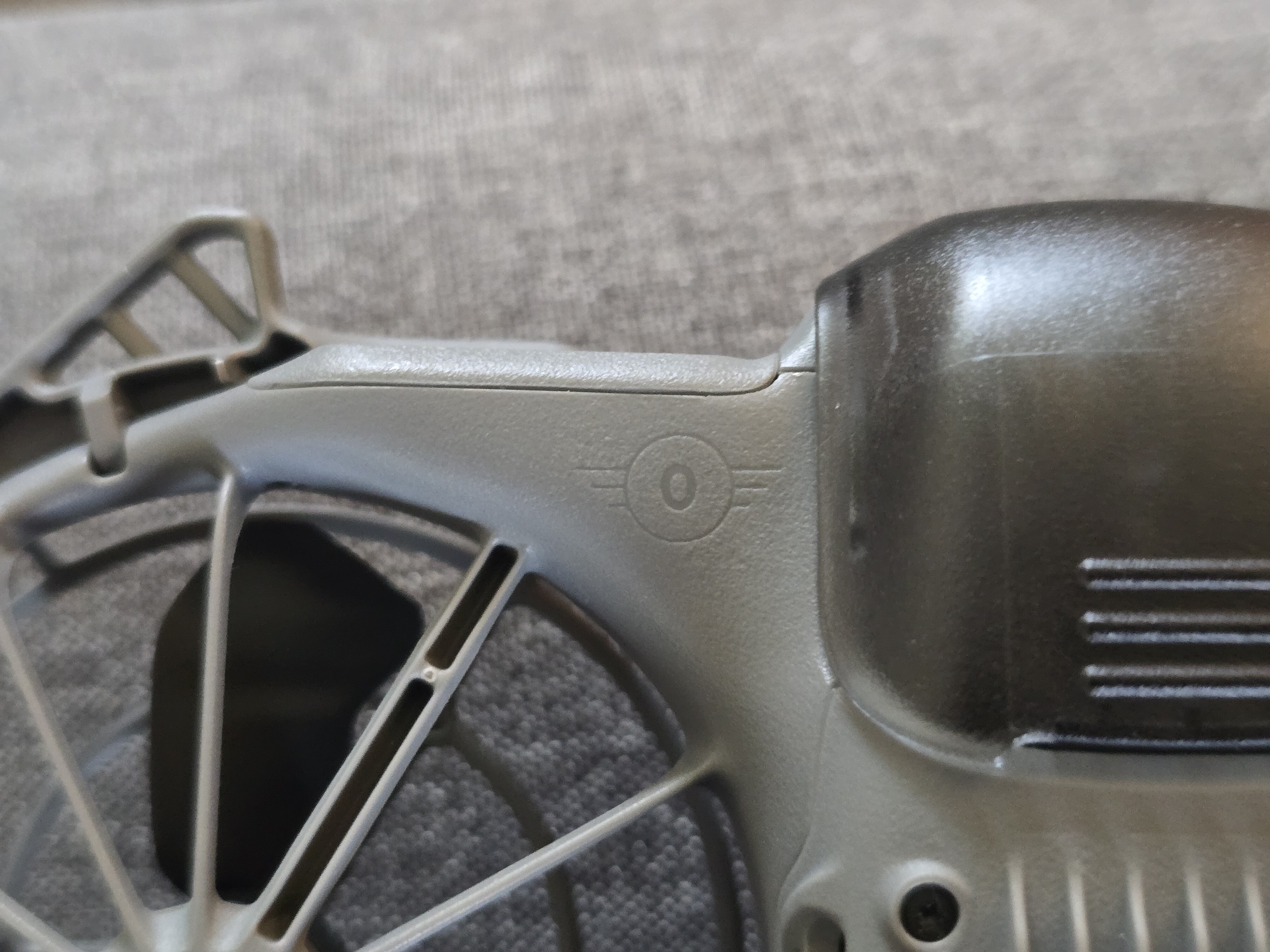

I had not really noticed that it was a O and not a 0 as in Zero. Maybe it’s just the font being used. Looked again and now you mentioned it mmm maybe it is a O ( oh) and not a zero
I think it’s just the font. The zero in the C0 marking on the Neo 2 looks similar.

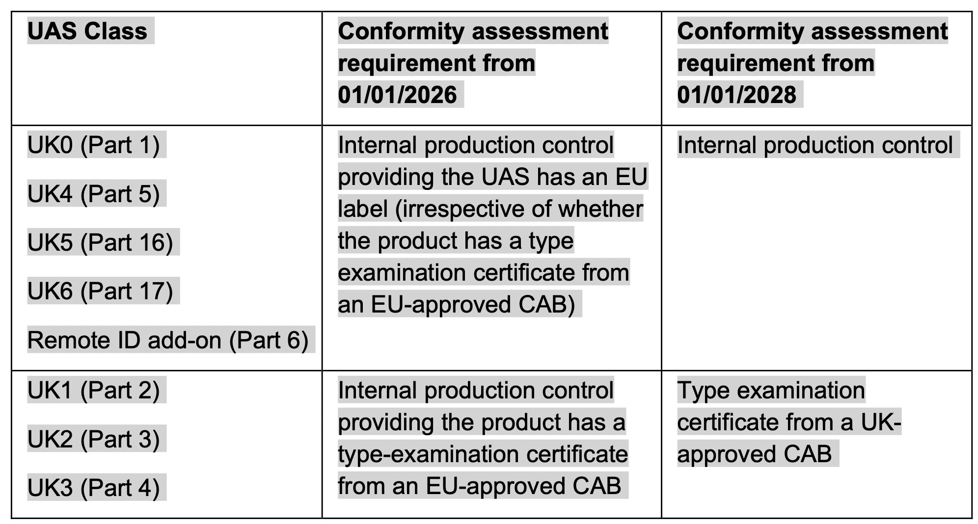

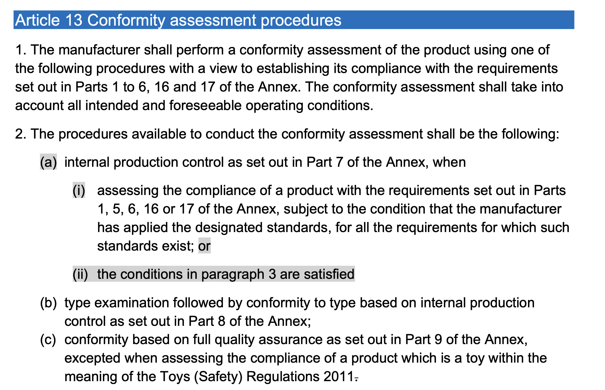

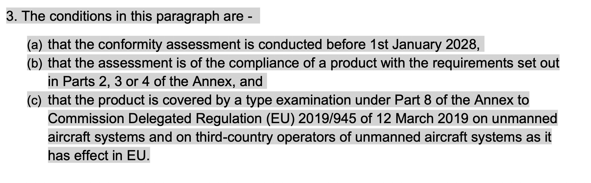

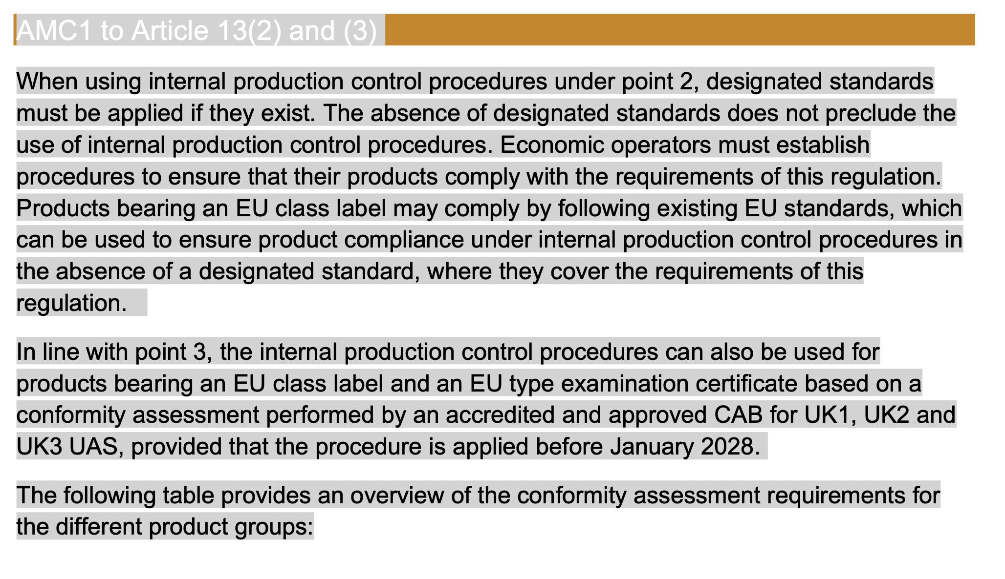

This isn’t new news though. There’s always been the scope in the new regs for manufacturers to carry out their own assessments of products with EASA C classifications and self-certify them with the appropriate UK classifications:
I doubt very much that DJI have just decided that the UK1 classification is close enough to a C1 as to make them the same. More likely the dual classification indicates that the Avata 360 actually meets the requirements for both.
Hmm. Good point. Listening to the video the CAA say the decision is down to the manufacturer so surely DJI wouldn’t put both labels on the drone if they disagreed. All speculation and guess work, but the path of least cost and resistance seems more plausible.
