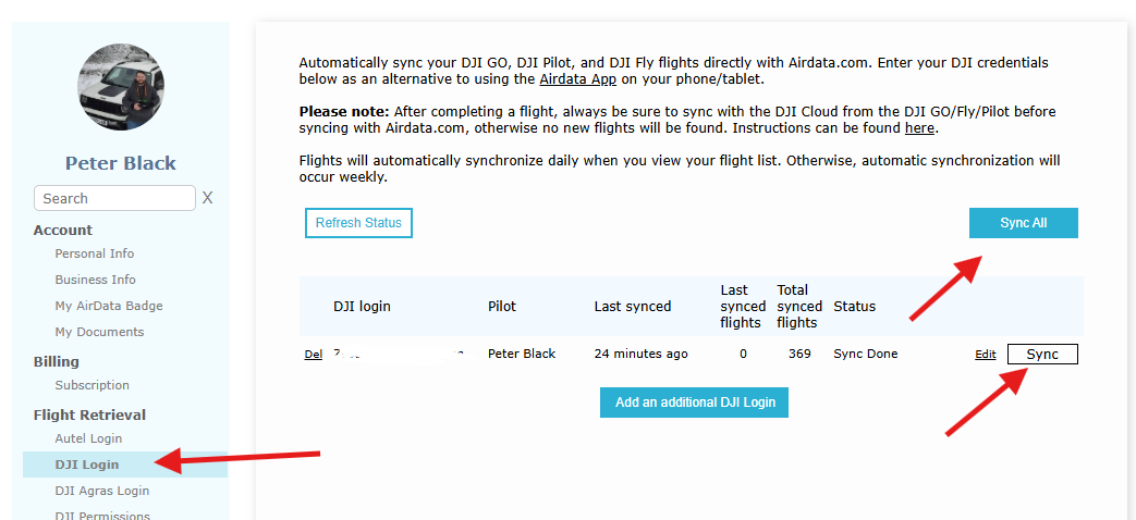

The basic steps are
on your controller in the DJI Fly app is make sure your logged in and the auto sync is on so that it uploads to DJI
log into AirData and add your DJI account details that are the same on your controller and then sync from AirData to pull in the DJI logs and you should see it all there in the log tab.
There is a sync button on AirData under the account menu - do that to force the sync
