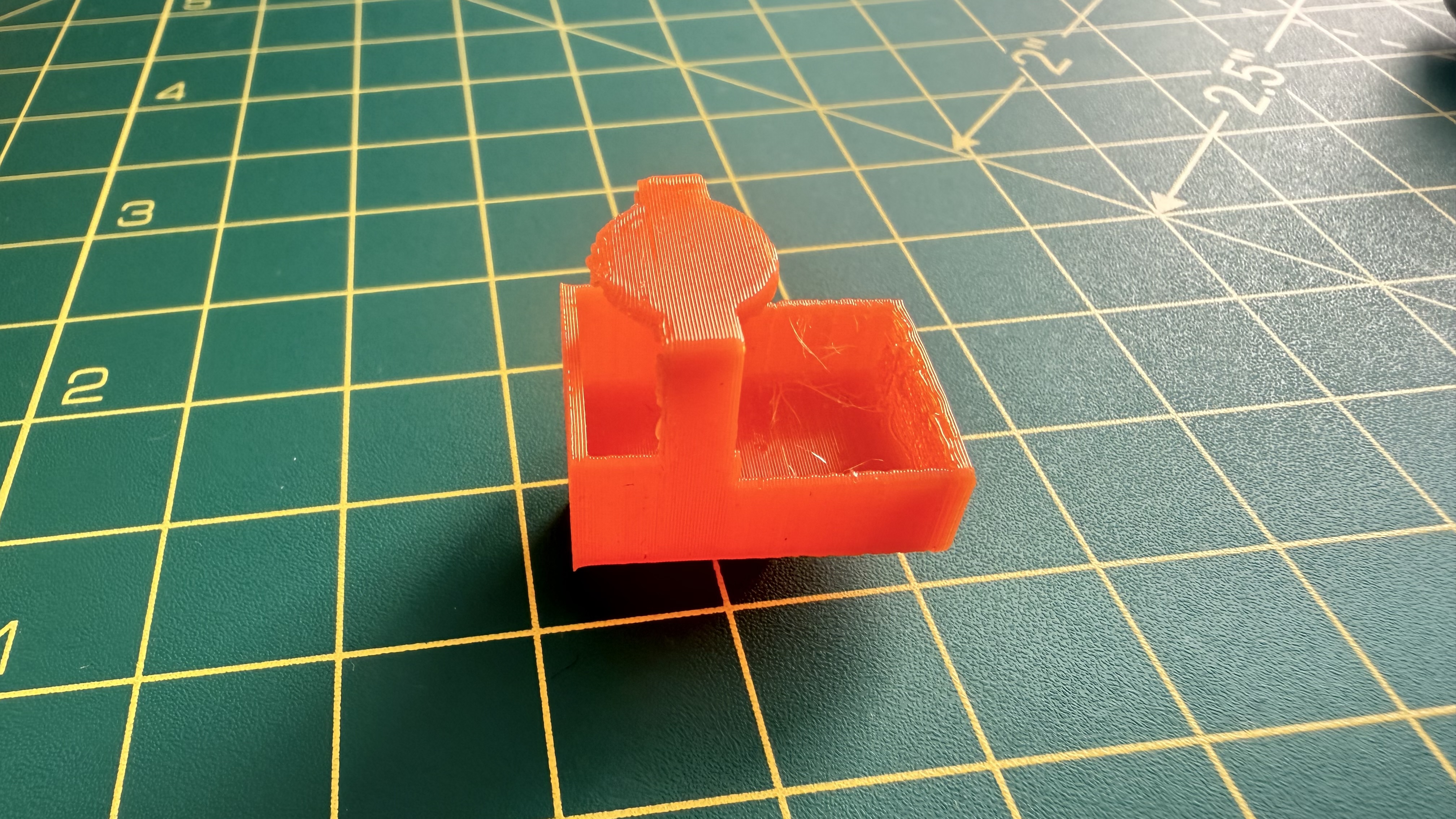

Feel free to use and remix this print that I’ve designed.
Anyone that’s flown with me at a meetup, will know that I have the habit of losing my drones.:rofl:
@jcbdriver Eric pointed me towards the ViFLY Wireless Beacon Buzzer.

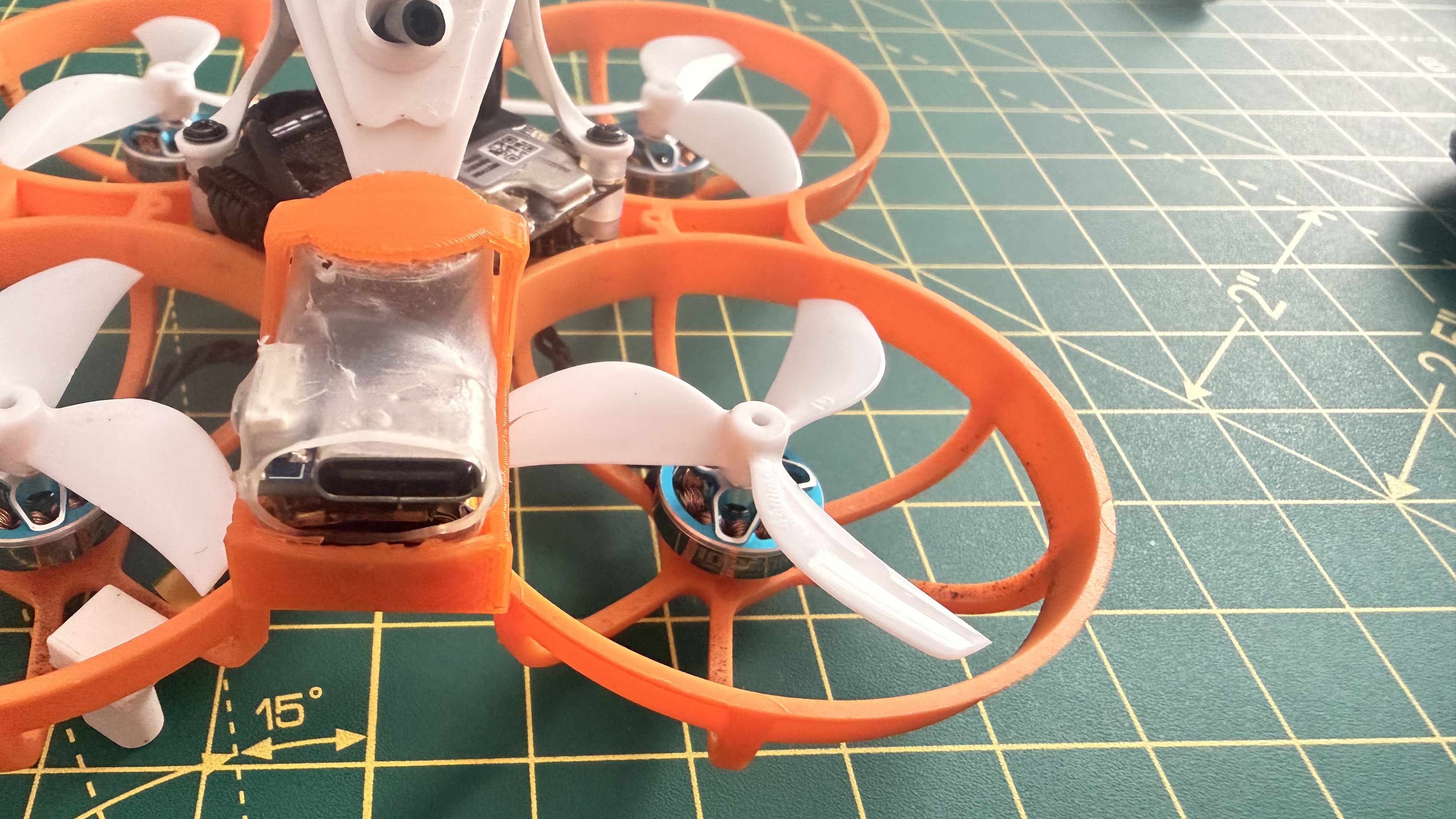

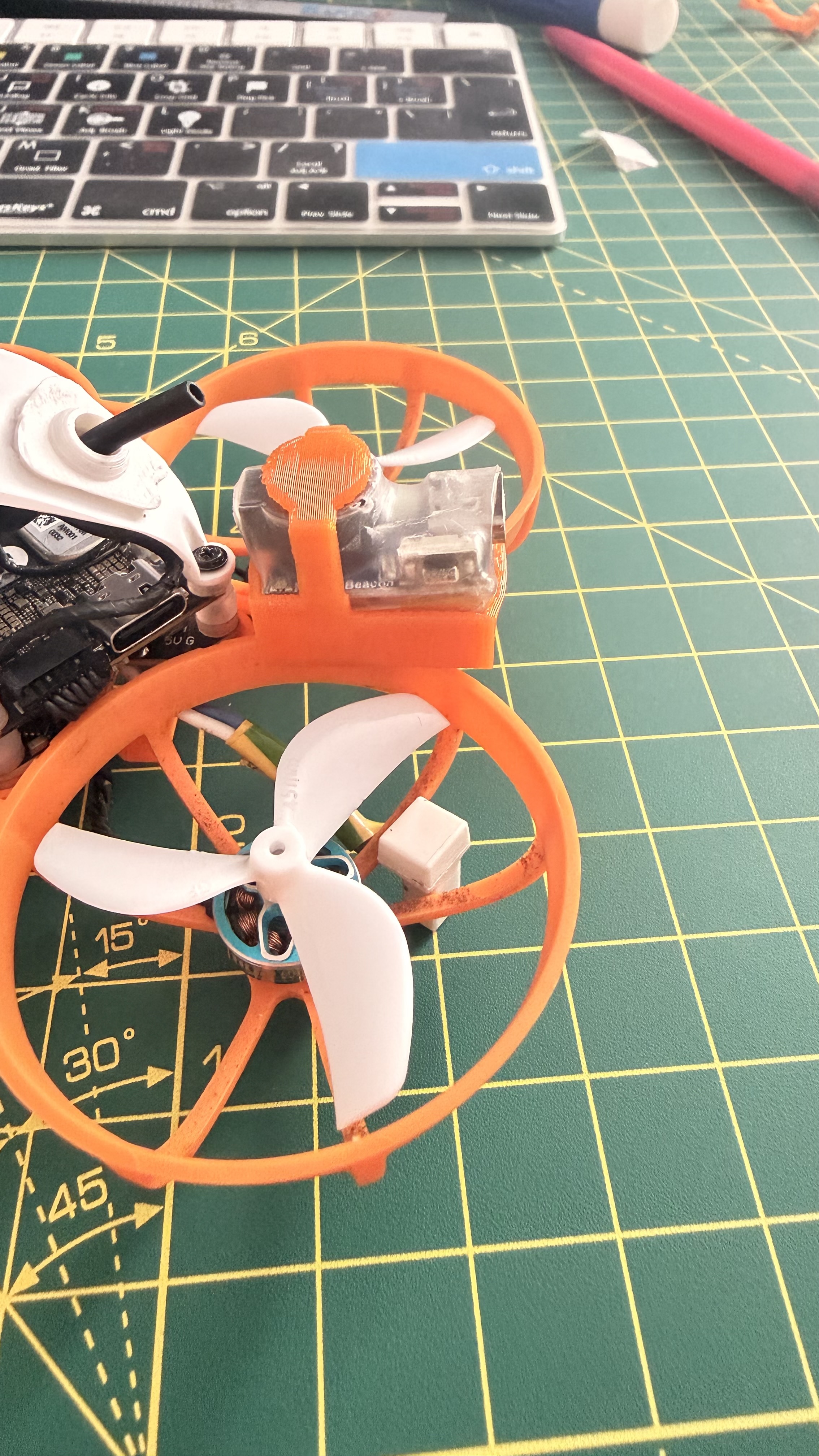

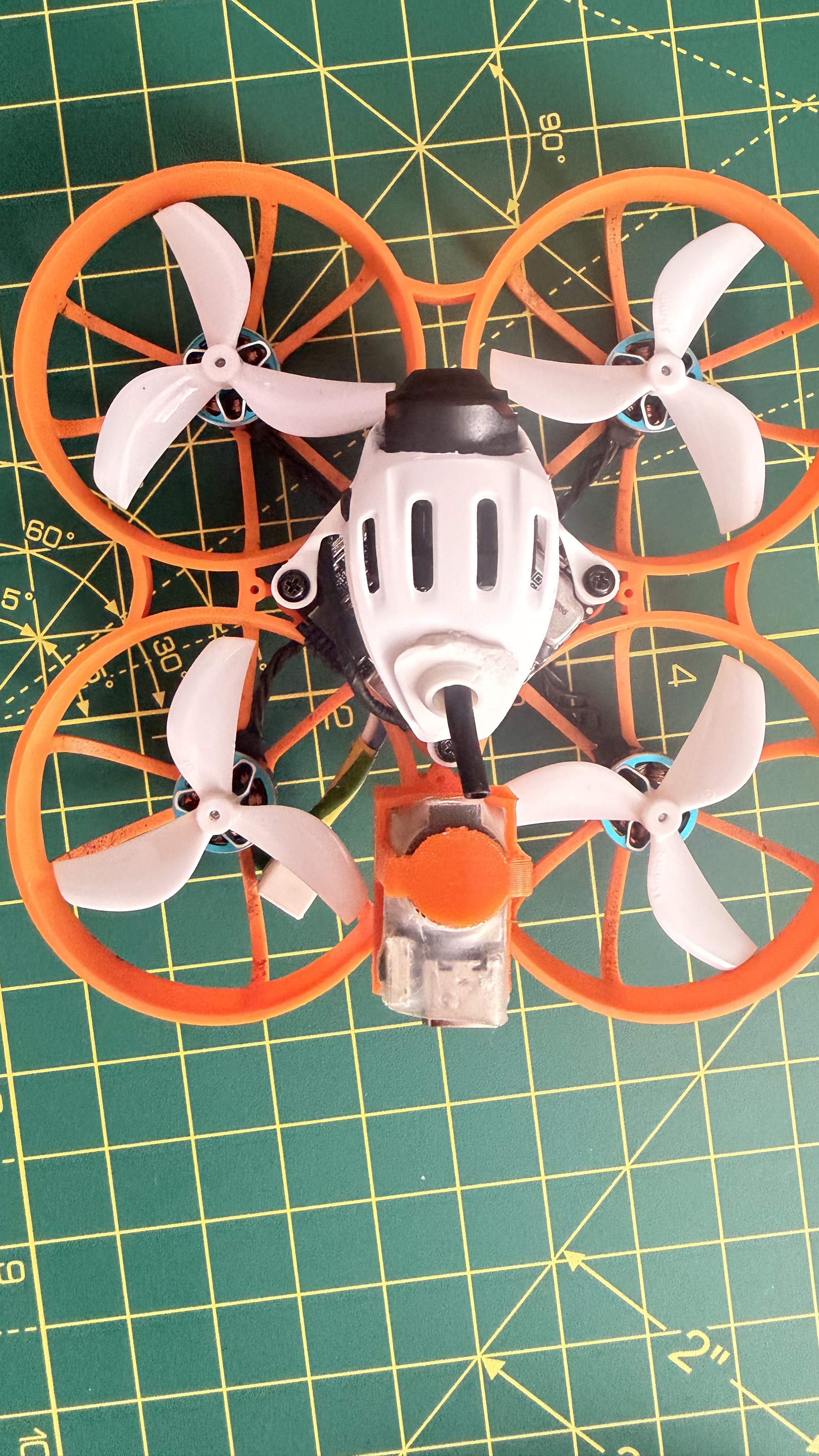

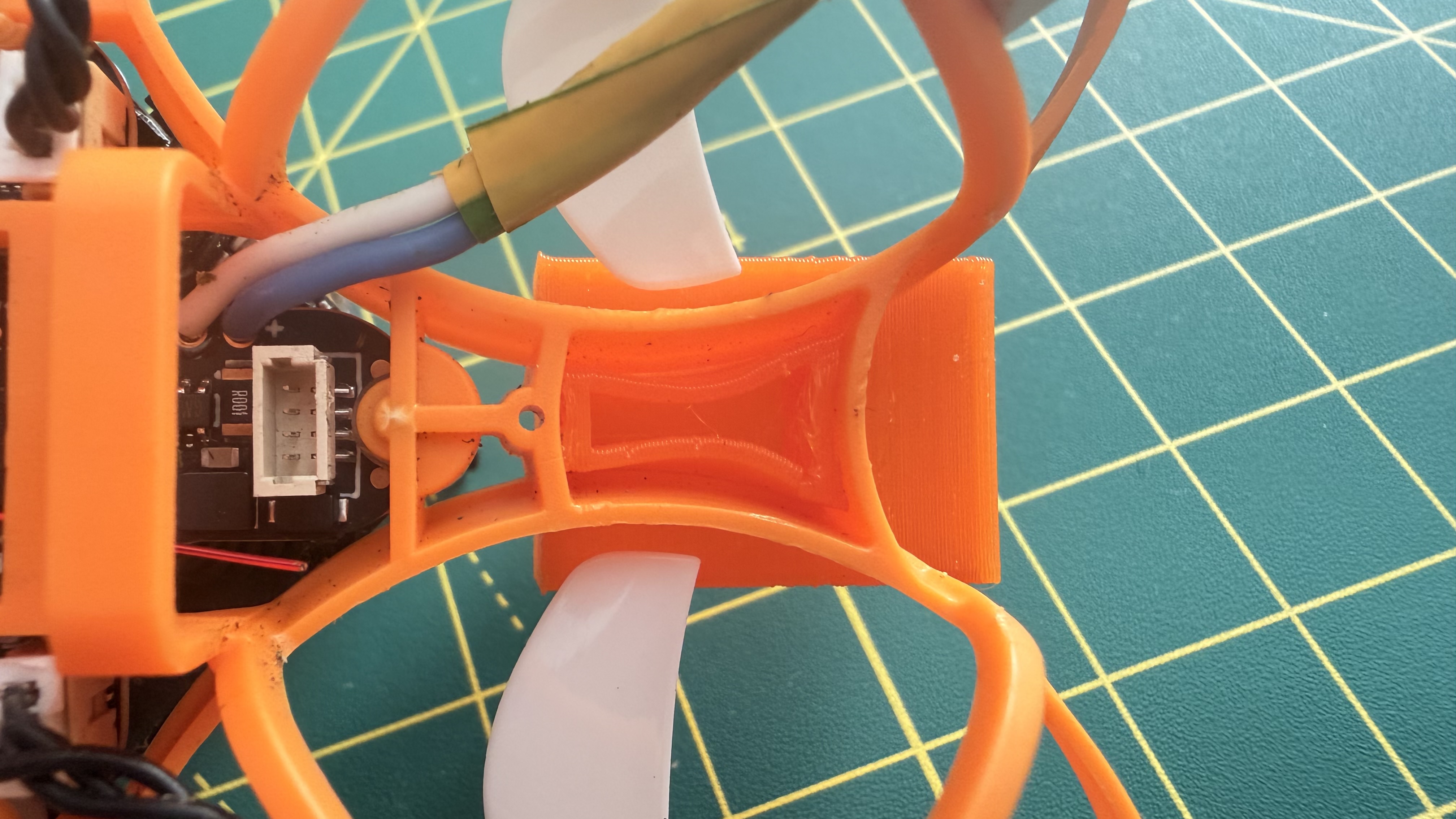

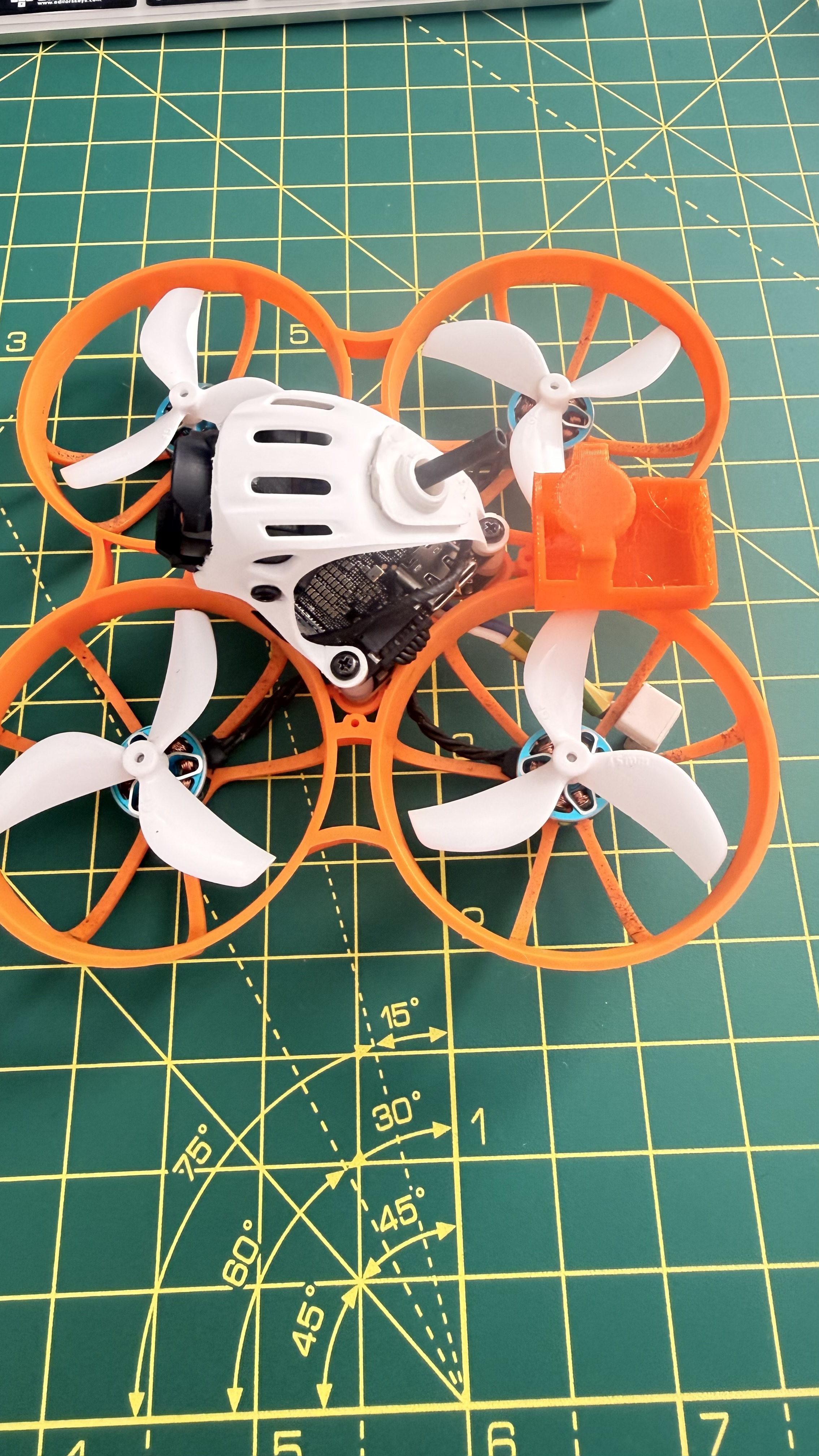

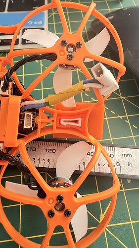

So after purchasing a couple of them, the only way I was able to fix them to my quads was by using tie wraps, which isn’t the best option for small quads (sub 2 inch), so I’ve designed this mount, which slots into the frame of the BetaFPV Meteor 75 Pro.

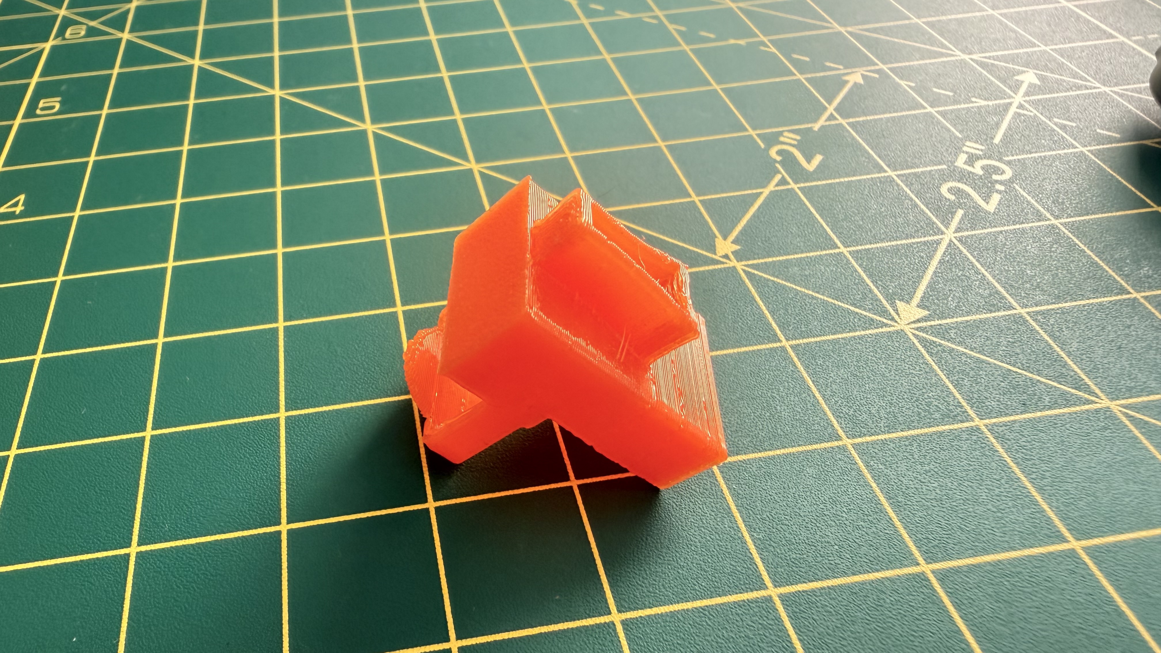

Is a snug fit and there’s a small PLA plug, which keeps the TPU mount in place, to ensure it doesn’t come loose.
I have attached the .mf3 & .stl files
Buzzer Mount - Stl’s & 3mf Files.zip (90.6 KB)

Somehow I missed this, looks awesome @TheBinman. Is it for the vifly mini or the regular one?
I have a mini tie-wrapped to the top of the canopy but this looks much slicker.

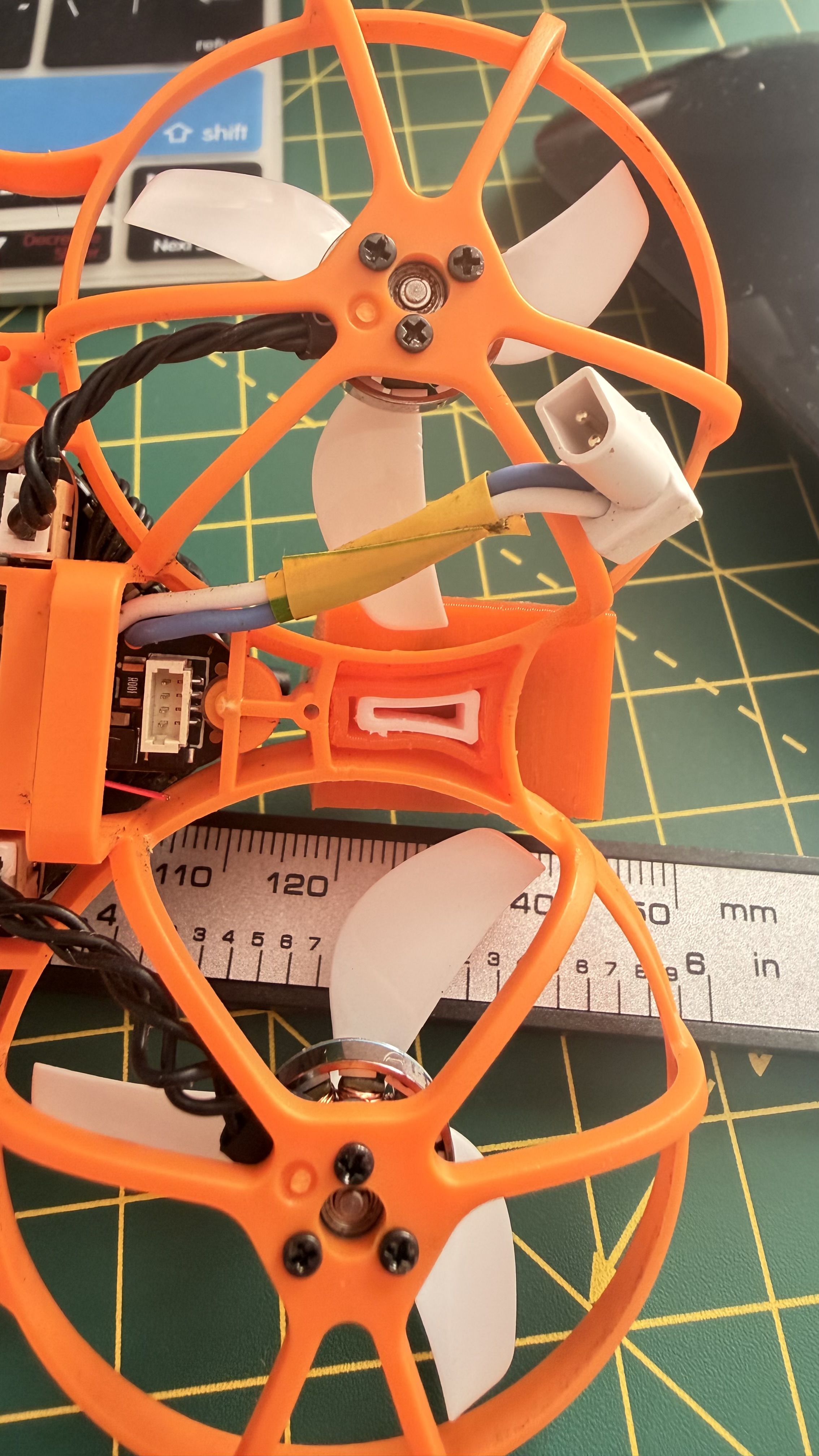

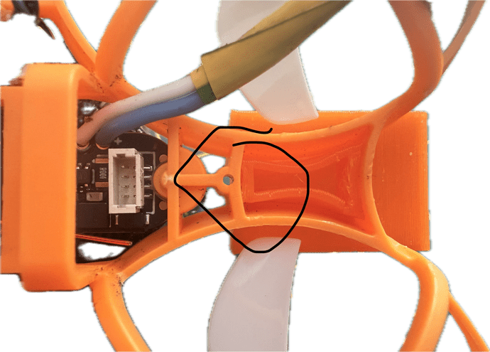

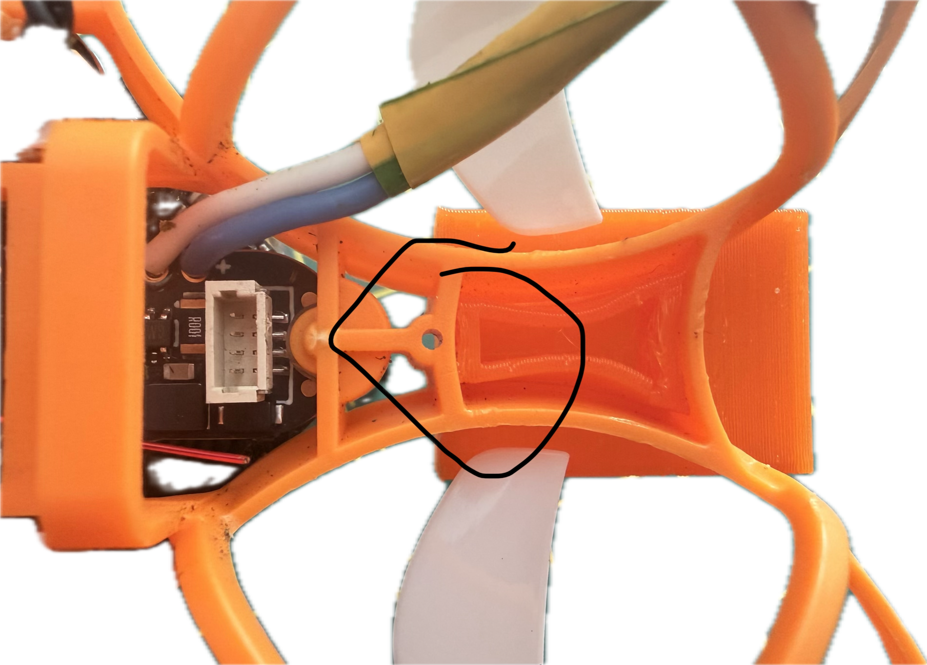

Going purely from the photos, did you consider extending it slightly and trying to use this screw hole to secure it even more?
I never thought of that, I may update the model and re-share once tested. :+1:t2:
