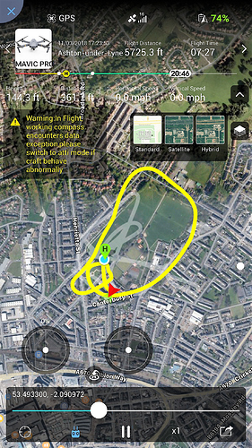

Warning in flight working IMU encouters heading exception
Has anybody had this little number pop up on them yet?
Had it a few times but usually when I’ve added something like a tracker.
Its normally caused by the compass data not agreeing with heading calculated by IMU. It sometimes shows no GPS but that’s because the Mavic sets satellites to zero during an IMU exception as a way of switching to ATTI.
It could also have lost GPS signal as showing 18 satellites but weak signal.
Had you added anything to the mavic? Flew close to or took off from something metallic?
Launched from the same place as I have always done. This seems to be happening a lot recently. I keep getting weak GPS signal even when the drones only a few feet away.
Also nothing has been added to the Mavic.
Have you tried a compass and IMU calibration?
Strongly advise doing this, then completing a test flight after.
Yes I tried all that. I’ll take it to work with me in the morning and re calibrate again in case it was a naff calibration.
I’ve just checked in the settings and everything is on green and excellent.
Do you always launch from the same spot? Looking at your map I noticed that the roof of the Cracking Racking Company is all corrugated steel, this will cause issues considering your flying over it and putting it between you and the Mavic.
Yes, give or take a few feet. I’ll recalibrate everything and try the same flight at weekend.would the roof cause problems at this height? Take off point is in a bit of a valley so you have to raise the bird high to clear the valley wall. Cheers for your input. :+1:t2:
