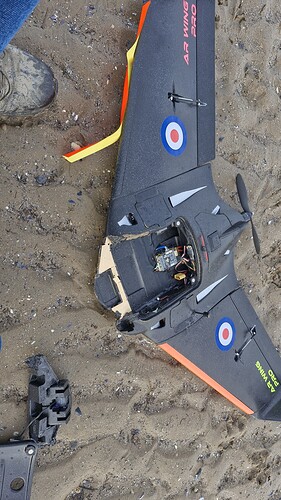

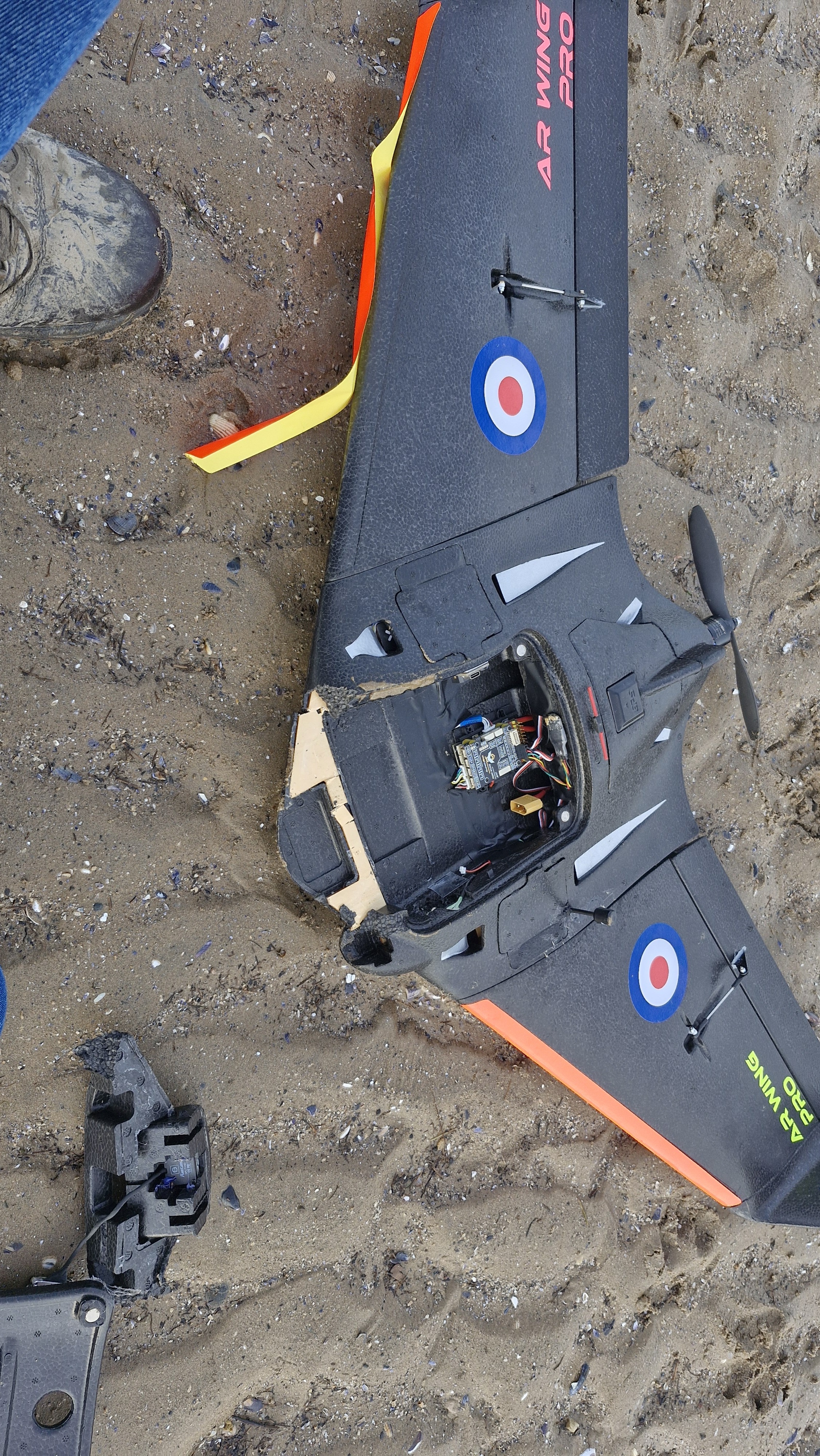

Well that didn't go to plan - crashed wing
I am struggling to get this thing to fly. Lauched ok then i thought i had control but down it went.
I did do alll checks before take off inc a false launch to make sure it started .
Oh well off to the shed and the Internet. Need a new canmera cable.

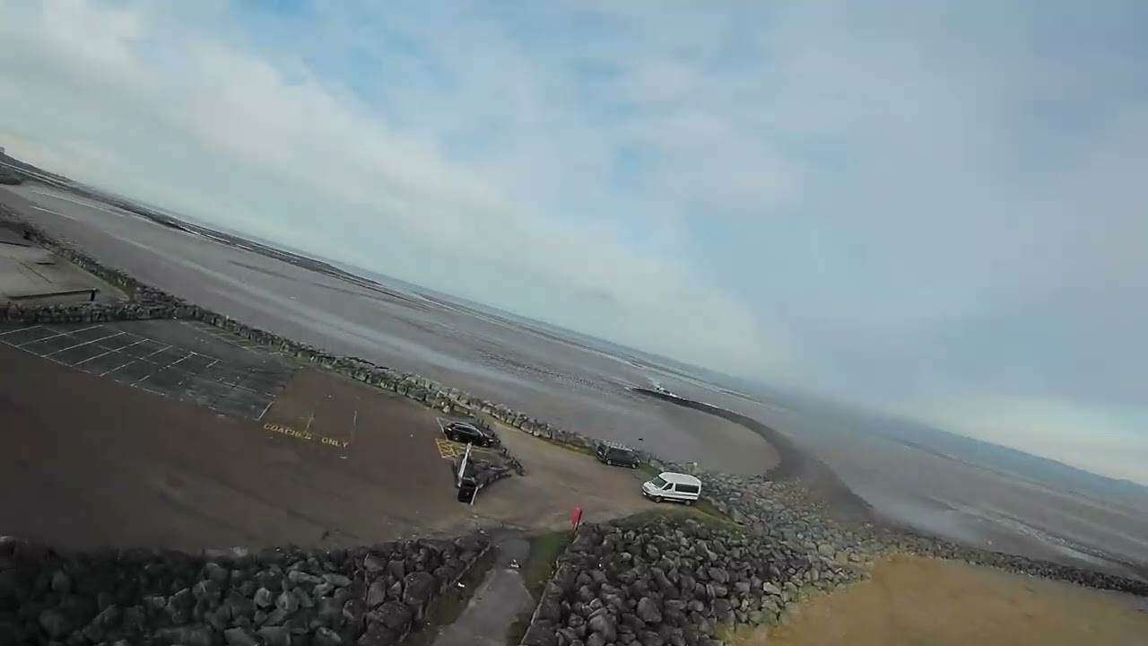

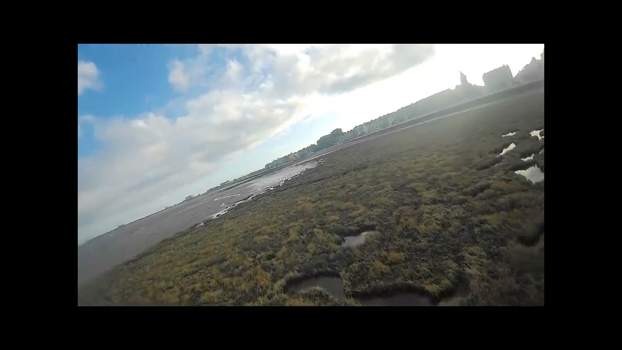

in the second video as it crossed the little bit of water 6 seconds in, I was already on the controls trying to raise the nose, nothing.
I see the shake on the first video, I hadn’t realised I had done that. my concern obviously is lack of control. As in the first video I took control at 10 seconds and immediately lost control, (but I still had video on the way down, but not recording,) yet on the bench and pre flight I have full control.
