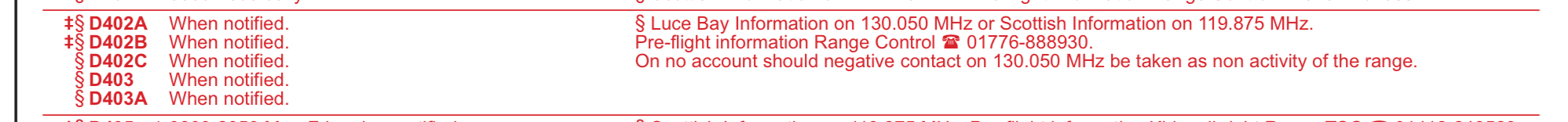

It’s a ‘D’ not an ‘R’ - always worth checking the notes:

The information is taken directly form NATS eAIS part 2 ENR 5.1.
The D area is activated by NOTAM but even so, check with range control as specified in the instruction.

MOD West Freugh Range (formerly RAF West Freugh) is the reason for the restrictions It is operated jointly by Qinetiq and MOD. It occupies some 750km² of airspace, 380km² sea area, and 12km² land area (comprising hard and soft target areas). The runways are disused and unlicensed but available for military exercises.The Range can be used for for military training, bombing, lasers, UAV testing (!) or a parachute drop zone. We holiday in this area and the walks along the foreshore can cause anxiety. There are red flags flown when exercises are taking place. Fabulous scenery worth a visit.
