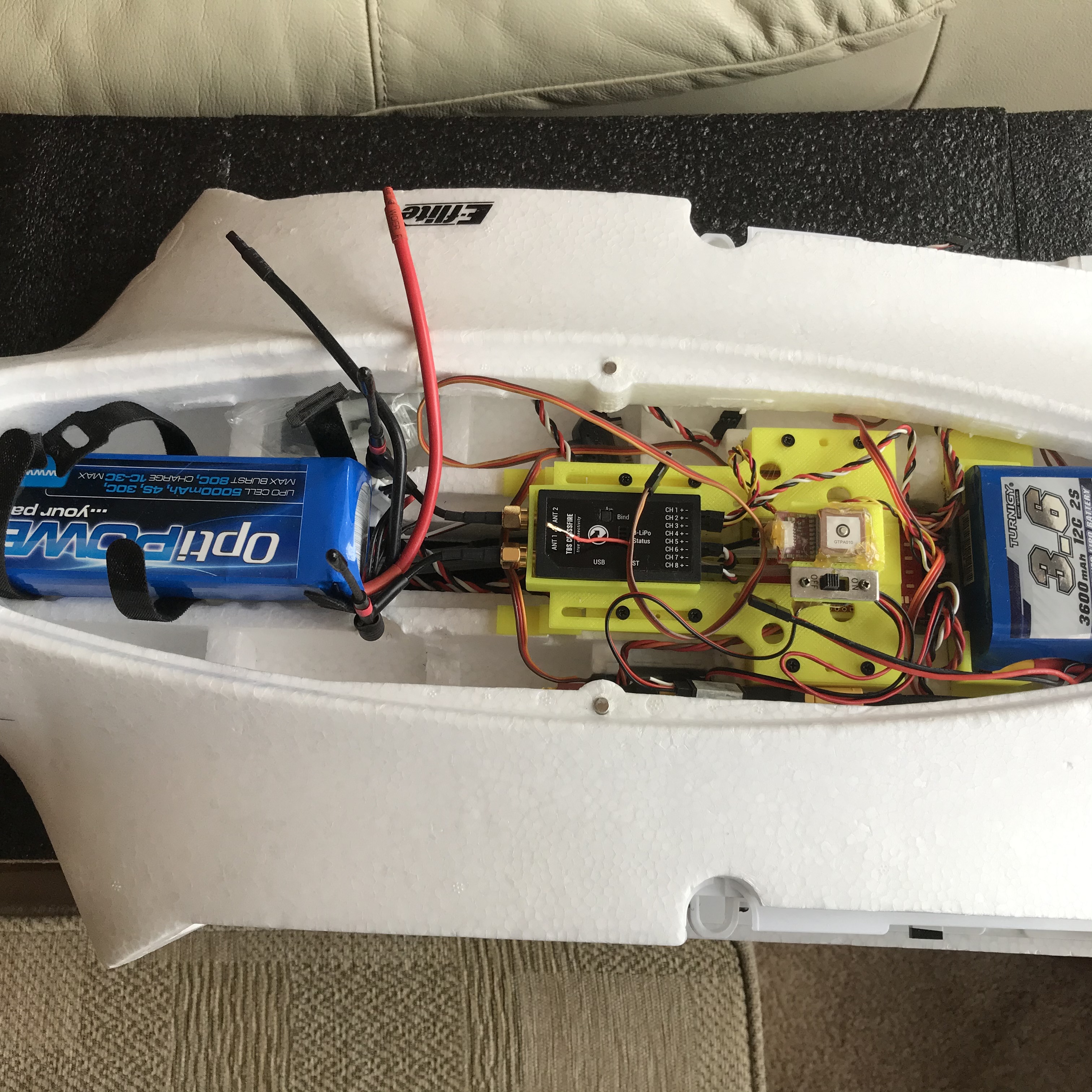

My THEER wing, the black one, has a MATEK wing FC inside it running Arduplane. It was a breeze to install and setup.
