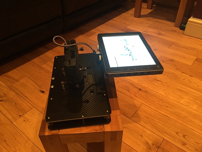

I’ve nearly finished my setup ready for the spring, (homebuilt using some parts from my Titan Cyclone) 2 X 3 watt boosted 14dbi and a nice bright CS ultra, because an iPad mini 4 just don’t cut it in bright sunlight. The Titan cyclone did me well and got me 5th on the long distance Mavic LB, but at distance HD was poor so I needed more signal. I’ve had a test of this setup and it performs superb.

That is by far, the biggest antenna mod I’ve ever seen!!
Impressive :smiley:
Did you mod it yourself?
Is it heavy?
Yep, made by me, it weighs around 2000 grams, will be tripod mounted.
Nice!
I can’t tell from the photo, is it powered? If so, via the controller? Or it’s own battery?
It has a battery inside, I get about 3hr of flight time before it needs charging

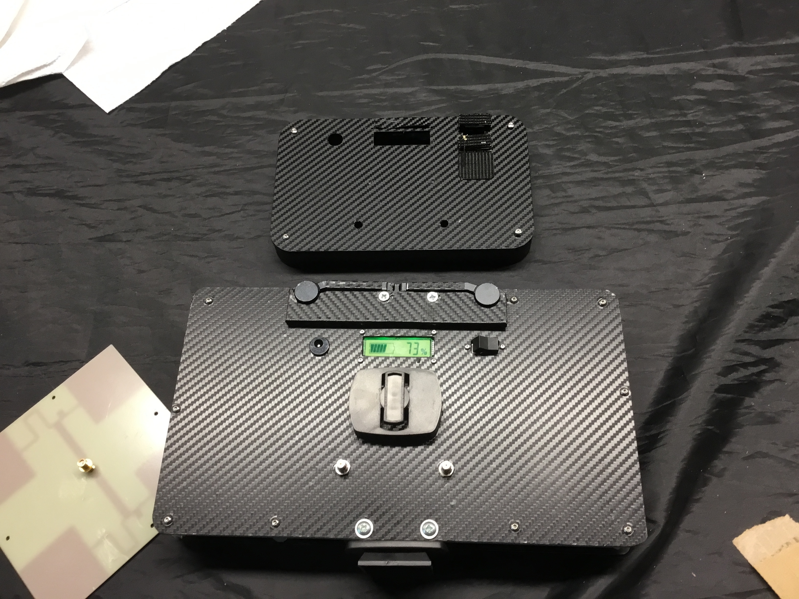

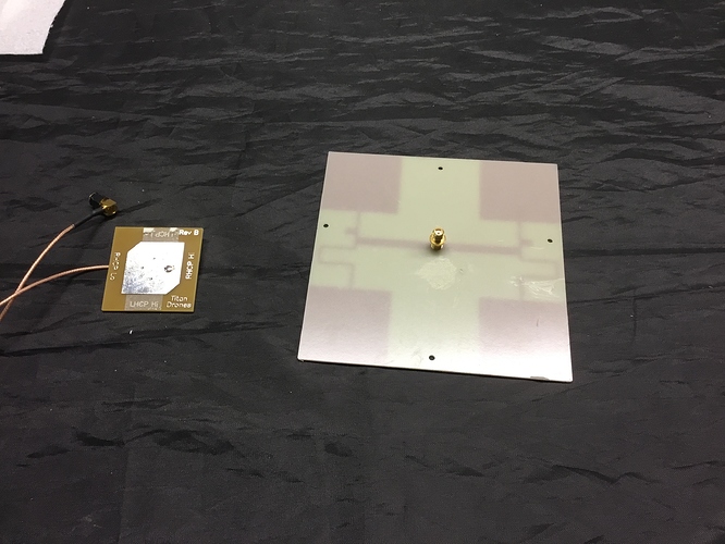

Sorry for the late reply as I totally forgot about the email notification as I was away from home. I got 2 of these antennas from eBay and removed the outer plastic casing.https://www.ebay.co.uk/itm/Antenna-Panel-Directional-WiFi-Router-Flat-In-Outdoor-2-4GHz-14dBi-Free-Ship/253334233988?hash=item3afbe5a384:g:jRYAAOSw8gVX2O-r
I used the parts from my Titan Cyclone ie…amps,battery,voltage meter, twist lock & quick fit connectors and made a bigger version of the cyclone and slapped on a CS & tripod mount. The pics show the difference between the tiny 9Dbi Cyclone patches and the bigger 14dbi ones I’ve installed

Can’t believe how small the patches are compaired to yours :flushed:. This is right up my street.
