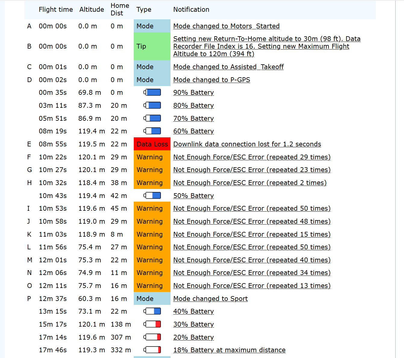

What a way to start the New Year; a midnight hunt in fields for a Mavic Mini that’s blown away. I still love the Mini but really, I think 2020 will be the year of Mini Blowaways…
This time I use AirData.com and find out exactly why experienced flyers are still getting caught out with the Mini and the wind…

AirData.com will calculate that from the flight data, using the known model, user inputs and tilt of the drone to work out the wind speed at any given moment of the flight, then present it in a nice graph. Shame it’s after the event so to say, but you see this at 5:03 on the video:

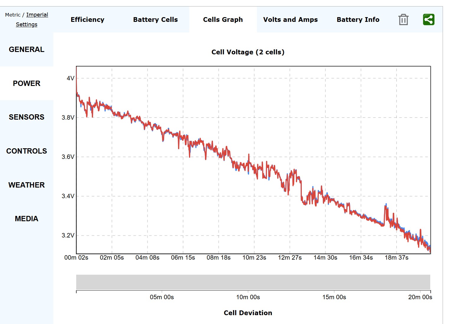

Well, looking at the voltage drop you get along the flight, then cross-referencing it with the ESC Insufficient power errors, it seems to me that on breezy days it all goes tits up after your battery level drops below 60%… I see another wind test coming on… (Poor Mini) :rofl:
I read somewhere else the same thing about mini drifting after bat dropped bellow 60% going to go search now
