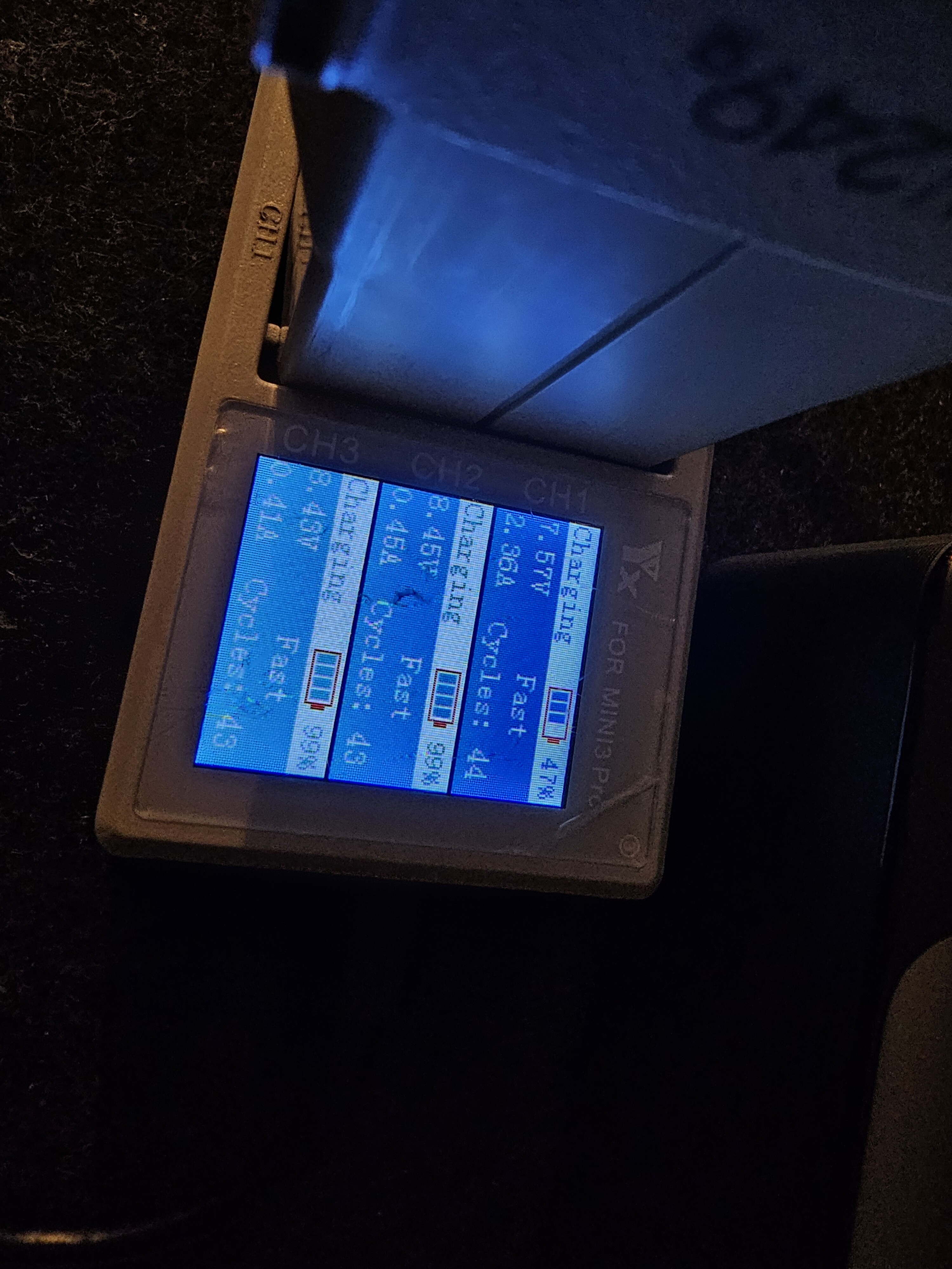

The cable shows the watts that are going in, my battery hubs for the air takes about 57w and my mini 3 takes about 28w
Would highly recommend can charge batteries and RC at the same time too. Taken my charge time from about 5 hrs to 2 hours
I think 3 and a bit from nearly empty, one day I should test it but I know charging batteries from other batteries there are some big losses involved. Like I said I dont tend to go much lower than 40% because most of my flying is near or over water. Due to what I film and tides etc… I tend to fly continuously for a few hours with very few breaks.
That charger is the Lyongtech for mini 3 pro which says it also does 4 pro (amazon). Also does storage charging to 60% which is a bit nicer for the batteries if youre going to put the drone away for a bit.
