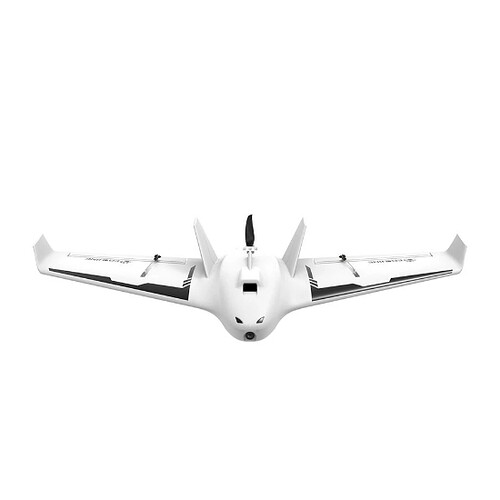

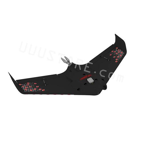

I’ve been looking around and these two jump out (want to spend £150 max, closer to £100 better) for wing, motors, ESC. Have the FC and a RX, etc…
So looking at the following:
Craig has one, seems OK, though little concerned with videos on room, and cooling through the bay for the VTX.
I like this one, slightly cheaper, loads of space, good reviews… Heard bad things. Other options? I want a quick wing really…
Thoughts, esp the experienced wing builders :wink:
Buddy of mine calls the AR Pro a Marmite wing, people seem to either love it or hate it.
Most that I know seem to get best result launching it overhead, which can feel unnatural.

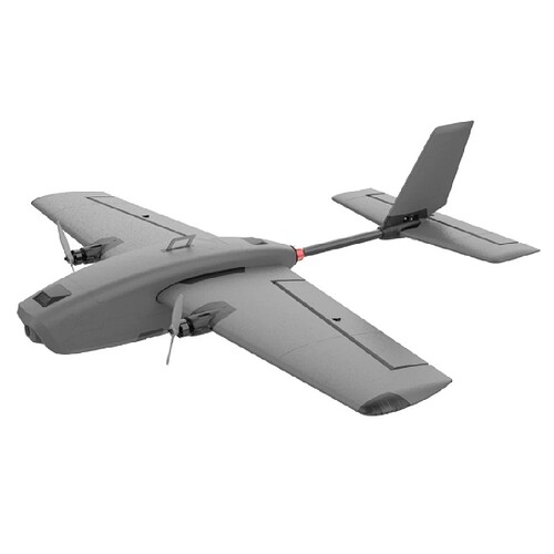

I have a T1, with a Matek F405 FC and it’s not particularly cramped, I have a 1S WS VTX in there, and a crossfire RX and GPS, plenty of room for a 3 x high current 18650 pack.
T1 flies well, I like the twin tractor setup as there’s no chance of hitting your hand with a prop, can do endurance flights as well as the AR Pro.
I guess it depends on what else you’ve already got, maybe go for whatever is most unlike the rest of your fleet. Both fly well, especially with a FC onboard.
Cheers for that. Defo will put an FC in there. I’m still relatively new…
Maybe the Mobula, I know a few fans, and it’s a little cheaper, for me to learn how to land a wing!
FWIW, I don’t have a great deal of experience with pure wings, I have mostly flown planes with tails, but as I understand it, the Mobula is less forgiving than the other two. If it’s speed you’re after, either the AR Pro or the Mobula would do, but the smaller it is, the less forgiving it seems to be.
