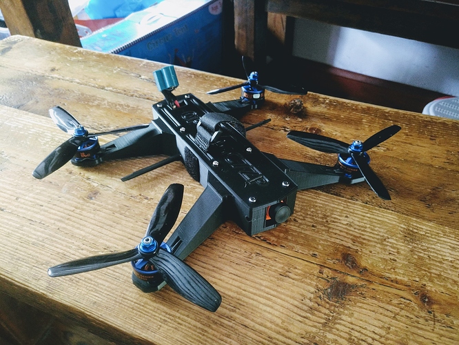

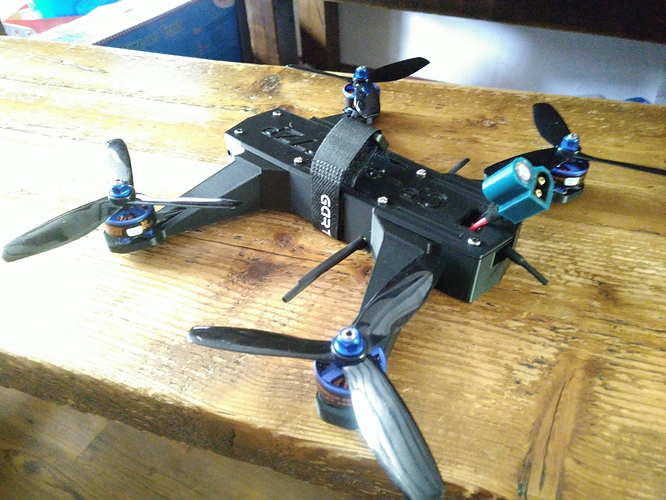

Maybe a bit late to the party however I’ve printed my frame too.
I’m a complete novice in terms of high PID rates however pretty happy with my setup.
I use CC-TREE ST-PLA and then anneal the PLA in a dehumidifer at 70c for a few hours which makes them super tough.
Using this frame https://www.thingiverse.com/thing:4277862
I might give that a go with some spare bits I have
I haven’t got a dehumidifier. I’ll try the oven on it’s lowest setting on a test piece.
Oven should work fine, just make sure you set it 70 and wait for the temp to stabilise as many ovens will overshoot the mark and then slowly come down to temp.
Try the frame I linked to. Seemed the most durable of the lot that I found on Thingiverse.

Let me know how it flies / if there are any vibrations, like.

Will do, by vibrations are you talking of the blackbox logs?

Well, the flexible arms. Whether you have to change your pids much. Suppose it’ll be good on a 5"
I’m afraid that’s beyond my flying level to determine currently. I’ve only done a handful of proper acro flights!
