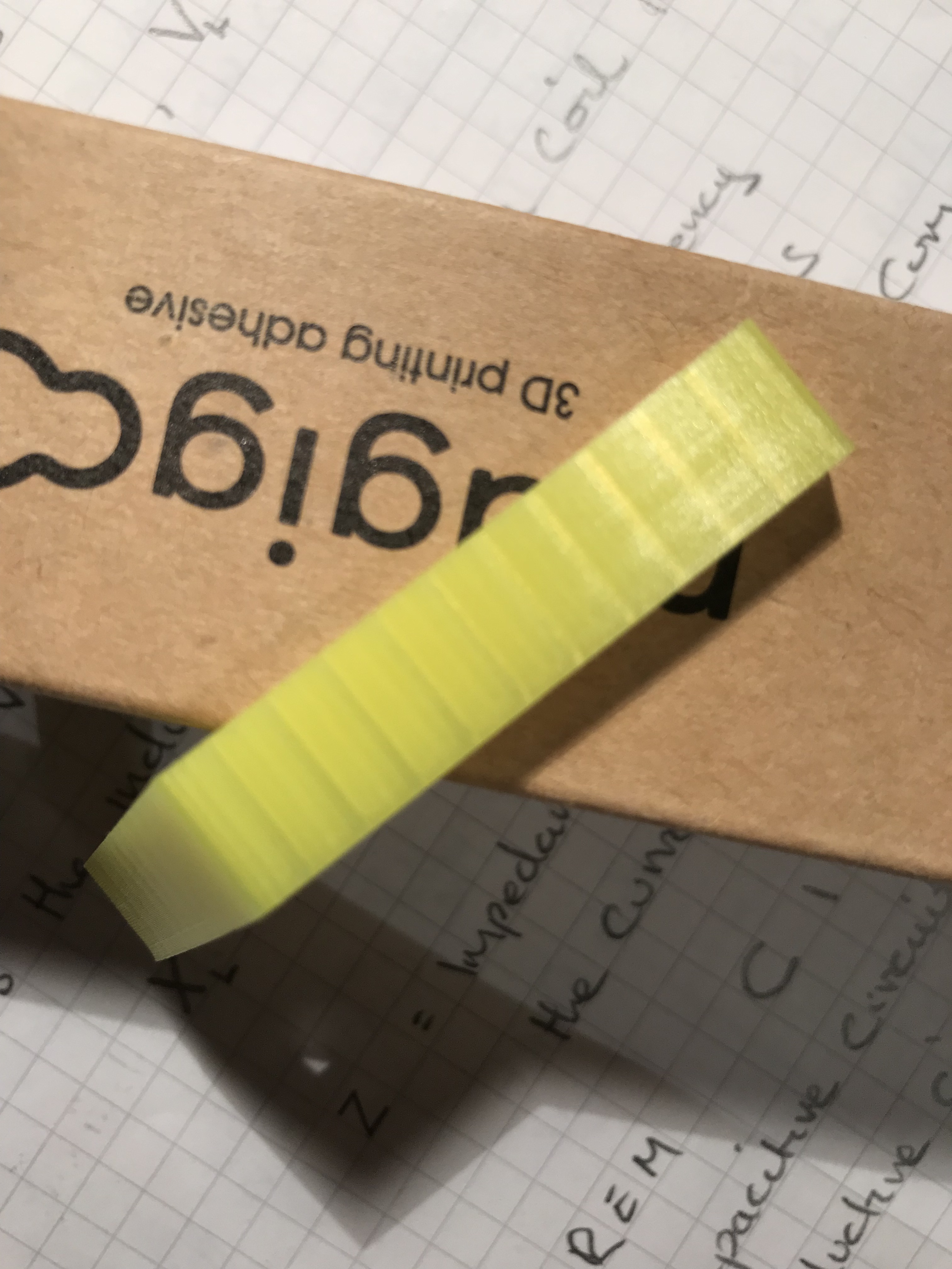

My current nozzle temperature is 189^ for my cheap filament, it took a while to work out the best thickness of the thermo insulation, once I got that nailed my hot end sits at exactly 189^ without fluctuations and as it’s PID controlled and that’s incredible. It used to fluctuate quite a bit before, by as much as 4^.
As the filament is extruded it needs to be cooled down ready for the next pass especially when printing on a hot bed. Most of my PLA prints have been on a glued cold bed so I didn’t need cooling, I’m experimenting with a new adhesive that only work when the bed is hot so hence the cooling duct design.

Oh and my first print just done
