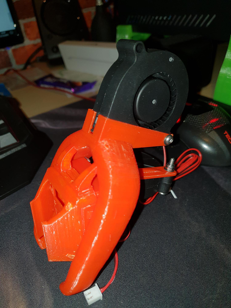

I upgraded to a fang cooler using the standard fans so I could see the nozzle, you could hardly see it before even if you got down level with it.
The above will be replaced with this as soon as my all metal hot end arrives, I’m hoping these radial fans won’t rattle like the small original.

So moving on to other printer parts, a need for a cooling duct,the concept illustrated will later have a duct to the hot end.
