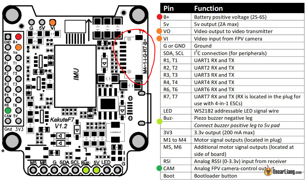

I’ve just been sorting out the ribbon cable from the fc to the aio esc.
You’ll see that the inputs and outputs are in a different order.
It’s a bit of a pain, but you need to swap the cables round so that the fc and esc can communicate.
ESC
FC
Cable split apart, and rewired

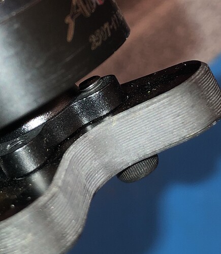

Steve, did you use the stock motor screws? Seem a little short.
No mate,
I cover this in the 4th video which should go up at tea-time ish.
8mm are supplied, but I’ve bought and used 10mm, also the heads are a bit crap on the supplied screws

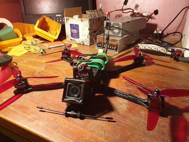

Mines done now, and hovers nicely in the back yard. Shame I can’t fly it for a month!
Weight is 610g without battery, 1221g with :roll_eyes: Might have to try li-ions
I’ll try and rustle up some sort of captioned build video at some point.
Looks bloody great Mate :clap: :clap: @notveryprettyboy
Like the colour scheme, black with a bit of green to hide in the grass.
Would love to see a video if you were to take it for a ‘walk’ whilst on your daily excercise :slight_smile:
