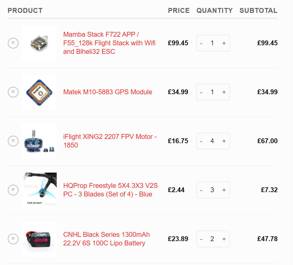

Where did you order all your other parts from Chris? Seems crazy that you would receive an O3 AU from China and your frame from Canada before your other parts presumably from a UK supplier? I guess the postal strikes have something to do with it? ![]()
Just realised - your shopping list doesn’t include a controller or means of viewing the video stream.
What are you gonna be using?

There’s not a lot in stock at UMT atm I’d buy… ergh… The other mamba is a mini or a 405 (which would do… but nah)… And the iflight blitz… Silly price
Although was your stack 99+VAT or inclusive?
If exc. VAT then maybe… I believe the iFlights have a good rep… (someone else can vouch for them)
Wow that’s silly prices really… My first was around 60/70 quid I think only just over a year ago… I maybe remembering with rose tinted glasses… But £120 inc for a full stack… Ouch!
I need a 3A BEC though, this doesn’t have that, for the O3 AU.
Ive not had any issues with my Evoque flight stack but Ive seen lots of people claiming the esc’s damage easily
