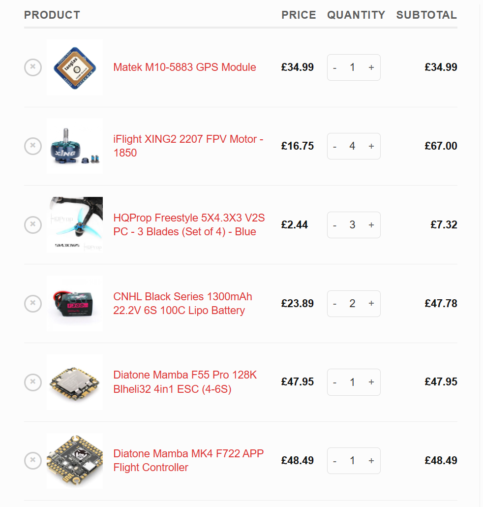

Diatone Mamba F722 Stack MK3 45A 128K | HobbyRC UK that’d do, slightly lower ESC AMPs but… I think 45 good. Actually think that’s what I had on my original quad

I’d grab that hobbyRC one tbh if @SirGunner things 45A fine for a 5inch? I think 25/30 is min?! BEC rated at 3A on that like the original you were getting
Could always buy seperate fc and esc but will need to be more careful when wiring up. Thats what I would do
This has a 3A bec for DJI
there ya go sorted and in stock. Makes wiring easier too, as same brand?

I think that separate FC+ESC above same price as the stack he was originally going to use, maybe even slightly cheaper, and a Mk4 so a better FC (although Diatones numbering system confuses me at times… Whats an APP, basic, Mk4… lol). Wonder if they come with the interconnecting cables as a “stack package” contains? I’ve got spare, but not much used to @clinkadink .
This is why I went for a stack, as I wouldn’t even know how the 2 connect together, or whether I would need extra parts.
the flight controller parts seems to have everything you need mate.

I think those separates I’ve linked are identical to the stack you were going to get (though a Mk4 instead of APP version, whatever that means, not a lot in reality!). They in stock, 3A 9V BEC and yeah… Do it ![]()
Ok, so I’ve removed the stack and added the separates ![]()
But now it decides to tell me that the GPS Compass is out of stock ![]()
