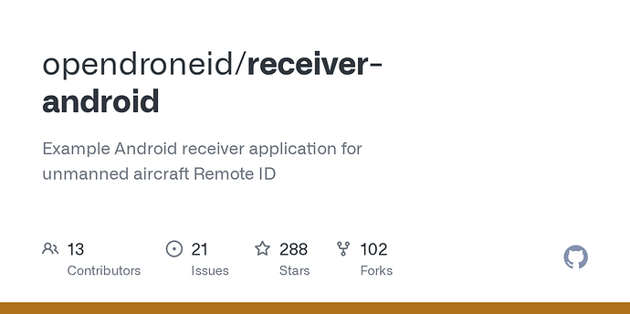

First up, the original (open source) source code from the “Open Drone ID” app is available here for anyone that wishes to have a nosey or a play:
Example Android receiver application for unmanned aircraft Remote ID
Which when compiled will give you a basic app that you can use to see the location of the drone and the location of the operator.
If you don’t have the tools/skills to compile your own Android app, there is a compiled version of the app here:
