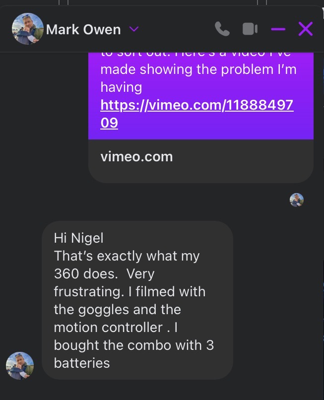

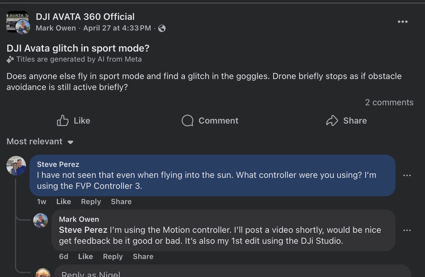

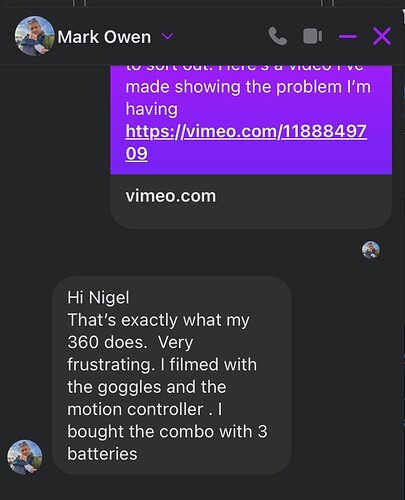

I’ve posted in a couple of A360 Facebook groups and had 3 more A360 owners saying they had the same thing. I also found this FB post from 10 days ago and reached out to him

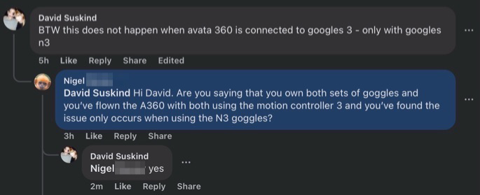

A couple of times now folks on the A360 Facebook groups have said this is a specific problem to the N3 goggles and not the goggles 3.
An update. I’m still in the process of discussing this with DJI and sending them flight logs. But it looks like more A360 owners are running into the same issue: https://fb.watch/G_HiqeuJHj/
I saw that FB post after reading this thread and I wondered, if it was going to be a common issue.
