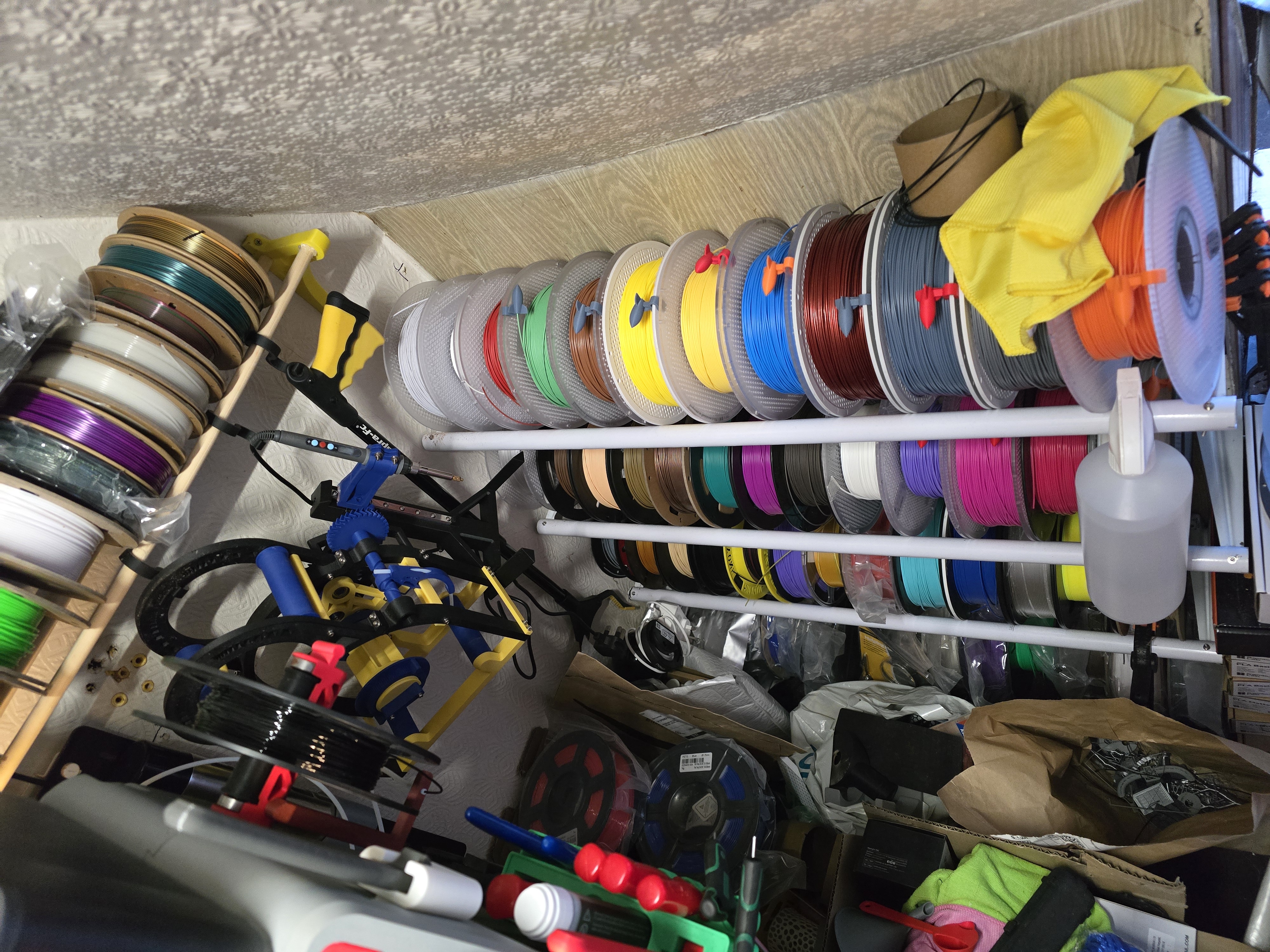

had mine since July 1st last year and it just works, been in the open all the time, I ordered a 500gm and only use it when needed, it’s there on the side to load as and when I need it
Love your setup @yorkie9668 . The AMS more for storage/easy swap, or you actually multi colour a lot? They great for just having your most common in there. You can get up to 4 can’t you, and have 16 on demand :slight_smile:
I use the 2 I have for multi colour and like you said just to have many colours available to me, my girls bought me the 2nd AMS for my birthday in June, it’s great having 8 colours at your disposal
Getting a right old collection of different colours now too
But never the one you really want, right?
:rofl:
