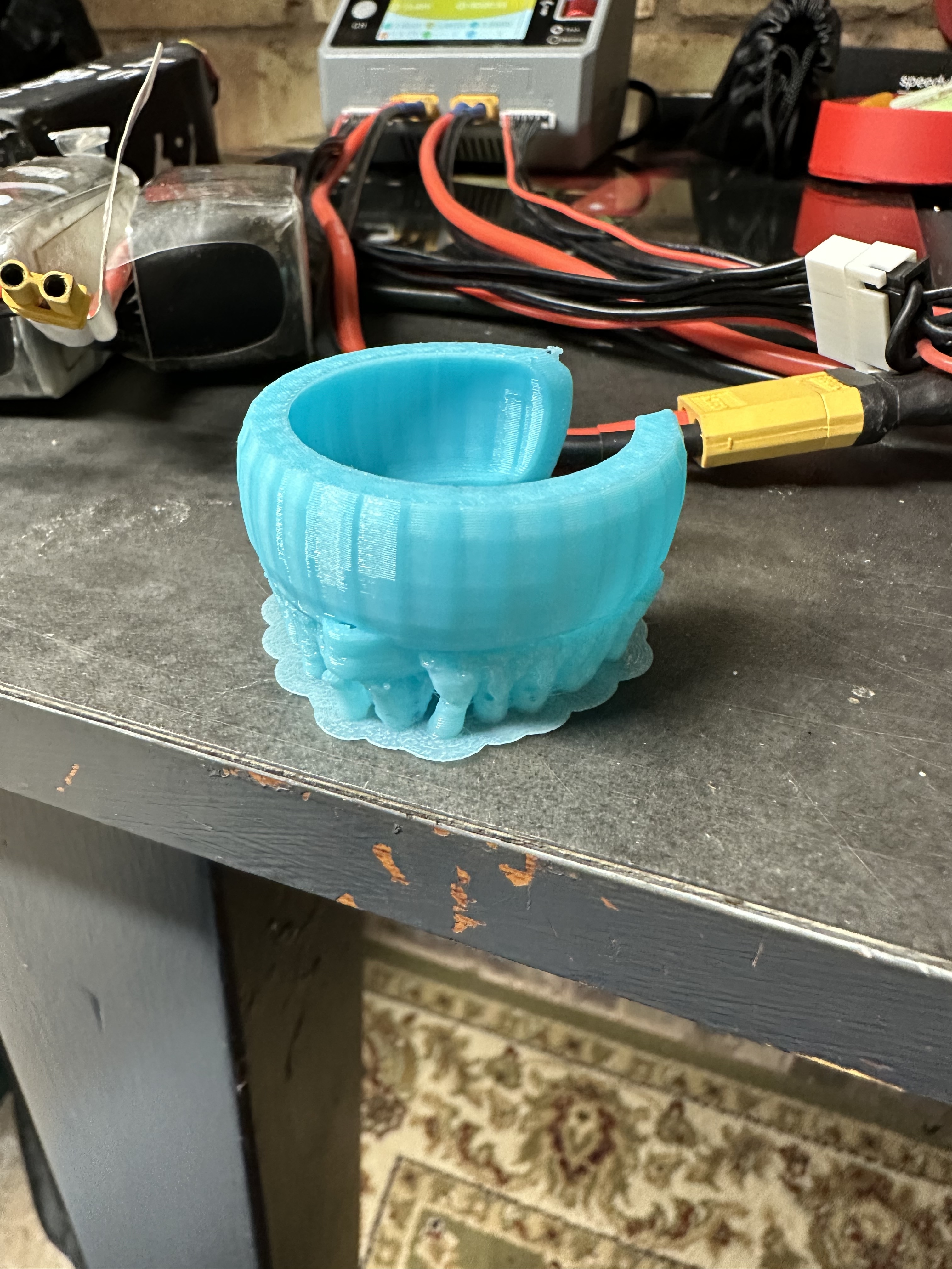

Well gave it another shot and turned on the support option and ha presto it worked. Maybe not the cleanest print as I’ve brought some off eBay in the past and they are smooth…
But with a bit of tweaking I think I can improve it :+1:t3:
What you think ???
You’re welcome
As long as you’re happy with it in the end… but may have turned out better if the filament was dry.

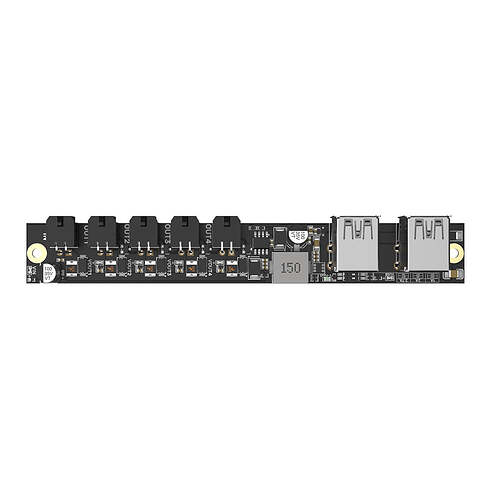

Ordered including a light bar to get free shipping, I’m very keen to see a saving of 50W printing ABS and ASA,
I have both of them now, not used the smooth one yet but believe me the Textured is out of this world, you won’t be sorry mate
I ordered the rear USB hub, it has made available 4 USB slots for the internal lights etc, but fitted it to the left of the back above the power button
Should have browsed a bit more, missed it… :laughing:
