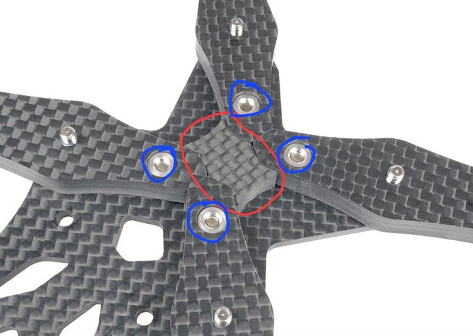

This is my assumption too but Ive been thinking today and what if you had the arms on a single pivot point but clamped between to carbon fibre plates (to stop and up or down movements) and then at the centre of the frame where the arms meet, have a kind of rubber stop/wedge to absorb some of the impact force to help reduce arm breakages

So to visualise the below is an Apex frame that has a carbon fibre wedge in the middle where the arms meet (circled red). What if that wedge was some kind of rubber and the screws circled in blue were removed?
just go titanium arms like @notveryprettyboy ![]()
Haha yeah I get you mate but would the setup above cause any extra vibrations?

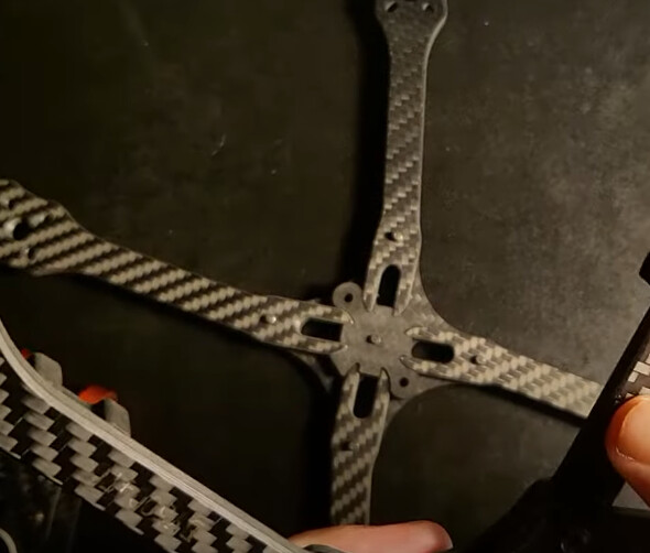

That does sound rather like my Beaver frame… There’s a pad inside where the arms are clamped… they say it’s optional and it is incredibly thin…
Dont suppose you took any photos while putt8ng it together Richard?
Pad shown at 31:41
Yeah thats exactly the kind of thing I mean. Is that a rubber pad?
I think it’s a very thin foam pad.
Ah sorry the white pad is foam… the black one is carbon.
So close to what you mean. But not 100% there.
I wonder if something similar but of rubber compound would work to take the sting out of big hits ![]()
Both apex and beaver have similar designs. Screws in the thick areas etc. I suspect the two fork part to the beaver arms might allow flex where the screw in the apex will just have a crack? Especially considering those push in nuts, which will have already stressed the carbon just by being put in.
The pad will help a bit. Both screw under pressure.
I may just be being a fan-boy, but the beaver design looks like it might have more give in it already… give that will bounce back, where the apex will just crack.
