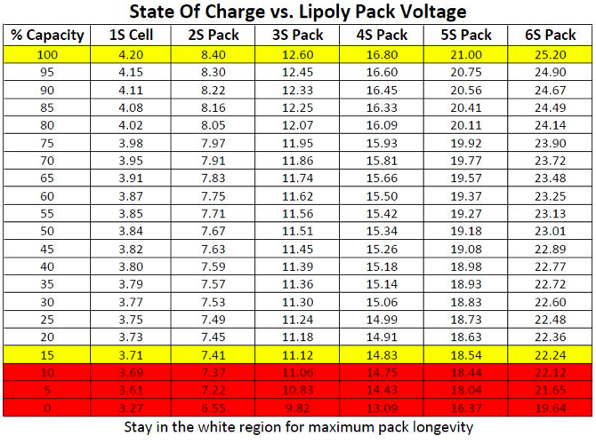

I would advise against leaving LiPo’s at 8%, as this could shorten the battery lifespan. See the the table below:

Cheers mate thank you will charge them back up to about 20% until I’m ready to get some flying in
