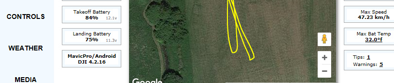

All his flights have 32F = 0C = no data. :wink:
Edit: Change to Fahrenheit and mine are all 32F! Problem solved!!! #Not

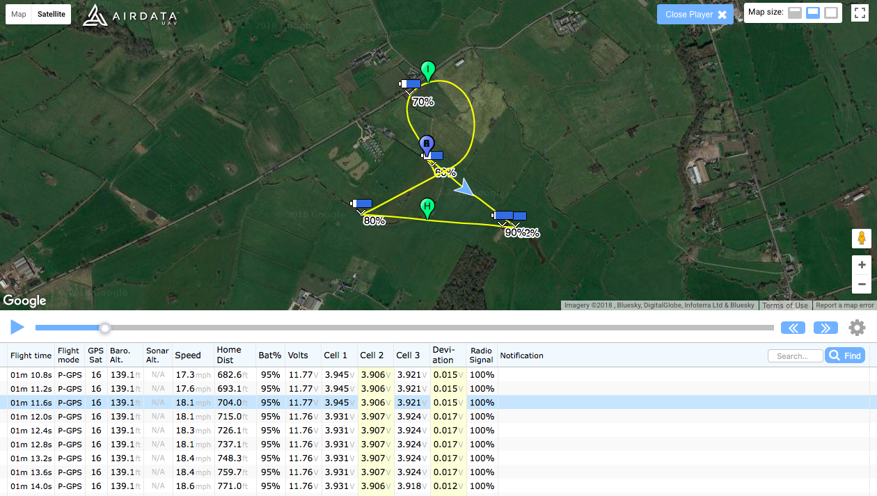

There are two d/ls from PhantomHelp Viewer … one simplified (no temps) one “verbose” = everything = does have temps.
That screen shot is for a Mavic Pro, not the Air?

Shame this detailed (re)player doesn’t include temps eh?

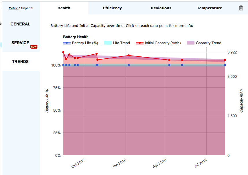

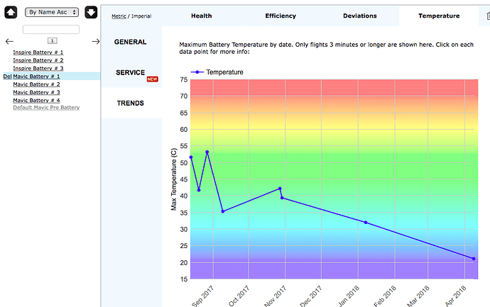

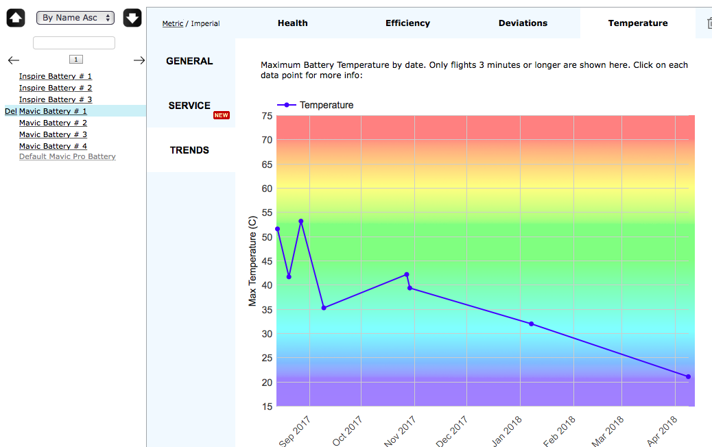

I also thought this graph was a bit weird?
Potential red herring though?
But you can download the CSV from AIrData that have the temps … if they existed.
Don’t get that graph at all.
Me neither…
But it’s more colourful than this one:
:man_shrugging:
Yeah as per one of your above posts, the CSV for the 0.00C flights simply shows the 32.0F values.
