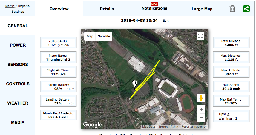

This flight, with 4.1.22 and battery temp:

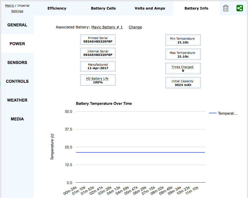

I took a closer look at the battery details for this flight.
It flatlines…
21.10C from start to finish. That NEVER happens:
So the one flight I thought had captured battery temperature, actually hadn’t :frowning_face:

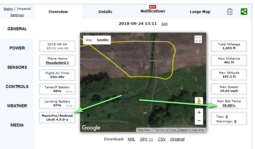

Just to add confirmation to the confirmation, this is definitely a GO4 bug as my last few flights have been with Litchi and sure enough, every single one of them has battery temperature data :+1:

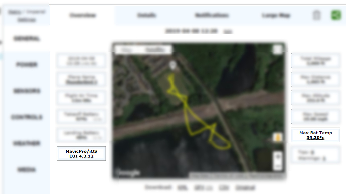

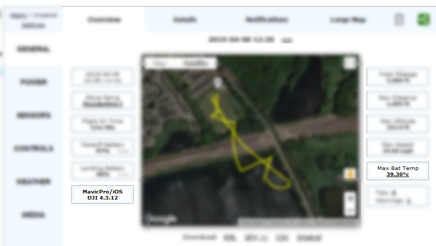

Flew (offline!) with my phone today while my CSU is out of action, using the latest iOS GO4 v4.3.12 :scream:
Spot anything? :smiley:
When did this get fixed? :thinking:
(MP fw is .700 still)

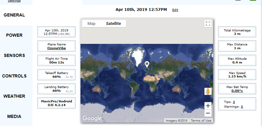

Ummmm …. I know it was a short flight, but there were two other similar flights, and no temps reported.
I recall that originally you “sometimes did log them and sometimes didn’t” for no apparent reason.
I think you manage to get a “sometimes did”.
Will be interesting to see if you have them back permanently.
Maybe they re-introduced the bug in .14 :rofl:
