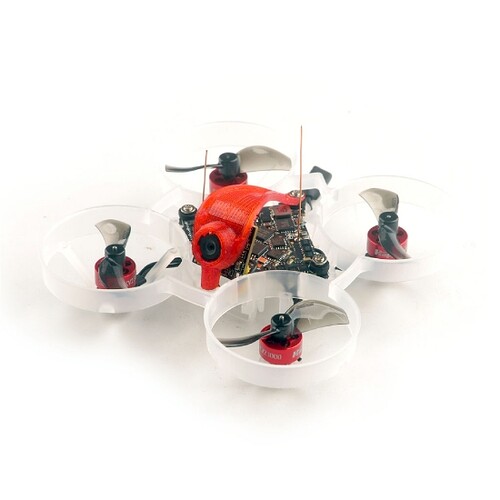

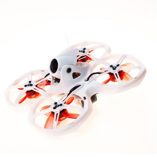

Nope, they’re the best, lol… Tinyhawk you can use 2S batteries as well as 1, which is better outside, not 100% the mob6 works on 2s. The mob6 is the goto for FAST FAST racing, I feel the TH2 is more solid for learning and bonus can use twice the power for some outdoor flights! Either way, both are good :slight_smile:
Mobula 6 looks like it’s great to fly, however 1s won’t do it for me. I’d rather a 2s to get an extra minute or so of flight time, also meaning it can go outside of it’s not windy.
Is the Tinyhawk 2 better than the mobile 7 in your opinion
I have a TH2 (and a TH S before hand, though sold that), a BetaFPV meteor65 pro, and a moblite 7… I never fly the moblite 7… I do like the meteor 65, but for a newbee I think the THII’s are more solid, and EMAX’s tunes are spot on!
You can fly 1S outside as seen here…
Issue with the Meteor65 is the cam angle is fixed (I’m sure can 3d print a new canopy), and it’s a high angle for a new starter!
The mob6lite and mob7lite I’d ignore as they a little more fragile.
I think the “pro” racers use mob6’s, but they also probably upgrade everything on them, and they’re great whoops, but a good solid platform (survives so much bashing), you can’t go wrong with the Tinyhawks (never flown a 3, and boy they look expensive!)

Yeah no wind, it’ll work outside, a 2S will do better (as will a larger quad), the TH II is 75mm, rather than the mob6/metoer65 which is 65mm, so it’s slightly larger, so slightly more stable. Ultimate speed…

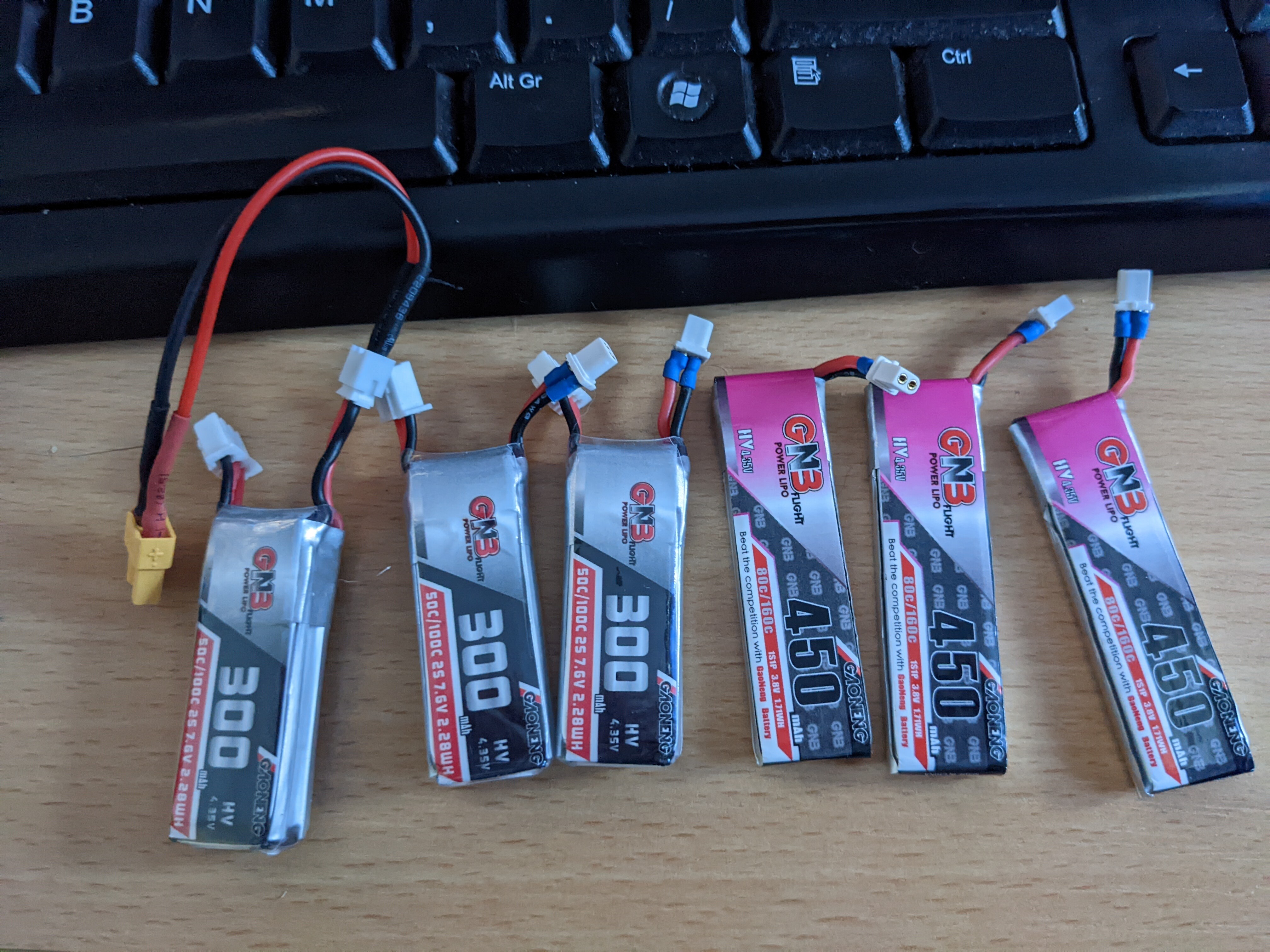

Not sure on battery like, but the 2s does last longer, it’s more you go faster, cope with the wind with a 2s rather than time. you don’t put 2 1S’s on, you get a 2s battery. photo below…
2S on left (with balance leads), 1S on right. You end up with loads of them, lol

You can’t go wrong with a THII, great learning, and it can go faster than you can probably control any time soon! Possibly ever!! But I’m not a fan of my moblite 7 (possibly my flying skills!) the “lites” I’d ignore in the mobula series starting out!
Make sure you check the “radio” tech it uses, think the THII is frsky, but not 100% sure!
Ok thank you, TH II is probably a more solid option then.
I’m sorry but I’m a little confused, the voltage on the 2s looks bigger but the mAh is smaller, does this mean that it has more power but less flight time? or maybe more power means it uses less mAh per second?

Oh don’t get me onto electonics and calculations. You probably get the same, but you get a LOT more power. I actually have around 20 whoop batteries, varying from 300 → 650mah. You add weight more mAh. So technically I guess you got 600mah of 1s with those 2s 300mAh, but it’s slightly heavier!
