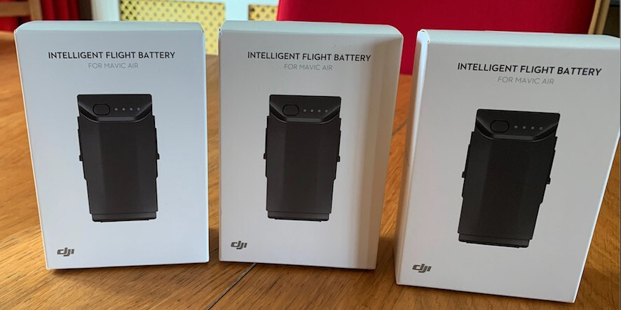

This latter resulted in DJI agreeing to replace the batteries. They came fairly quickly and in consumer retail boxes:
They look and feel brand new, with fresh DJI stickers on them, and have a marking:
âIN TW RUâ, perhaps implying Indonesian or Indian, Russian and Taiwan markets?
Also, they appear to be fairly new - produced in March 2021?:
So: some kudos to DJI for replacing them after 30 months, but perhaps they could admit to a production error since this problem is so widespread?
