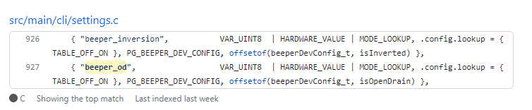

I’ve never found out what beeper_od does…

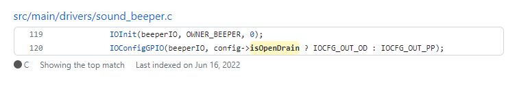

“Open Drain”
i.e. the way the output transistor is wired…
Definition of Open-drain | Analog Devices.
So how the GPIO is configured for that port.
Looks like PP is “Push-Pull”

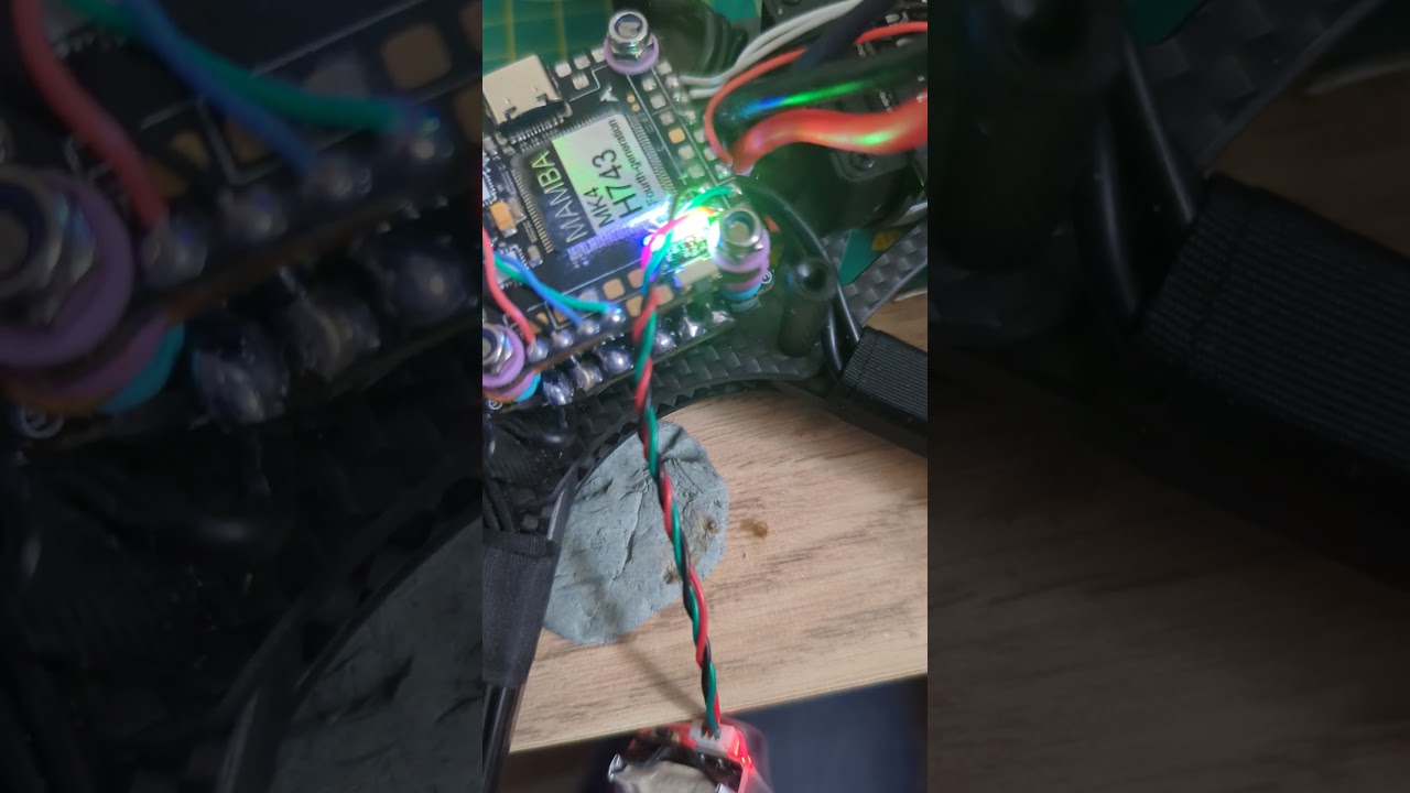

Right checked 4.3. This did work on bench when using 4S batteries last week. Can’t remember when I updated to 4.4.1 whether ti worked at all, and seems to be an issue with 6S. I’m pretty sure summit’s blown. It’s just seems to be constantly “live”

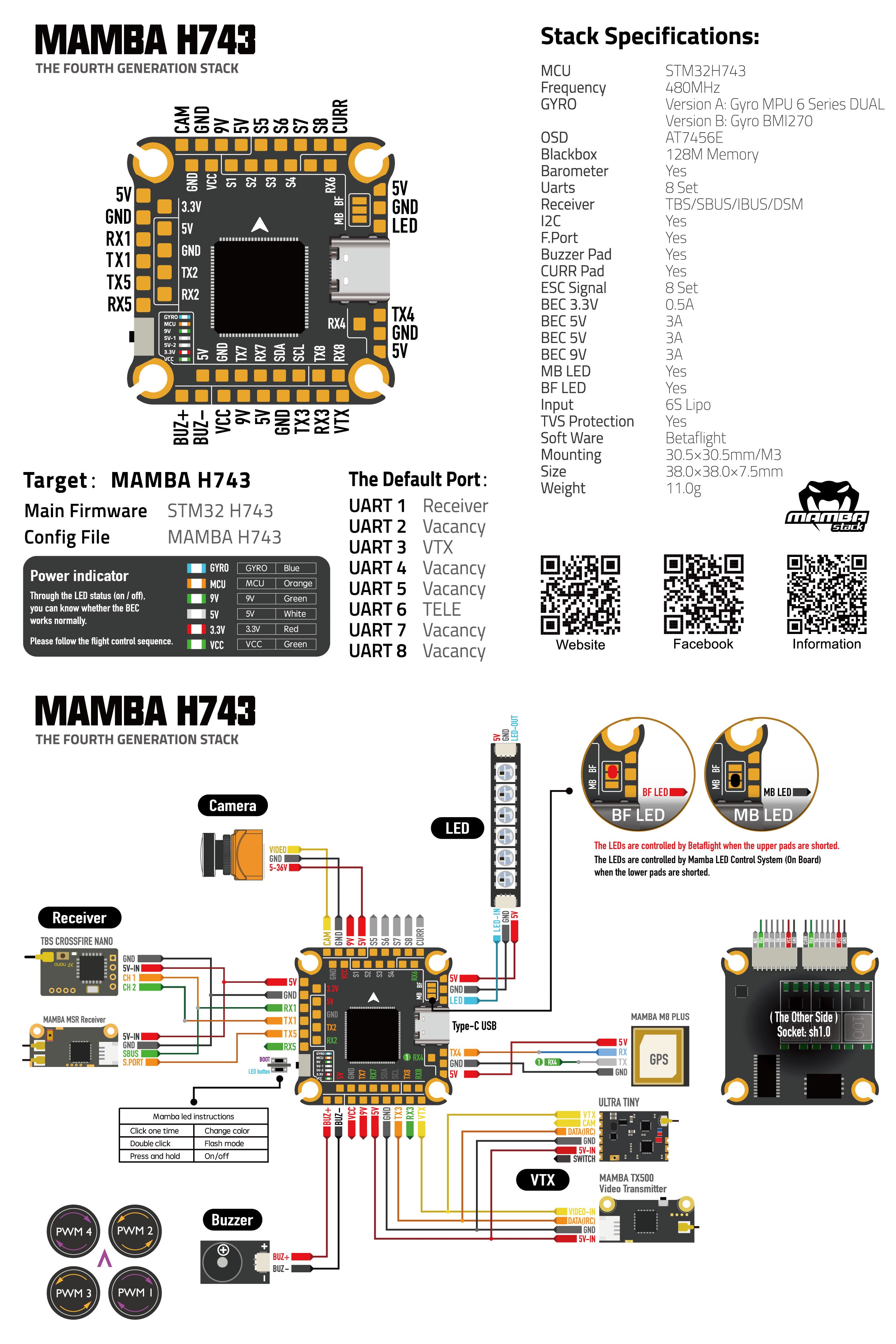

I did obv have issues original (hense this thread), though I may rewire to the 5V instead of B+ when I shove on the GPS later. Just don’t wanna fly without a buzzer!!

yeah measure v from b+ to gnd and b+ to the b- and constant at 5V (well just under).

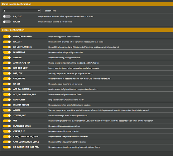

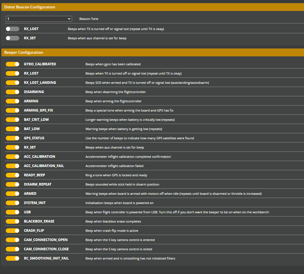

Interestingly just d/c the buzzer and tried to just “dshot” tone, and the motors aren’t “beeping” when using the Radio…
RX_SET works with DSHOT, missed that, all good there.
Gonna resolder it all when I do the GPS, it’s weird as seems hardware with the B- port. Gonna try another cable/resolder. Cheers for the assistance @Yith
Will do that tonight
Well resolder and put the 5v line into a 5v pad instead of b+. Weird. No signs of shortage etc and the B+ and 5V pads are identical i.e. both give out 5v lol

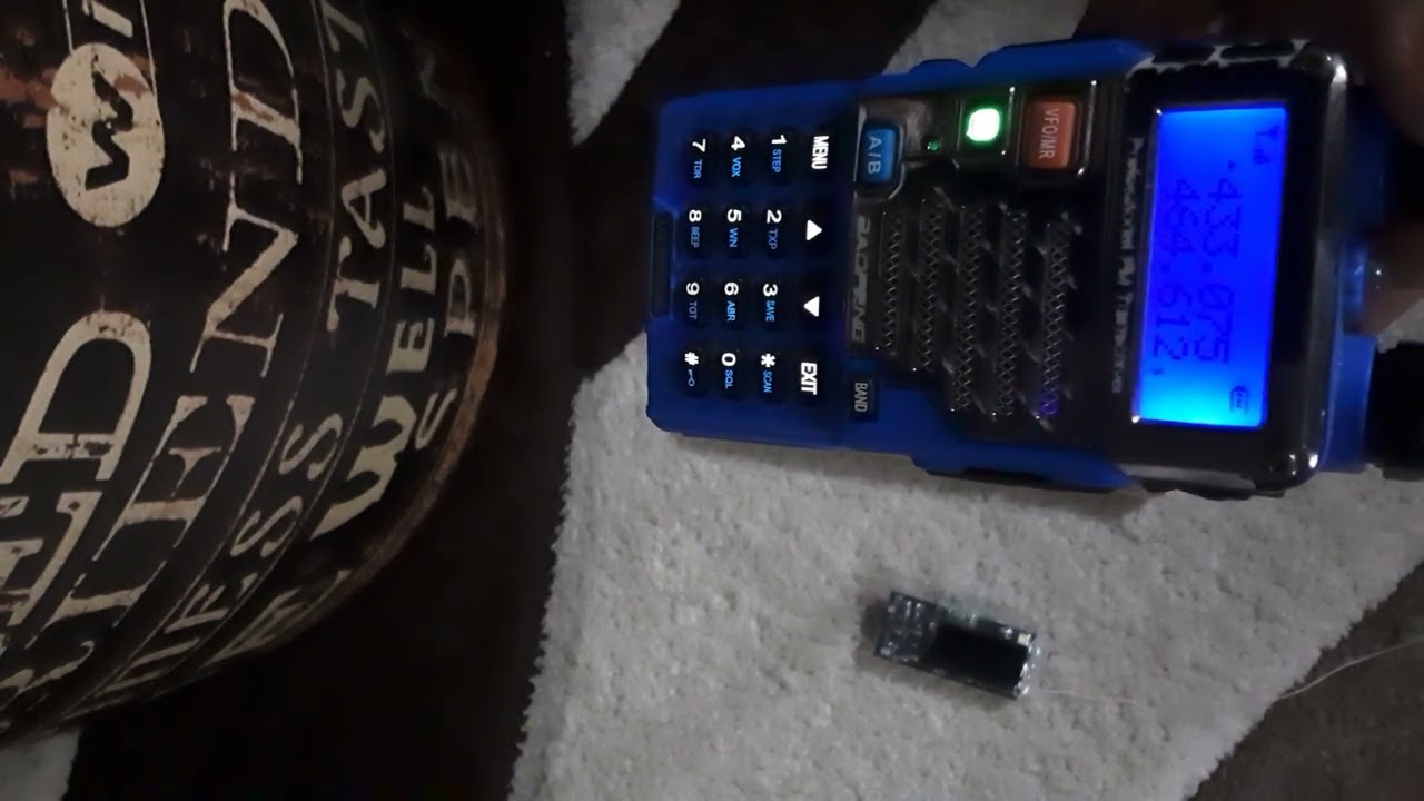

tBeacon Onyx the ultimate lost model/drone/rocket radio locator beacon. Long-range, GPS enabled, voice reports $60 + $10.53 / £55
Use walkie-talkie at 433.075 MHz. Trigger the beacon by sending a calling tone (Tone-burst, 1750Hz, check the radio’s manual) for 3-4 seconds. Replies on walkie-talkie with GPS co-ordinates.
