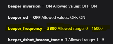

Hmmm… could it be the frequency?
Yeah, non of that, and it’s the INSTANT you connect the Lipo. Constant and LOUD!
Not tried that. you using 3800 on yours? Same kind of buzzer with Lipo? I always thought these were set to 0… Will give it a go.
