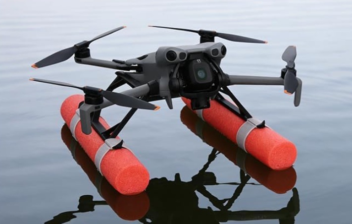

I have the whole GPS and updating home point stuff covered. I am also looking to buy the image below from Amazon as it seems a no brainer. Take off I have no issue with. My only issue with landing is only around how I make it land whilst I am flying it in synch with the boat? If I fly over the deck and the drone works out that the surface is stable - how do I then land it as I will presumably still be flying it forward / sideways to maintain position with the boat - or does it work out that the ground is now stable and hover over the surface in a fixed position? Reminds me about the thread about what happens if you take off in a fast moving train carriage…

If it is anything like my mini 4, the landing sensor will make it climb when it detects it is above a moving surface. I think you’d need to do a grab and flip landing, and that might be hindered by floats.

Last video I saw the guy grabbed the float / frame holding the float and flipped it over. Worked a treat. Had a lanyard so could drop the controller. Best method I have seen so far.
