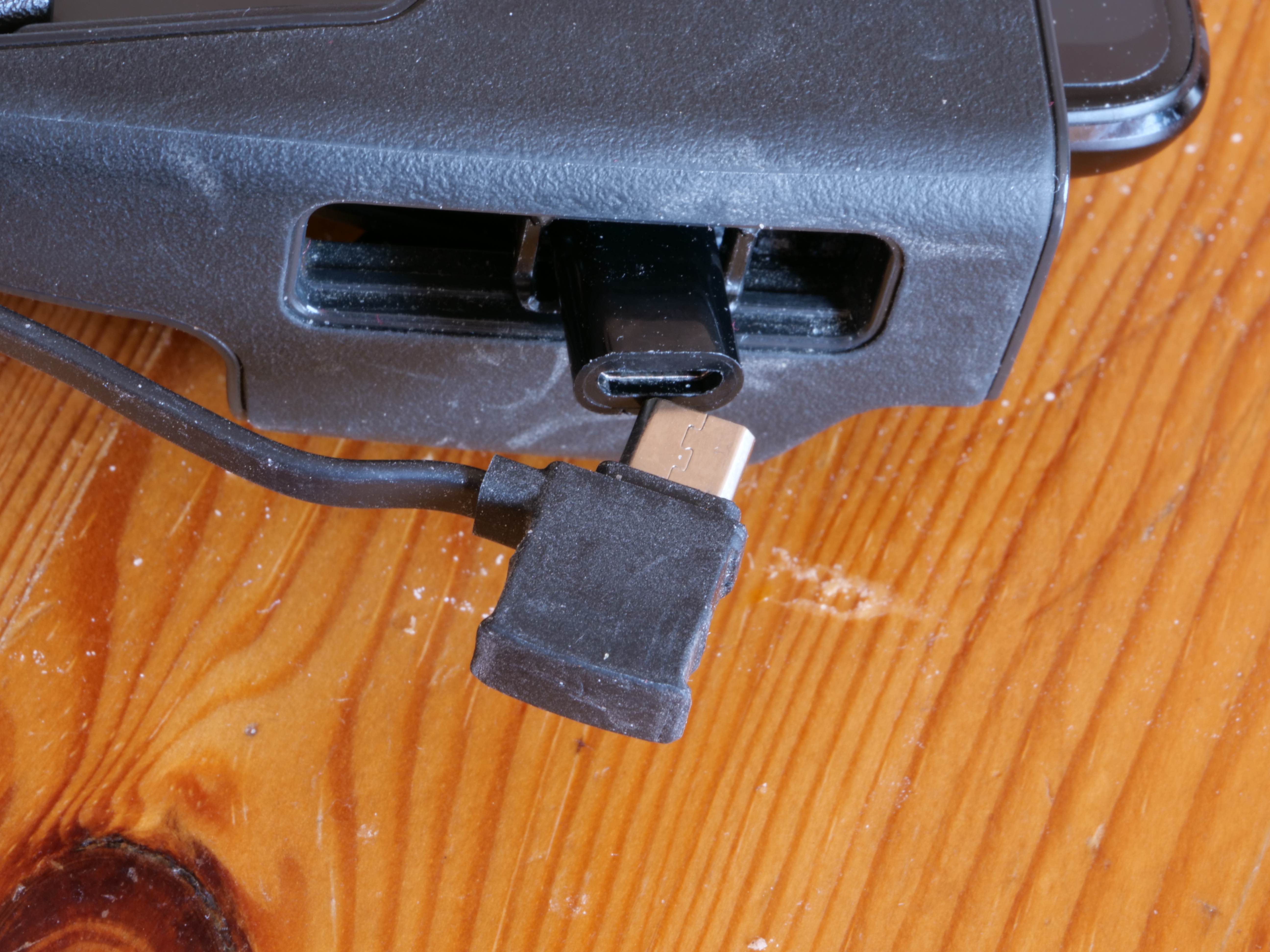

… what I have discovered, that was REALLY useful when using the OP6 phone, the “Android buttons” for which are right at the very edge of the phone and hence hidden in the RC’s device holders, making closing an app a right pain …. there’s another way to swap apps that seems far easier.
Easier if you’re using the large USB port on the RC, but I still use the side port and want to plug/unplug into that as rarely as possible - but, without closing any apps, if you unplug the USB cable and plug it back in, you get the pop-up to chose which app you want to use - and bingo! No issues (with 4 flights of about 10 mins - switching back and forward about every minute) with the app not in use lurking in background. (I guess basically what @PingSpike was suggesting - but without even having to close an app.)
Since my “drone” phone is old micro USB, and my new phone is the new USB-C, I was using an adapter between the DJI micro usb cable and the new phone, so disconnecting from the adapter was really easy.
