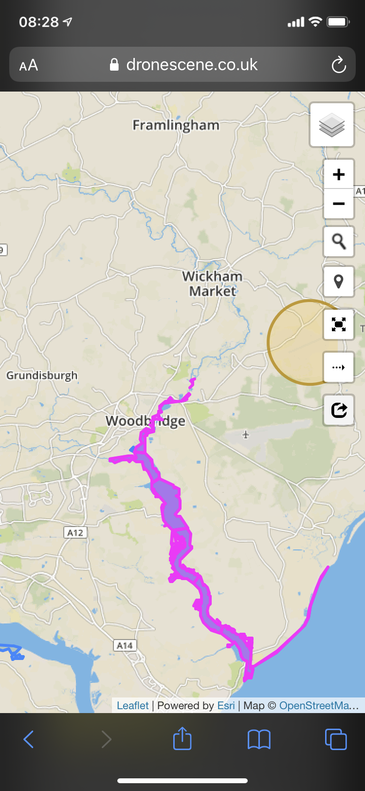

I’m going to Woodbridge, Suffolk this weekend and have been looking at maps to try and work out where I’m safe and legal to fly around there. In particular, I was thinking of trying to take some snaps around the river Deben. However, I’ve noticed that this is kind of near MoD Woodbridge airstrip. In fact, the river itself appears to be 5km almost exactly, from the end of the runway around about where I was thinking of sending my drone up.
When I check out Drone Assist, Airmap and DJIs Altitude Zone it doesn’t draw one of the restricted zones around the airstrip. Does this mean it’s actually OK to fly nearer there or is it simply that a zone has not been drawn around this airstrip for some reason?

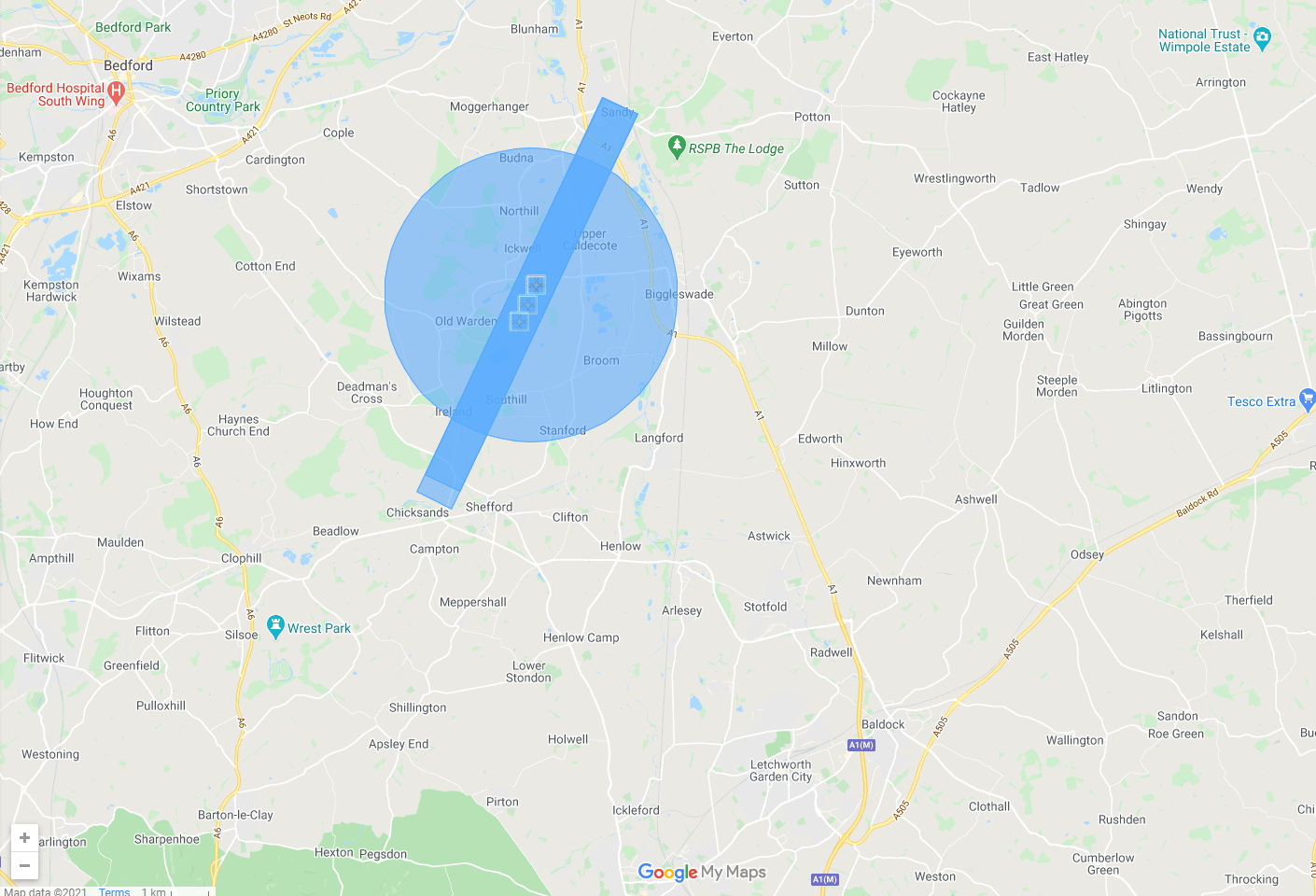

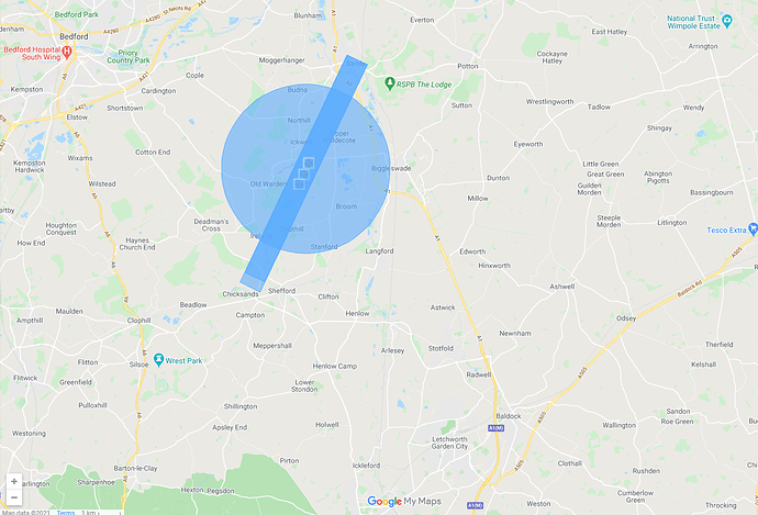

Hi, something that caught my eye was the FRZ circles on the map which I originally understood from the rules were 2.5km radius appear to be disproportionate in size to the runway protection zone that runs for 5km from the end of the runway, i.e. the pan handle should extend 2.5km beyond the circle but the appear to be a bit stubby. went to google maps measuring tool and found the 5km runway protection zone to be accurate (except some apps use the end of the tarmac and not the runway threshold**)
The FRZ at Bristol is approx 4.6km radius*, the FRZ at Colerne is 3.8km give or take.
Hence I’m curious as to how these are defined.
I’d go by the circles on the map as they are the larger of the two and keeps you safe, it’s just I used to fly model aeroplanes from a field that is 4km from Bristol Airport and if I followed the 2.5km rule thinking I was safe, I’d be in trouble because is its within the 4.6km FRZ circle.
  • as measured from the centre of the runway to Backwell railway station
    ** Drone assist uses the threshold, so the Colerne runway protection zone stops at the A46
    Airmap uses the end of the tarmac so the Colerne runway protection zone extends beyond the A46

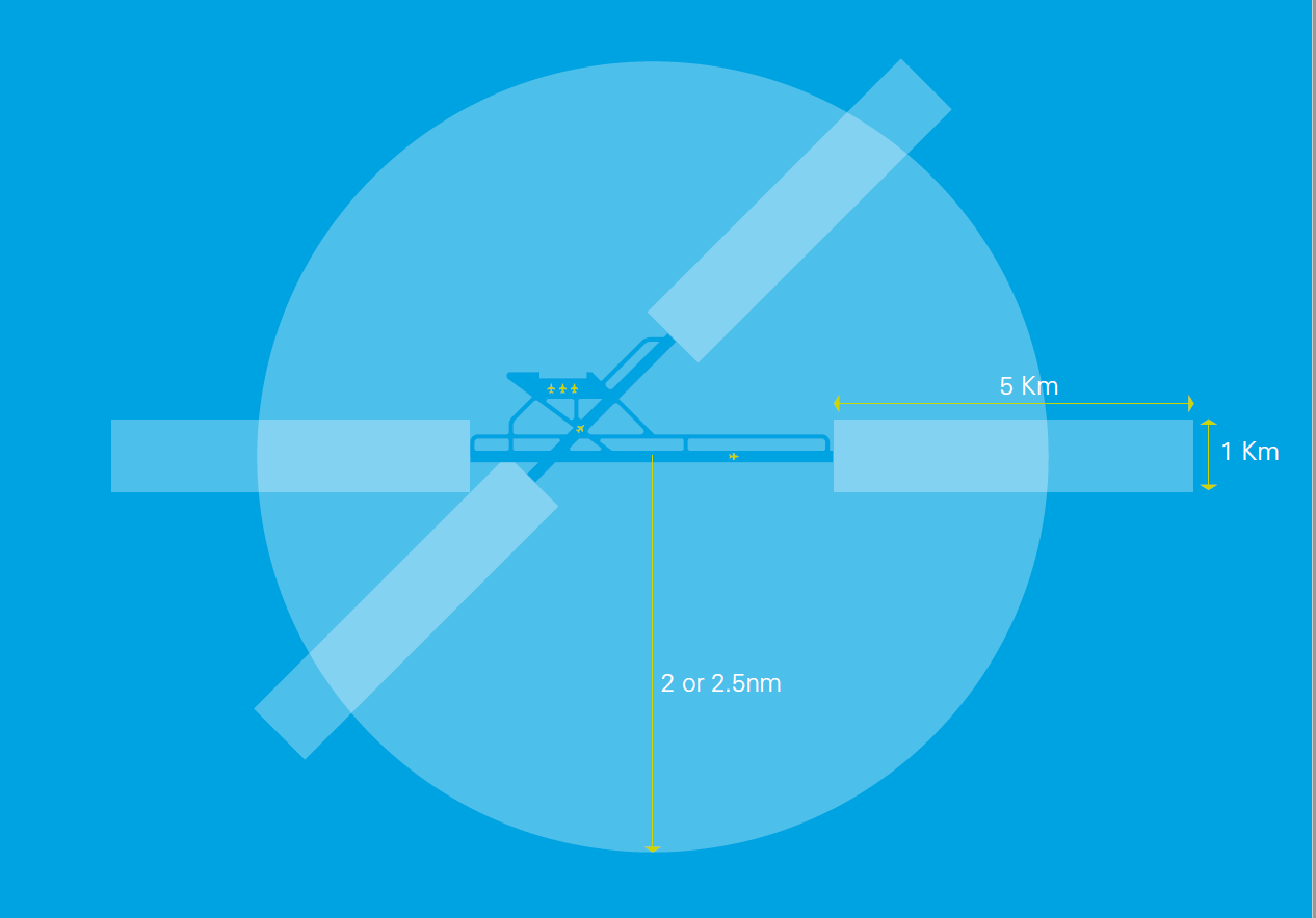

They are defined by the CAA
Flight restrictions around aerodromes
Flights of unmanned aircraft around airfields or airports that are designated as ā€˜protected aerodromes’ are tightly restricted. Unmanned aircraft of any size must not be flown within the Flight Restriction Zone (FRZ) of a protected aerodrome, without appropriate permission.
The Flight Restriction Zone consists of the following three elements:
  • The Aerodrome Traffic Zone: A 2 or 2.5 nautical mile radius ā€˜cylinder’ around the aerodrome, extending 2000 ft above ground level, centred on the longest runway.
  • Runway Protection Zones: A rectangle extending 5Km from the threshold of the runway away from the aerodrome, along the extended runway centreline, and 500m either side- also to a height of 2000 ft above ground level.
  • Additional Zones: In the case where the 1Km boundary of an aerodrome extends beyond the Aerodrome traffic zone, and so would not be protected by it, the flight restriction zone will include a ā€˜bump’ (the airfield boundary + 1KM) to protect this part of the aerodrome.
The exact shape of the Flight Restriction Zone varies depending on the specific aerodrome that it protects. Prior to flight, remote pilots should check to ensure that they are operating well outside these areas.
:point_up: That last para might be the most relevant.
Drone Scene uses the official data, as does Drone Assist … Drone Scene just has far more features.
Ah!, I see from that its 2.5 nautical miles (4.6km) not 2.5km. All makes sense now. The classic problem of mixing units

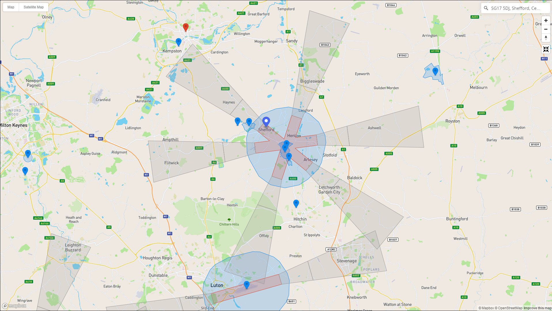

I’ve attached a couple of screenshots that hopefully explain things better. The first is from Drone Safe website showing a FRZ to the North of me. This is correct, and I have no intention of flying in this zone.

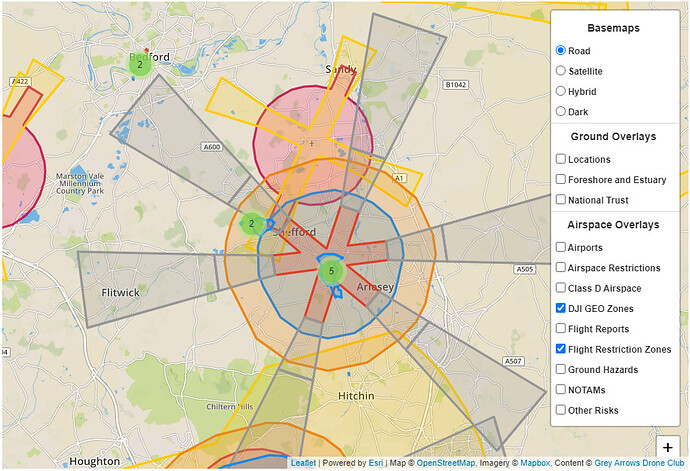

The other screenshot is from the DJI map showing RAF Henlow which as far as I can tell ceased being used in July last year - Flying Info | RAF Henlow | Royal Air Force. Most of my town is in the red section, but I have been able to self-unlock for the blue section surrounding it.
You may find using Drone Scene quite helpful (for viewing purposes) since both FRZs and DJI Geo Zones (and other useful info layers) can be viewed simultaneously. (Data for all layers is retrieved live from source data)
Alas no real help for your fundamental problem of flying within a pointless DJI Geo Zone for Henlow.
I’d guess it’s just a case of repeated attempts to get DJI to unlock … or remove the zone from their data. (Good luck with the latter!)
Ah, perfect, that’s exactly what I needed to see both on one map. I’ll use that in future.
