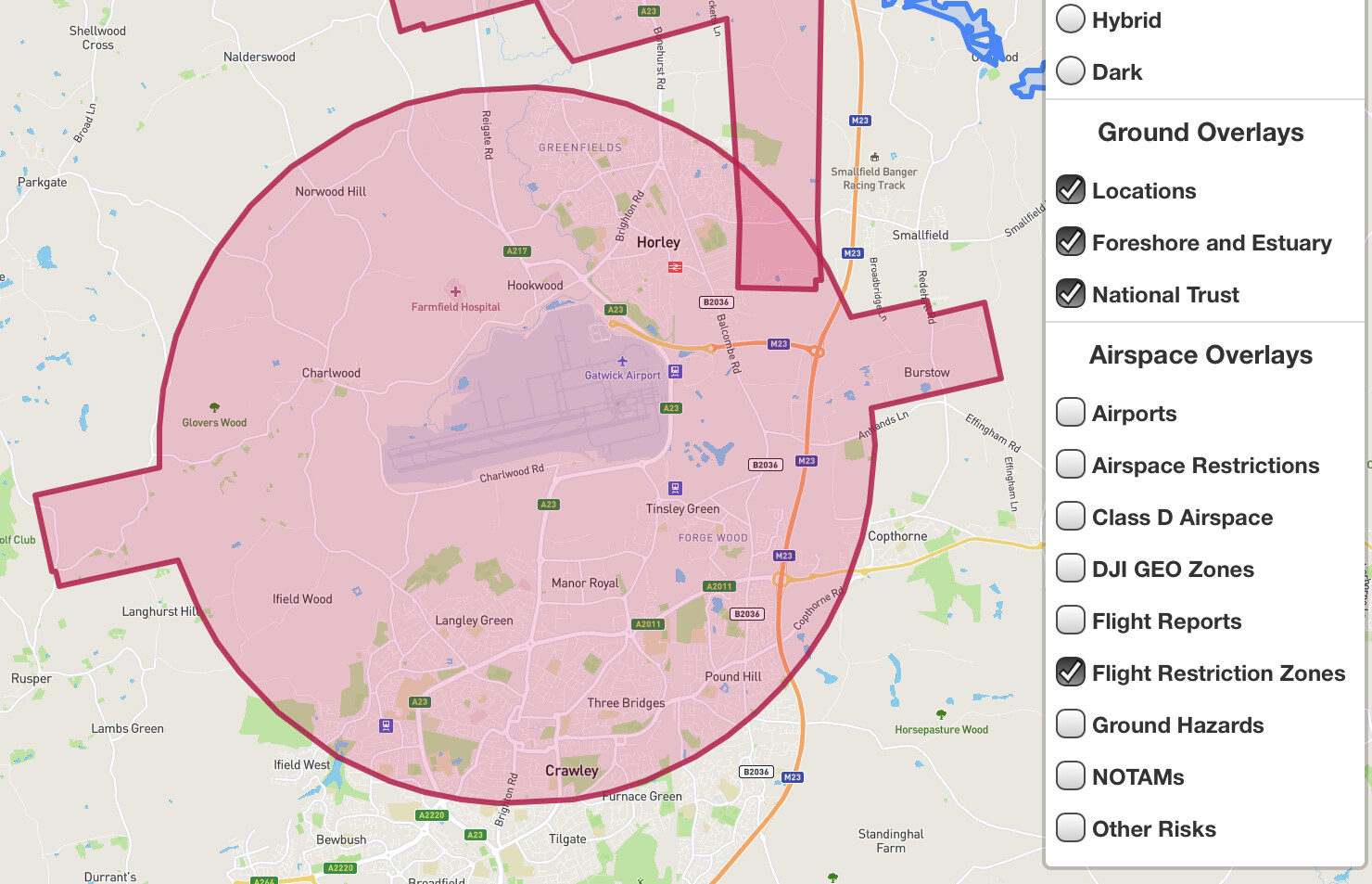

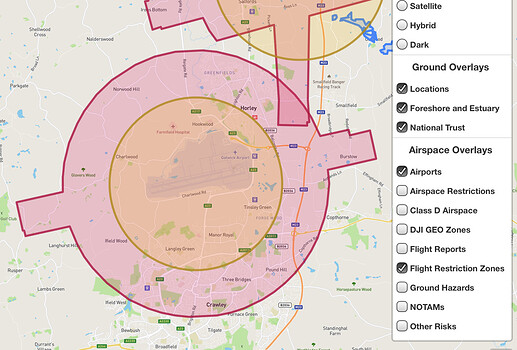

I believe I live inside the LGW 2.5 nautical miles FRZ, however the interactive map on dronescene has 2 circles, i’m outside the inner circle but inside the outer circle. What difference, if any does this make?

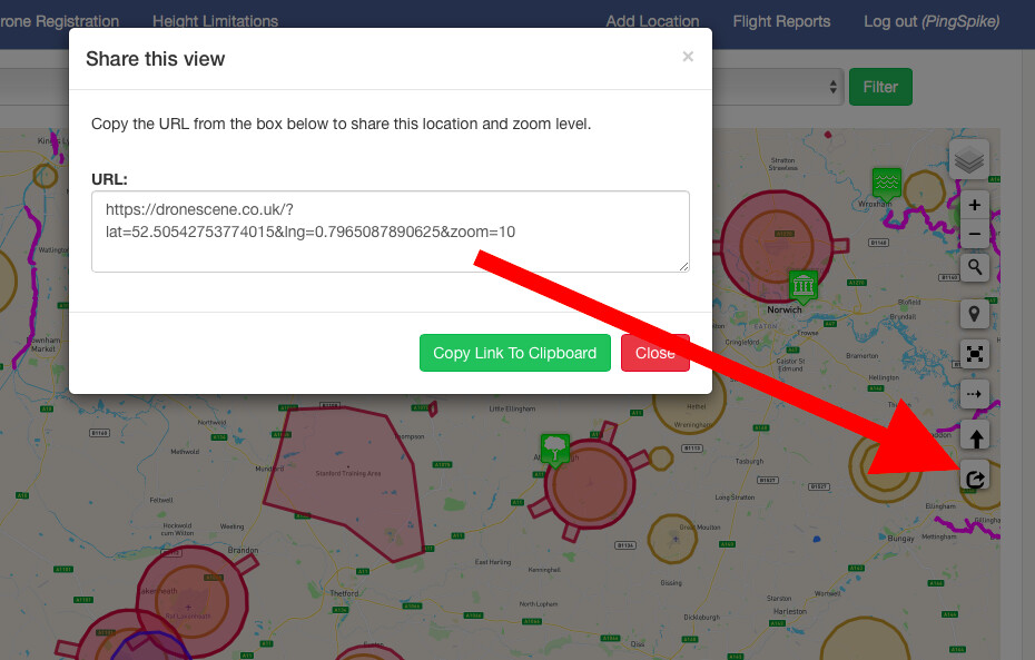

Zoom in to the location in question and press this Share button:
And what layers do you have turned on? :thinking:

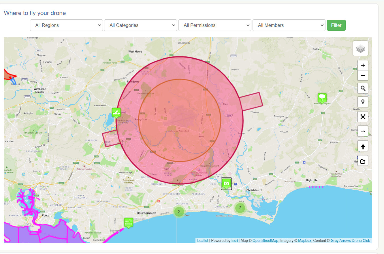

Presume you mean these two circles at Gatwick:
The outer one is the FRZ:
What is the larger red circle witch covers the frz but extends to a radius of about 5miles?
Most likely an FRZ bump. The inner one is the FRZ as measured from the centre of the longest runway. Because Gatwick has a large boundary, an additional km is added to the airport boundary to create the total FRZ.

Here is the link:
I have all layers checked except Class D and DJI Zones.

The outer ring is 2.83 miles from the centre of the runway according to Google maps

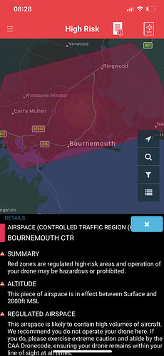

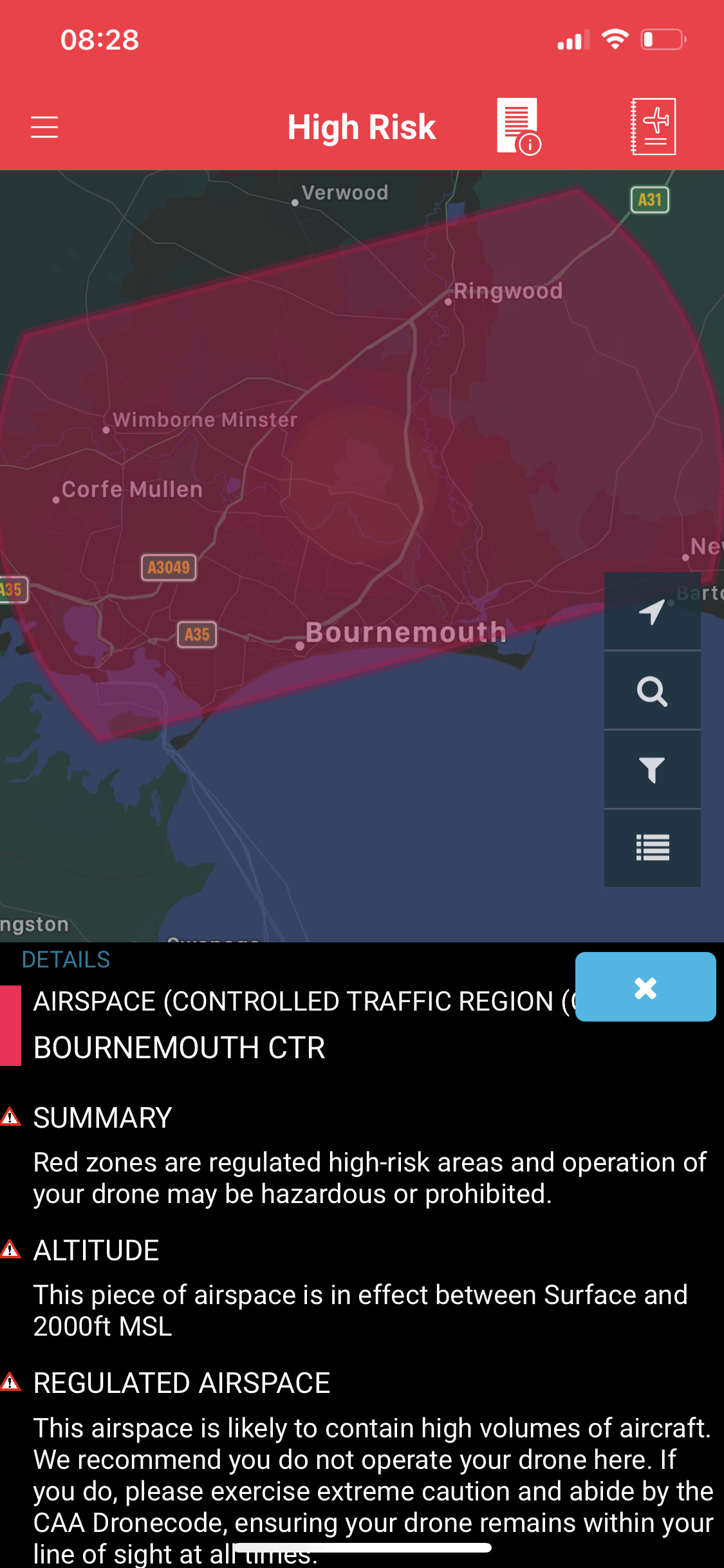

On the DJI App it does not state that this is a controlled airspace but on NATS Drone Assist it states it is. I am assuming I need permission to fly in this zone? It is very confusing! Again, drone noobie here so sorry if I come across naive!

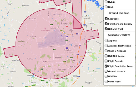

It’s the FRZ you can’t fly in, you can fly in controlled air space as you are under 120M.
Here is the airport’s FRZ.
