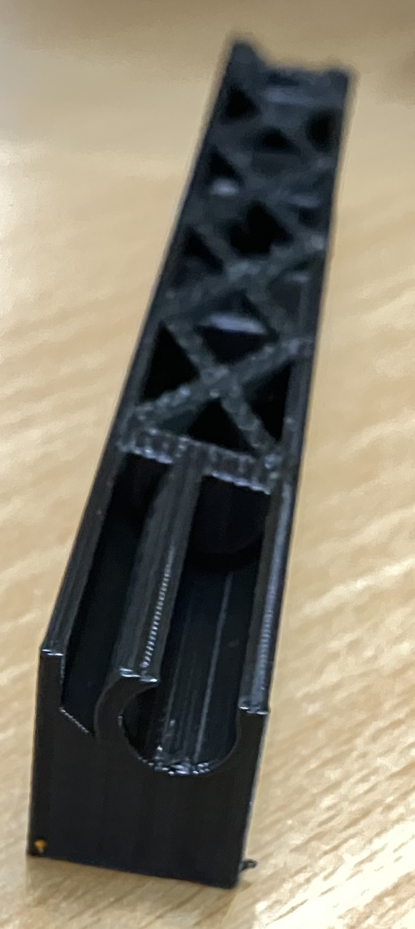

Left hand side, in Black PLA
A right hand side is printing overnight
How does it looked compared to the quality you are requiring ?
They look fine Steve.
What are they like in there of their robustness? Are they pretty solid, no flex etc?
I imagine if there was any to a degree, once they’re mounted against something that would add strength to them.
The other hand printed the same overnight.
They are very solid, no flex or twist at all, it’s a good structural design.
I printed at 40% infill, layer height 0.2mm on an Ender3 S1 Direct Drive
Although I said I’d try in PETG as well, these have come out so well at these settings I see little point in doing that, cosmetically they would look virtually the same anyway.
