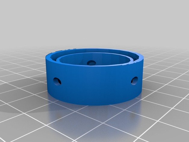

I am looking for a housing, one like this:
Light Barrier
Its to hold a barometer
Its also a light barrier, but I don’t want the hole in the top, but one of the holes in the side to go all the way through, to run the 4 wires
Also, I would need a top/cover, just a flat disc of the same diameter, to seal it once the barometer is inside

It looks like it has an inner ring wall which I take works as an air buffer? Is there a top view you can upload?
3rd time lucky :joy:

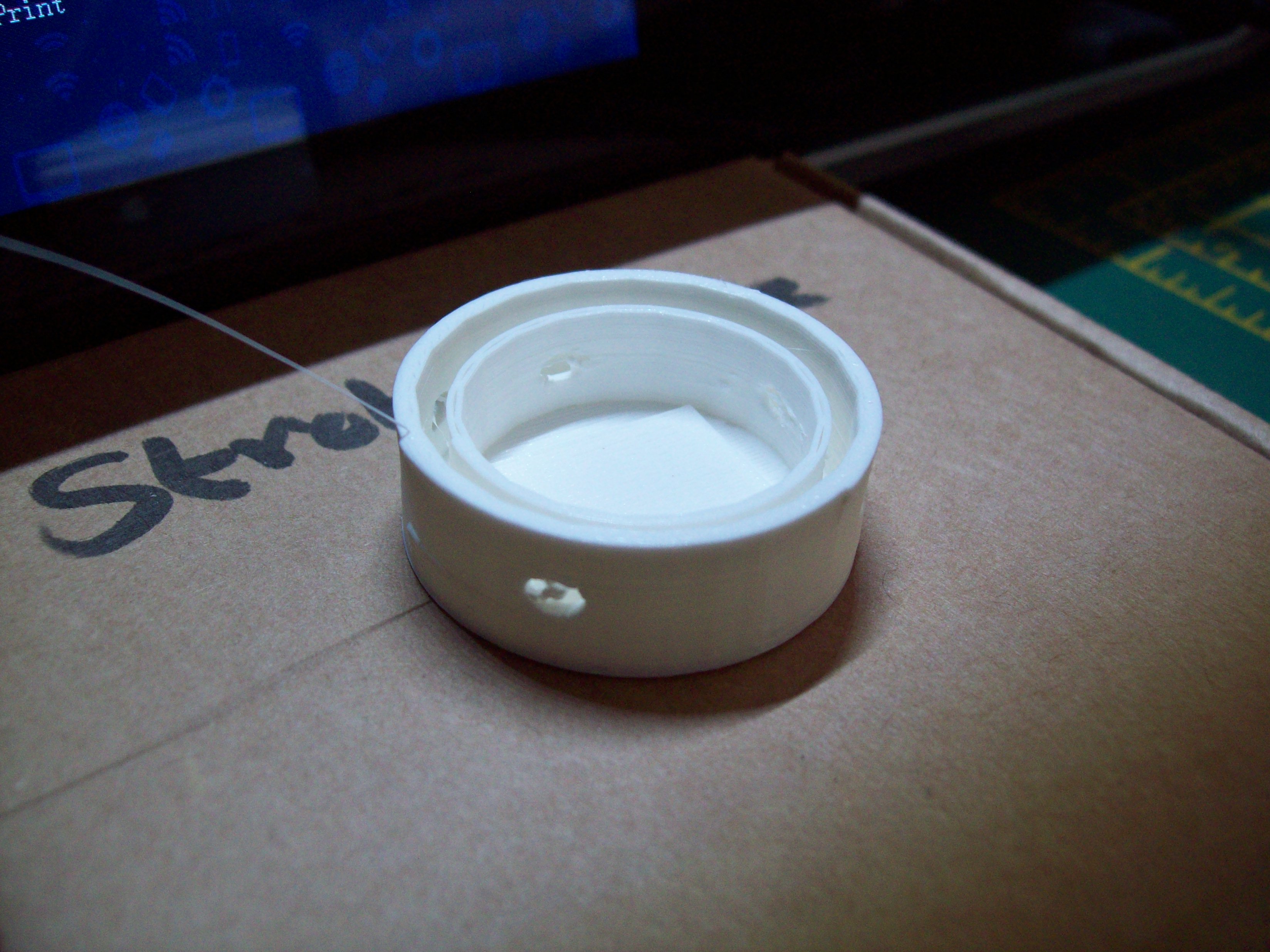

Got it, just looking at it in the slice right now.
The hole you want to go through, do you want it all the way through to the other side of the outer body or just through the inner ring?
Just through to the inner ring so the wires can pass from the inside to the outside. The idea of it, is so the barometer will get the air pressure but is not affected by the light as the light has no direct line to the centre
OK…
I’ll start the print shortly, but unfortunately Autodesk is unable to pick up the inner wall, if you have a set of small drill bits "2mm"you can simply drill out the hole.

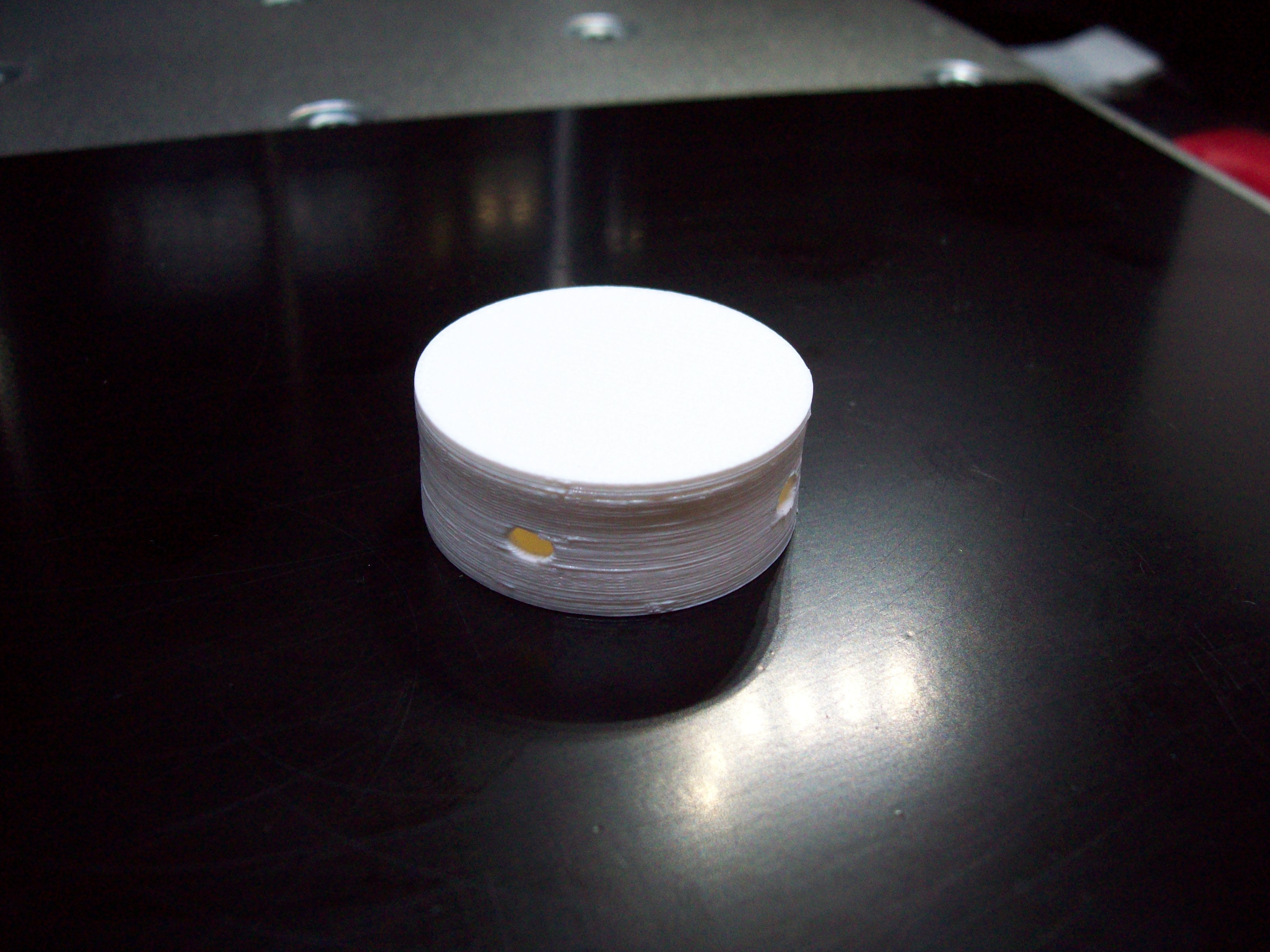

“Done” Hot off the bed, just need to measure for the lid…

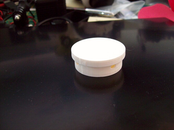

All done…
One thing we didn’t consider, which is whether the lid is an outer overlap or inner plug so as to be flash with the top… :thinking:

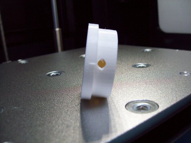

I drilled out one hole straight through the inner wall for you.
The lid looks perfect as it seals the whole housing, I will message you
Thanks Again.

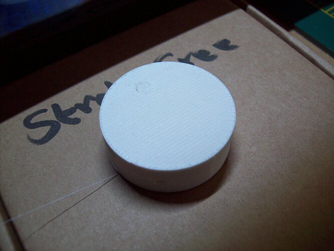

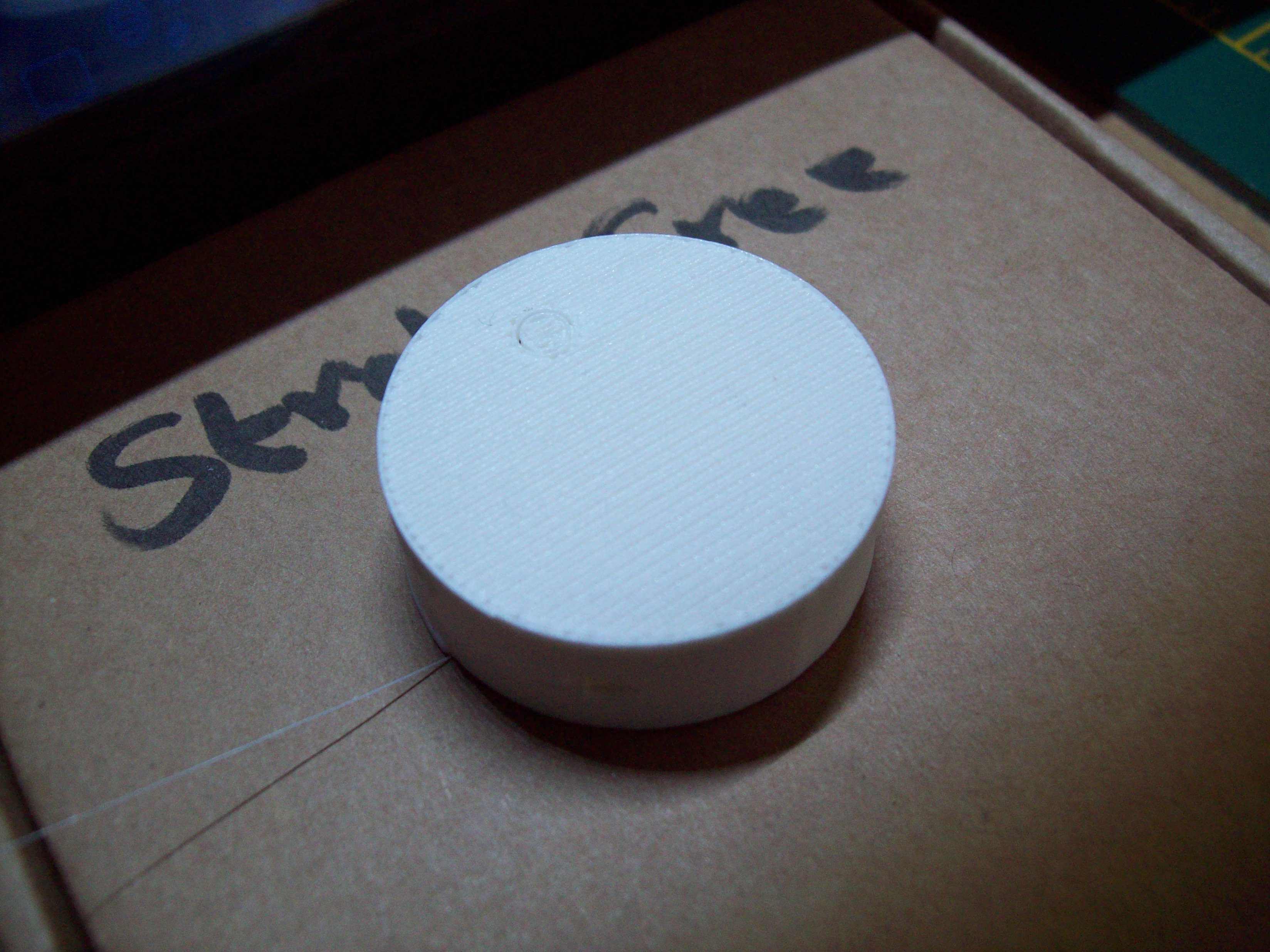

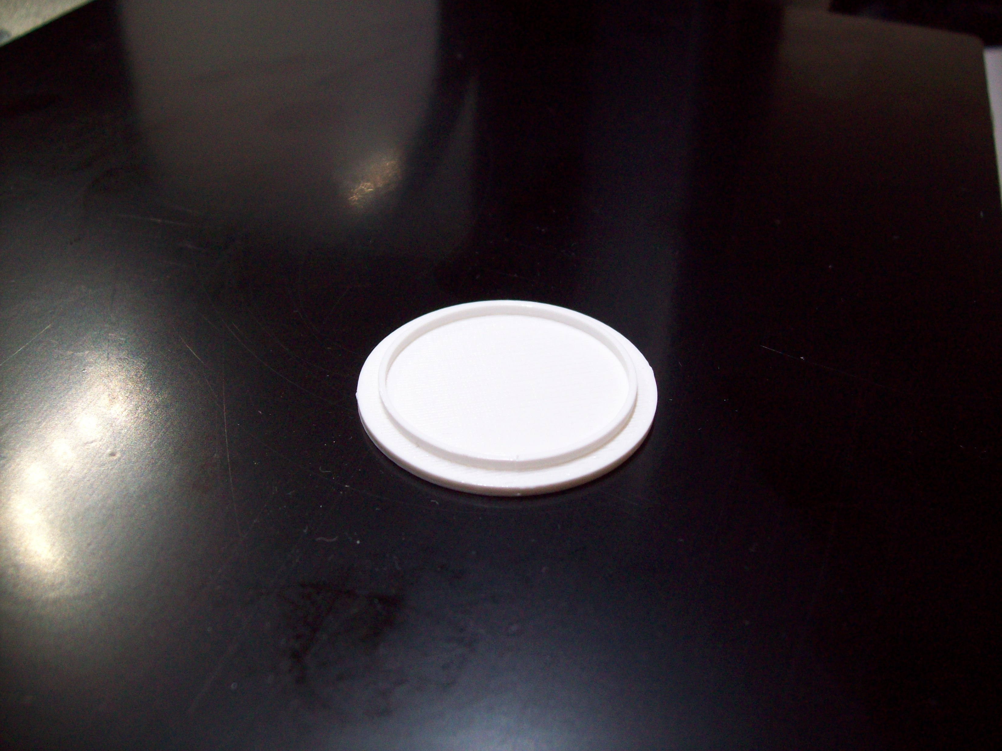

I’m just printing an inner with a lip, I’ll include it so you have a choice of two types.
The jiffy bag fits through the letter box, we’ll see if it fits the post office one, I’ll post tomorrow.
The other type lid…
The filament has absorbed moisture hence the lines, it’s functional.
