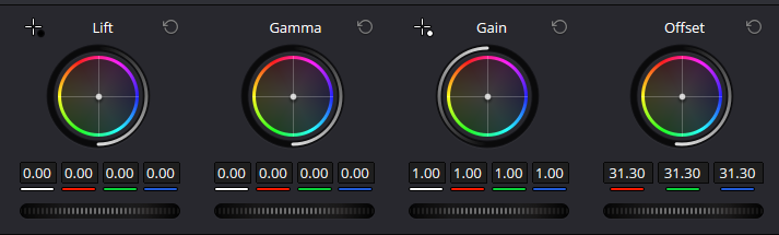

I screen-grabbed the wrong wheels, earlier (they were the log wheels), and the ones you should be seeing are these …
… where “Lift” relates to “Shadows”, “Gamma” relates to “Midtones”, and “Gain” relates to “Highlights”.

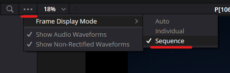

Did you import into DR as individual images, or as an image sequence? It needs to be (or, at least, I’ve found much better to be) the latter - and will appear in the Media Pool as a single icon with the range of image numbers (rather than all 500 separate images) …
If it’s not as an image sequence, you’d need to go to the Media tab, click on the 3 dots at the top-right of the media area, and select Frame Display Mode, then ensure Sequence is selected …
… and then drag the 500 images into the media area.
