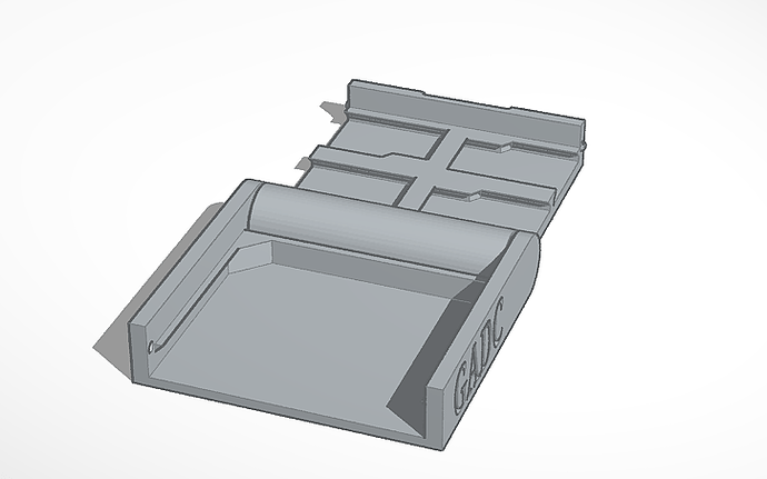

It’s easy and you can design things like this
Diolch - I shall give it a go.
The design you show is way more complicated than I need, but if it does that easily then my needs will hopefully be straightforward.
That was someone else’s design, I just tweeted it :wink:
