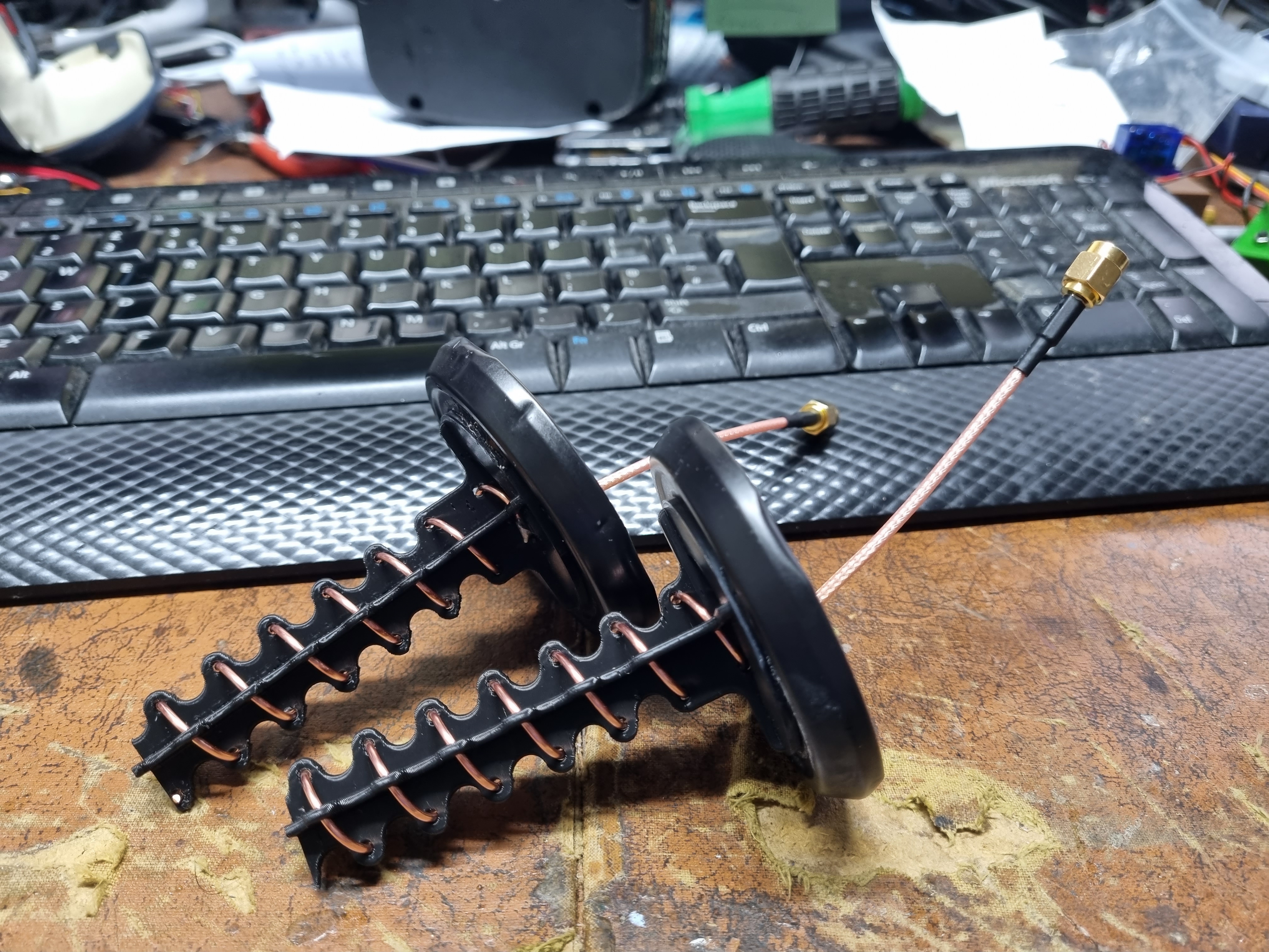

Now these look impressive Richard! Youll have to let up know how you get on with them. Do you know the coverage angle? Im guessing theyre very directional?
