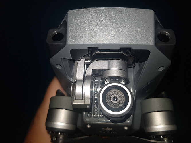

I was looking at my MP in the bright sunshine we’re enjoying, and I think something’s “bent”.
The black mounting plate above the gimbal seems to be at an angle relative to both the MP body and the camera mount. (Yellow lines.)
Can anyone tell me if theirs is like mine, or are all three parallel?

Here’s a different view that shows what I’m thinking isn’t quite right.
The MP was powered up on a surface I’d checked was absolutely level.
Mine looks fairly straight to me.
Think your right about yours, well spotted.

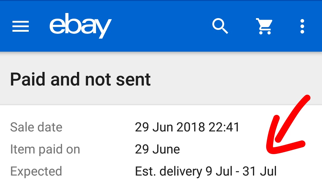

Edit: Part ordered.
Post Edit, Edit : I want it NOW!
I had a small crash with my Mavic and i think the gimbal area took a hit, it looks similar to yours from front on, but not as bad (from memory…) I will have a proper look tonight but i will be keeping an eye on this as there is a chance i may need to do the same thing!
OK - I’ll do a post on the exercise when I get to do it.
It’s another 3+ weeks until the part I ordered arrives.

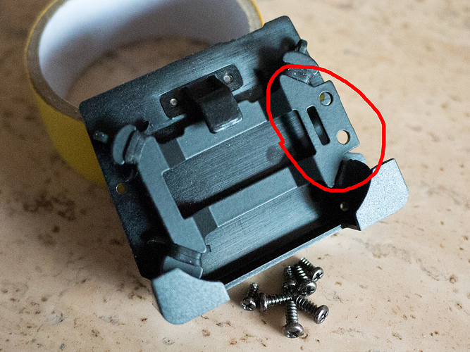

I’ve got as far as opening the packet, and watching several YouTube vids … and next week I’ll attack things. (Busy this weekend @ Goodwood Festival of Speed … without my MP!
Not certain how this will all go. Not because I’m crap at taking things apart - I’m brilliant at it … and almost as good at putting things back together.
The issue is that bracket (ringed) with the two screw holes. It’s through those screw holes that the screws go to attach the whole gimbal, and it’s that part that I thought may be bent, causing the slightly off gimbal angle.
That plate is plastic … which means (a) it won’t have bent originally (probably) … and so (b) won’t bend back (without breaking).
It also means the replacement parts (probably) won’t solve the issue.
So, still not sure if I’ll be able to correct that slant - but I’ll be taking everything apart, next week, to check which theory is correct - the one I had before I looked closely at the new parts, or my new one.
#TimeWillTell
It could just be aluminium (hopefully!), and is bent. The black finish means there’s no touch feedback to say if it is.
Even tapping it doesn’t help - the dampers manage to damp any metallic sound if there is any.
