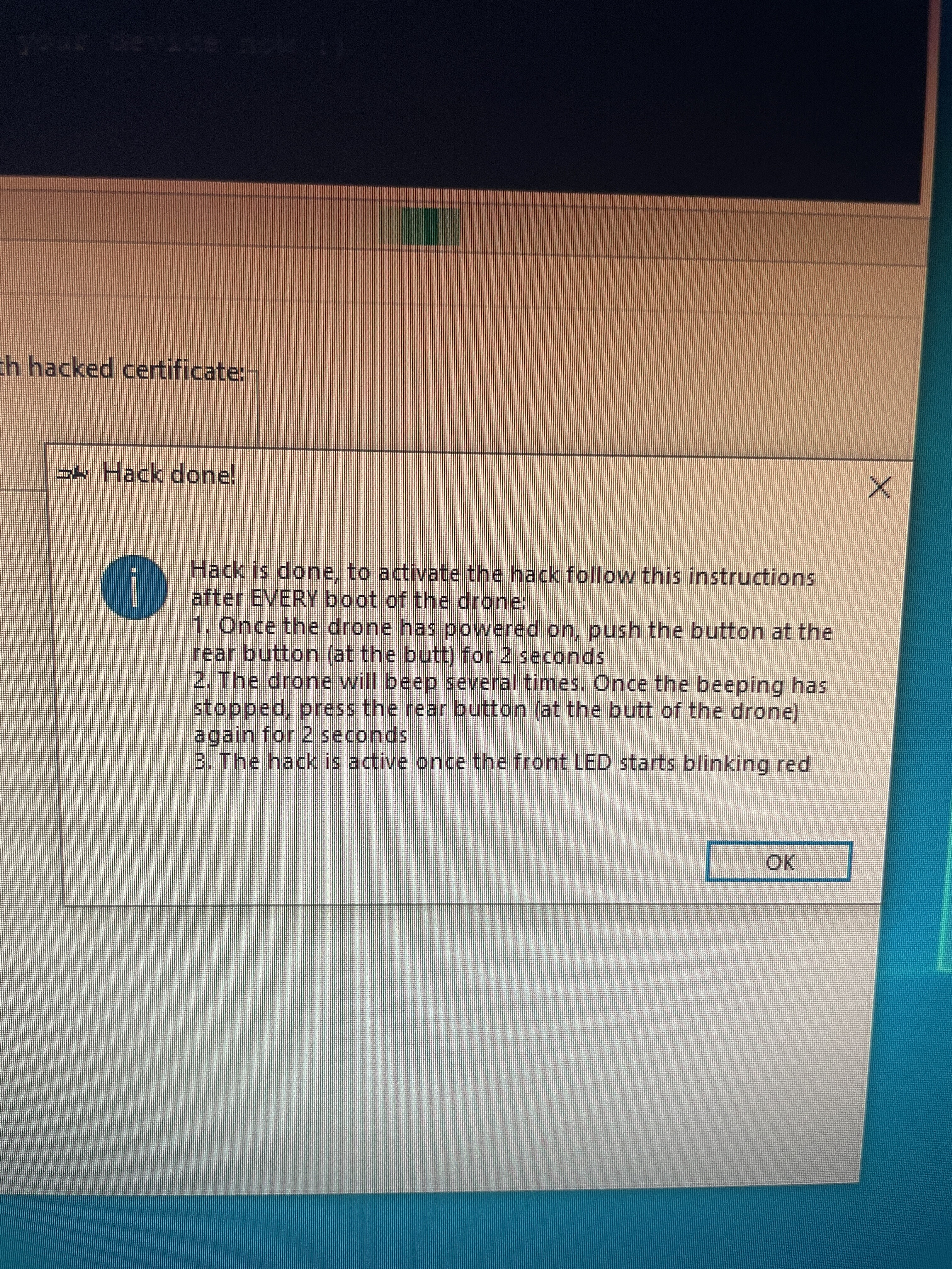

I thought all firmware’s on the Mini 2 were reversible on drone hacks ?
Not reversible but hackable
I can’t roll back, DH reports antirollback=2.
I can apply all the hacks and they work as they should but fcc is not permanent, even when hacking through desktop. Just a theory but i think everytime dji logs me out of my account and forcing me to log back in, the hack is being disabled? I also have litchi so I guess it’s time to ditch the dji app completely
Like Chris says above on the Mini 2 its the button press method
My advice would be to update to the latest firmware (DH recommends 01.07.0200)
Apply the Hack and remember to enable FCC whilst in the DH software
Update the DJI fly app to the latest version (it’s far more stable than the older ones) you can always downgrade later if you like ![]()
Test it, but remember to use the button trick on power up
Well, I guess my theory was completely wrong and I should have RTFM!!! ![]()
