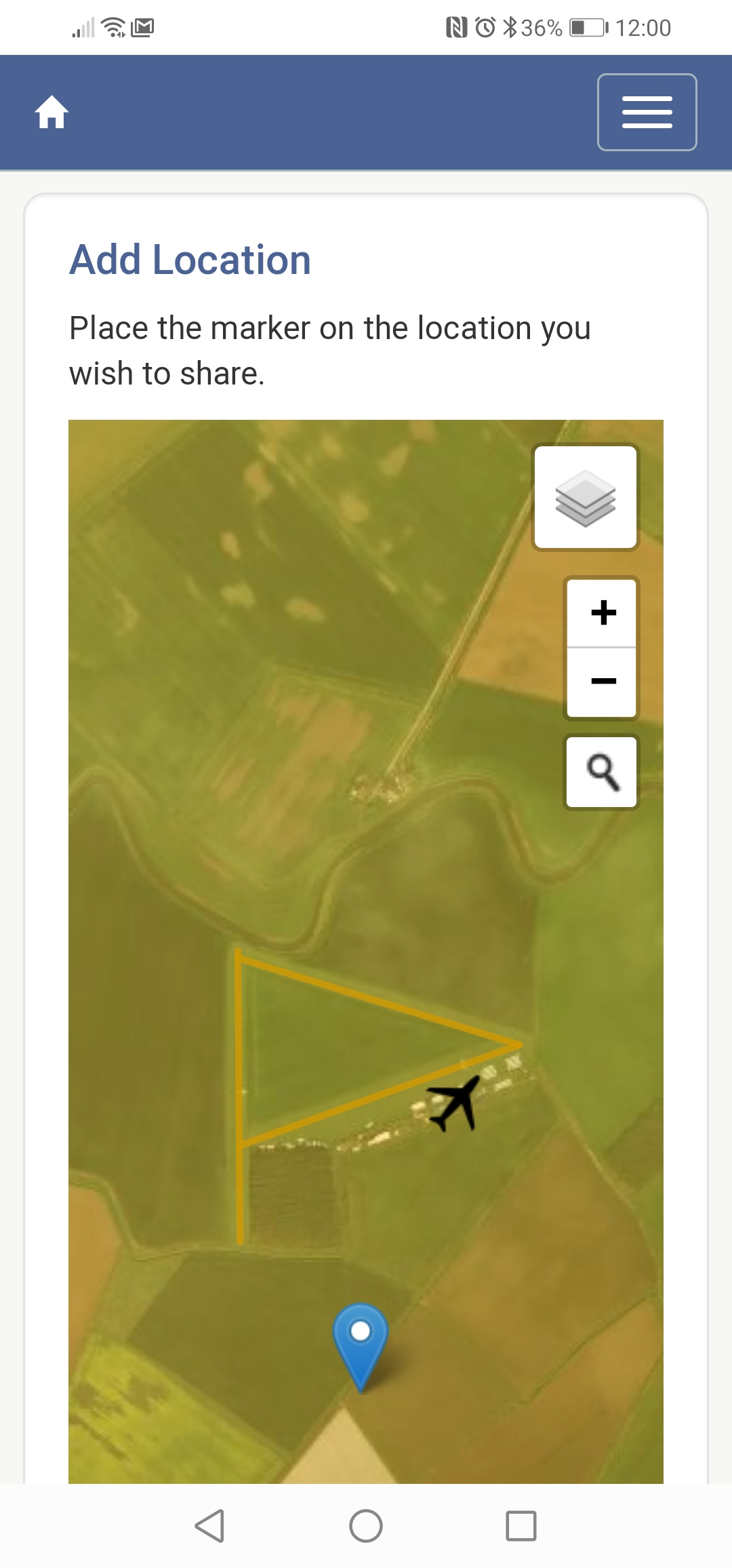

Take a look ar our own Dronescene map
There are various layers you can switch on or off. The one that concerned you here is the DJI layer. There are flight restriction zones around airfields and other sensitive places. DJI prevent you from flying in those areas without prior permission but they are overly cautious with the area they prohibit.
Class D airspace isn’t normally a problem as it normally starts higher than surface level, most times higher than 500 feet so if you are obeying the drone code you are ok to fly.

Going by Dronescene map it’s a red area I was in. In fact I was in the darker red area.
I won’t fly anywhere with out looking at that now!
It was just a large open field in an estate with woods to one side. Unknown to me it’s a flight path for the airport 2 miles away.
Easily done
sometimes they can be as small as an airstrip on a feild.

One not far from me. Not many people know its there but it is rather busy with microlights and small aircrafts.
